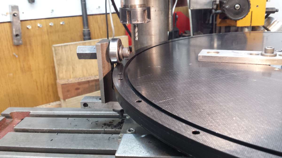

            This was my setup for cutting an O-ring groove near the periphery of a 50cm dimeter disk of 12mm thick acetal (Delrin). The rotary table is a modified VW front wheel hub fitted with a 250mm diameter ali plate, its free turning and has no indexing or worm drive. I machined the top surface true with a fly cutter in the mill spindle and was able to mount the acetal disk as I had already cut a large central hole using a router. I naively thought the the O-ring groove would have an even depth but had forgotten that much plastic sheet sheet material is not manufactured truly parallel and its thickness varies over the raw sheet size.
            To get the groove depth correct over is circa 1.5m length I rigidly mounted a ball race to run on the acetal top surface and put a spring (strong!) loaded ballrace on the disk underside pressing upwards. Although 12mm thick the acetal has enough flex to stay in contact with the roller.
            No real limit to the diameter one can machine if the mill is fastened to one end of a bench the R/T could be fastened to the other. The setup becomes a vertical lathe with active tooling!
            Ian P
