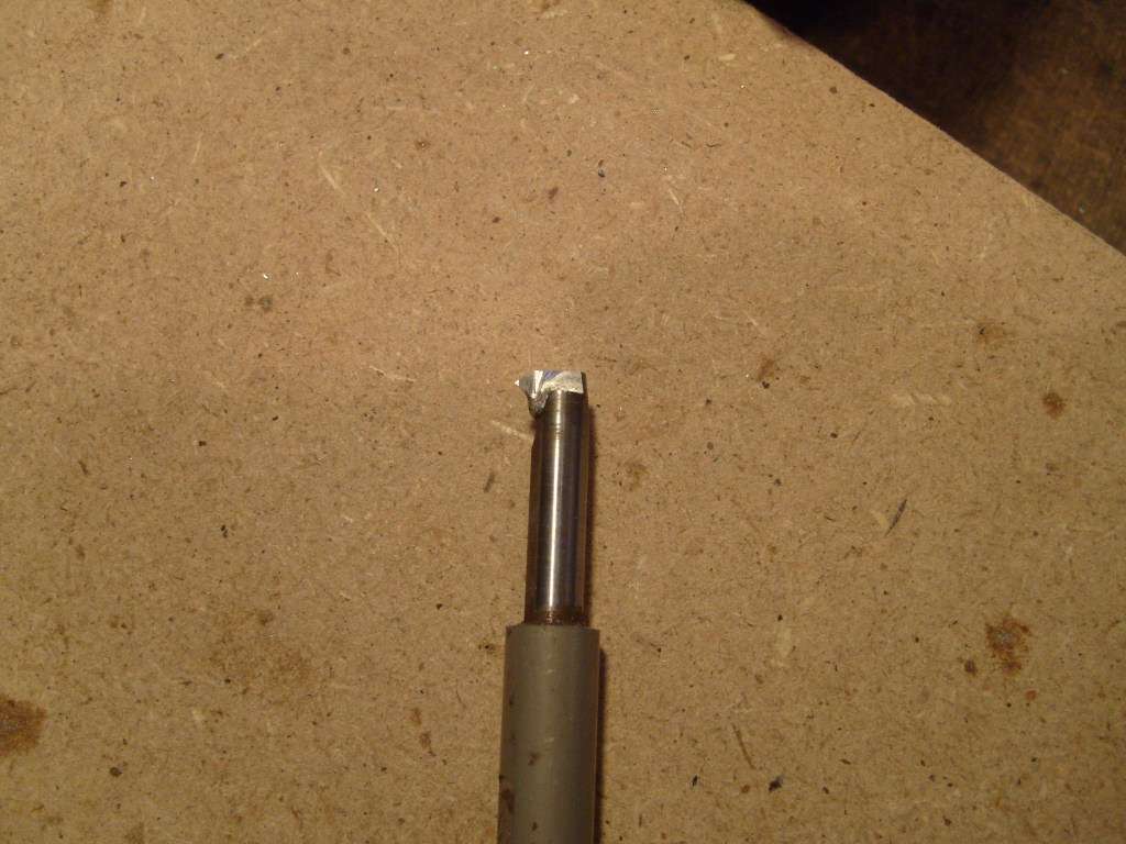

                            I just started thread milling on the CNC router.  I use FreeCad where you can select an internal or external thread size and it shows the min and max diameter that can be used to mill the inner or outer to the appropriate size.
                            I made a few thread mills using a steel bar and soft soldered a HSS tool bit on the end. Ground the tip to the required 60° (metric) and it works pretty well.
                            A lathe inner threading tool holder SNR0010K11 holds an IR11 insert. The tool holder shaft is 10 mm in diameter and can be shortened to fit the CNC. The minimal bore diameter should be 13 mm. I measured the “center height” and found it to be 0.05 mm (0.002″) of center. That is more than adequate to mill decent threads.
                            For really small threads, you can grind a steel nail ( 2 mm shaft, 4 mm head), one of the projects on my list.
                            Chinese web shops sell thread mills for a few €. These are good enough to try thread milling.
