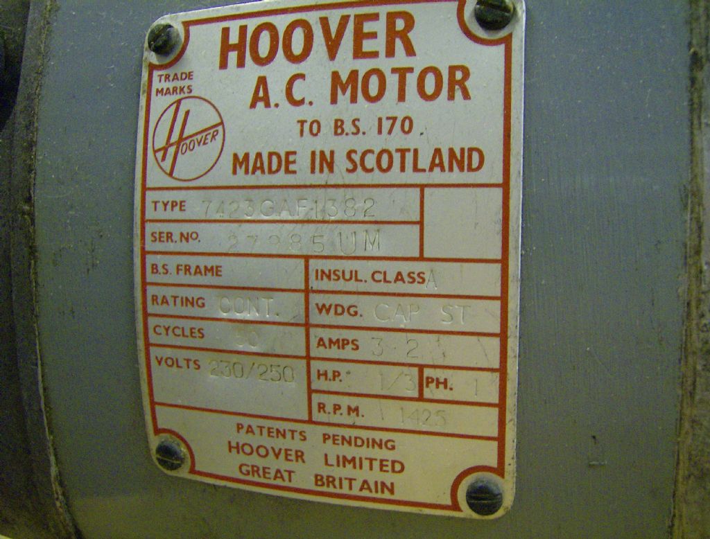

          Sub Mandrel
            @submandrel
            I have a Hoover fractional and it's lovely. The wiring is intact, but I'm going to replace it with PVC covered wire soon.
            I agree the quality is exception. plus it will work hard for agesw without getting more than warm.
            Info plate of hoover motor

                                    ALAN EARL
                                      @alanearl64921
                                      JUST NOTICED THIS ON MOTORS DOES ANYONE KNOW HOW TO REVERSE ONE OF THESE HOOVER SINGLE PHSE MOTORS MINE DOES NOT HAVE AN EXTERNAL CAPACITOR AND LOOKING INSIDE I WAS UNABLE TO IDENTIFEY WHICH WIRES TO CHANGE OR IF IT CAN BE REVERSED A.EARL
                                      #170675
                                      norman valentine
                                        @normanvalentine78682
                                        Alan, I am not an expert, so can't be relied on but I have one of those lovely Hoover motors. I wanted to fit it on a machine that needed to run in either direction. I identified the pairs of wires that fed each coil and after that it was quite easy following one of the diagrams in Tubal Cains "Model Engineers Handbook". I have to admit that I melted the capacitor at the first attempt but now it works fine.
