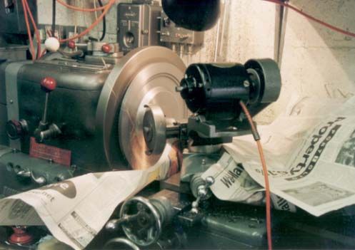

                  Just an observation – the commercial toolpost grinder I have doesn’t have a forward / reverse switch on it  – even though originally it came with an internal and external wheel head (internal one’s missing – something to make up one day . . !).
                  May I should fit one .  .
                  w.

                          Seem to remember the bolt holding the spindle drive pulley is reversed thread, the one on the grinding wheel is  normal.
                          I shall leave as is . .
                          Incidently, I only used it once to skim off a flywheel  -see below  – looking at the switch on the lathe, I reckon it was going clockwise . .
                          W.
                          Edited By WALLACE on 29/10/2010 14:20:01
