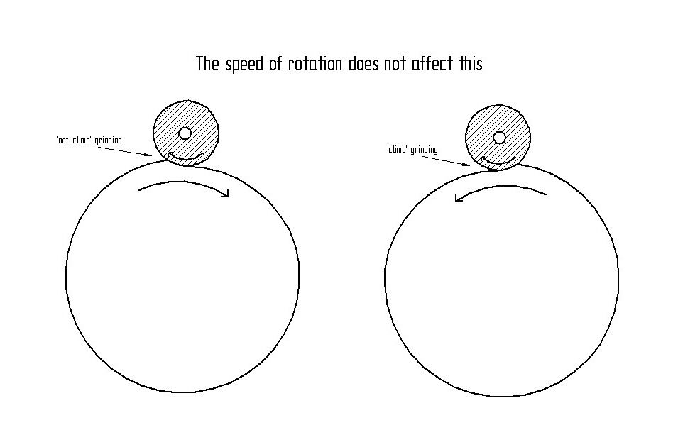

      I think the reason for the grinding wheel and surface of the workpiece to be moving in opposite relative directions to one another is similar to the reason why climb milling isn’t recommended in all circumstances.
      If the points of contact of both the workpiece and the grinding wheel are moving in the same direction, albeit at different speeds, then you are in effect ‘climb grinding’, which has the dual action of driving and pulling the job, deeper into the cut. If there is any lack of rigidity within the system then a poor finish is more likely.
      Martin.

              I can tell you what I know to be important when it comes to precision grinding and getting a good surface finish on materials such as cast iron and mild steel, as can be found on machine tools – so we’re talking components like cross slides and spindles etc.
              Obviously use the right type of wheel for the material being worked, which usually means silicon carbide for cast iron and aluminium oxide for steel. Use a wheel of correctly sized grit and openness, as well as the right degree of hardness for the job in hand.
              In my experience, most people don’t do much of the above unless they have to and just use what’s already fitted on the machine, but still get acceptable results provided they aren’t doing long job runs.
              The next thing is to true the wheel to make it round, followed by dressing, to create the right surface texture. It is vital to dress the wheel properly, but unfortunately many folks make the mistake of passing the diamond across the cutting face of the wheel far too slowly. This has the effect of blunting the wheel and leaving it useless for its intended purpose. Evidence of this can be seen by the presence of any or all of the following:- Burning, judder marks and a burnished finish on the job.
              Running the wheel too fast and/or the worpiece too slow, has the effect of making the wheel act harder and prone to blunting, in the same way a milling cutter will blunt quickly if spun too fast. Similarly, if the wheel is run too slowly or the workpiece too fast, the grit will be torn from the wheel because the chip load per tooth (per grit) is too high and results in a wheel which won’t hold its size, but will cut like a demon as fresh new grit is constantly being exposed.
              The art is in getting the right balance between all the above factors so that new grit is exposed as the old grit is torn away as it becomes blunt, ie. chip load increases to the point where the wheel breaks down and so self-sharpens.
              If you accept any of this, then far from being a red herring, you can see that the direction of rotation of the workpiece, as well as its speed in relation to the wheel is important, as it is linked to the wheel-speed/work-speed ratio.
              Martin.

                    I have to disagree with you about the wheel only seeing the work (move) in one direction though, because if you look at the wheel/work rotation relationship again, you’ll see it can’t be true.
                    With the wheel spinning at any constant speed and direction and then presented to the outer periphery of a workpiece spinning in the same direction as the wheel, the chip will begin life at zero thickness and by the time it severs from the job will be equal in thickness to the cutting depth of the wheel.
                    If you now reverse the direction of rotation of the workpiece only, then the chip thickness starts equal to wheel cutting depth and ends at zero thickness. These examples are fully equivalent to conventional milling and climb milling respectively.

                      Even though it wasn’t me that said it originally, I can sort-of see what Nick Farr is getting at – although I think that you’d have to be pretty unlucky to have a wheel going at an exact synchronous multiple of the work rotation speed and worn badly enough to do this – I think you’d probably notice!
                      And yes, a moment’s thought says that Martin is quite correct about the climb milling – if this wasn’t a round surface that the grinding wheel comes into contact with, but a flat one then it’s just the same as running a surface grinder in one direction over a job rather than the other one – but isn’t that pretty much what happens on a surface grinder anyway? You pass the wheel forwards and then back again? If mine was actually running, I’d attempt to find out whether there was any noticeable difference, although I rather suspect that if there was, I’d need a microscope to see it.

                                Posted by chris stephens on 27/10/2010 02:07:12:
                                 Contemplate if you will on the relative speeds of the stone to a forward and backward work piece and, come to think of it, a stationary one as well. Provided the stone has a surface speed faster than the surface speed of the work, it will only see the work in one direction, as they said in my Maths class QED.
                                I’m sorry Chris, but that’s not quite correct; the issue is not about speed. In one direction the wheel will be travelling into an uncut area with an upward motion, and in the other direction it will be travelling with a downward one. If what you are saying was true, then the concept of climb milling wouldn’t exist – but it does, and it’s real. QE really D!

                                      Chris, could you try to imagine what it is that Martin and I are on about? I can assure you that it’s true… and it’s not a speed issue.
                                      #57613
                                      Steve Garnett
                                        @stevegarnett62550
                                        In an attempt to make it easier to see what it is we are on about….

                                          If the analogy is to milling (conventional vs climb) aren’t the labels reversed on the diagram?
                                          #57620
                                          Steve Garnett
                                            @stevegarnett62550
                                            Er, yes… whoops! I’ll redo that bit. Doesn’t alter the principle, though.
                                            This has screwed the thread up slightly, but I think it’s still clear enough; only the correctly-labelled version is now visible.

                                                I should point out that I do not know what difference it makes (apart from where all the dust flies), although the effect will surely be small. The contact angle will be very slight, and if the work and the grinder are both rigidly mounted, then presumably you wouldn’t get the problems you get with climb milling anyway. I had a look at several other sites where people talk about which way they do this, and there seem to be an equal number in both camps. And I have a completely open mind about it…

                                                    Nick, they have been reversed in the only version currently in the thread.

                                                      Steve, thanks for the diagram, comfirms what you’ve been saying.
                                                      If the work is held between centres then you will have to ‘not climb grind’? Am I right?
                                                      Maybe way back this is where the need for the grinding wheel and work surfaces moving in opposite directions originated, I would imagine in days gone that working between centres would be more common.
                                                      I have always shayed away from trying toolpost grinding but I have learnt so much from this thread I will be giving it ago. I have a Sherline headstock with variable speed upto 10,000 rpm, I am thinking that I should be able to set up a fairly ridged arrangement on my 6″ centre lathe and use the variable speed to get the right periferal speed for the grinding wheel diameter. Would not be suitable for using grinding points though, higher rpm would be needed.
