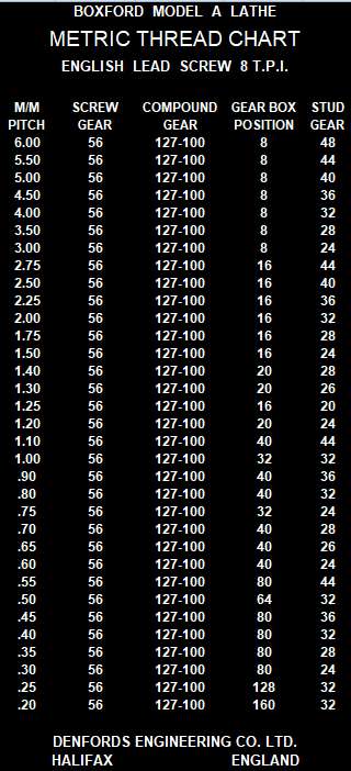

      I know this has been covered a thousand times, but I still haven’t managed to get my head around it, so I’m afraid I have to ask for your help. Mainly, it’s the involvement of a gearbox that’s throwing me.
      So, the lathe is a Fortis (=~ Clausing 100 MK3), 8tpi lead screw, with a gearbox like this:
      https://www.lathes.co.uk/fortis/img8.jpg
      Perhaps you could help me work through how I would set this lathe up to cut a 2mm pitch thread?
      I found this table for a different lathe, and understand that “gear box position” means I should set the gearbox lever and tumbler to cut 16tpi and add a translation 127/100 pair in the train. I can’t even work out from the plate above how I would set the gearbox to cut 16tpi!

                          Thanks everyone, those have been the pushes I need to get it done
                          For posterity, how it made sense to me was – ignore actual gear train initially, just work with lead screw tpi and a 127/100 compound pair. I.e.
                          • Convert tpi to pitch (between teeth) in decimal inches
                          • Divide by ratio of translation gear (127/100)
                          • Multiply by 25.4
                          = metric pitch given by that translation
                          Here, with an 8tpi lead screw, we get:
                          ((1/8)/(127/100))*25.4 = 2.5mm pitch
                          So with sliding gear in, lever to B, front slider dogged to 1, and a 127/100 compound gear in the train, the lathe will cut a 2.5mm thread
                          Turning all this around, you have the equation that lets you see what tpi (lever/dog combination) you need to set the lathe to for it to cut a given metric pitch.
                          Worked through for a 0.7mm pitch:
                          1/((0.7/25.4)*(127/100)) = tpi needed =28.5 tpi
                          C8 is the nearest setting available (=0.714mm)
                          If I want to get closer to 0.7mm, I need to mess with the gear train – finding one that changes the gear ratio coming into the gearbox such that one of the gearbox ratios spits out “28.5tpi”
