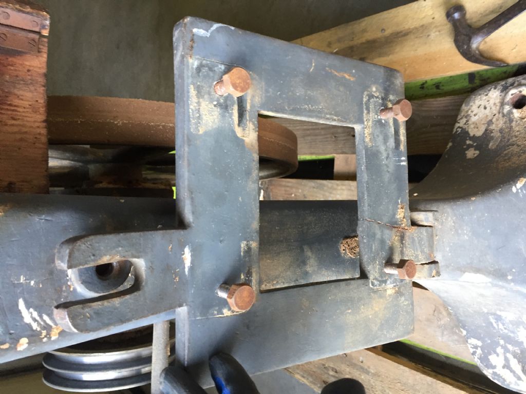

          #523842
          pgrbff
            @pgrbff
            Posted by Robert Dodds on 30/01/2021 20:13:32:
            pgrbff,
            Do you know how this 1/2" rod got "bent"?
            Your machine is unlikely to have more than 5 hp driving it and it is difficult to imagine that a motor of that size causing the damage. It would be more in keeping with an accidental collision with a fork truck or similar handling equipment
            Is the rod used as a belt tensioner?
            Unless you are constrained by having 1/2" tapped holes in the motor or machine frame consider substituting M12 studding with appropriate nuts for the present rod. At least you should source that in Italy.. As far as strength goes, M12 studding should have the capability to carry at least 2 tonne, more than the motor weight and any belt tensioning that is involved bu obviously , if other outside forces are involved some damage may result.
            I googled Antique bandsaws and the images that came up show a great variety of makers and sizes and some with the motor floor mounted rather than on the machine. Would this configuration help with your project?
            Hope this gives you some food for thought.
            Bob D
            The rod screws into the cast iron body so it would be easier to stay with 1/2".
            The image is of the motor mounting plate folded up, at the top you can see where the 4" rod is threaded into the body of the saw and regulates the position of the motor to tension the belts. The 4 bolts hold the motor on to the plate. The plate also has a crack which will have to be reapaired.
            There is no great strain on it, but obviously some vibration which I thought might damage the threads over time if I used poor quality mild steel threaded bar.

                    #523893
                    pgrbff
                      @pgrbff
                      Unfortunately, I no longer have access to a lathe and I am primarily a woodworker. If I could I would, promise.
                      #523901
                      Robert Dodds
                        @robertdodds43397
                        pgrbff,
                        Your motor mount picture clarifies the configuration quite a lot.
                        Have you still got the 1/2" rod? Seeing the type of motor mount you have I suspect that the bend in the rod is intentional to accommodate the curved movement of the adjusting lug as the motor and plate pivot on the hinge at the bottom.
                        It may well be a cheap compromise to avoid using an eye bolt and clevis that would, in an ideal world, enable the screwed rod to be held square to the face of the adjusting lug.
                        In service there is no way that the forces involved with tensioning the vee belts would over stress your 1/2" rod, unless of course, the threads are badly damaged to start with. With that proviso I suggest you do a trial assembly and stop worrying about high tensile rod replacements.

                          #523928
                          Tim Stevens
                            @timstevens64731
                            Once more, a problem which cannot be addressed properly as the information given is simply not there. Try to put yourself in the position of the person reading your request, and think 'Would I really understand this problem?'
                            If the rod you need attaches to the hole behind the slot in your second picture, and the plate pivots around the bottom hinge, it seem inevitable that any rod, whatever it was made of, would have to be bent – or no adjustment would be possible.
                            And I wonder about the use of a 'heavy three phase motor' on a device which looks – well – almost delicate. Especially the single hinge which has to cope with the weight, and the belt tension, and with a plate which is already well out of line…
                            Not the news you want to hear, perhaps.
                            Regards, Tim

                                #523947
                                Tim Stevens
                                  @timstevens64731
                                  A further thought has occurred to me:
                                  In use, the tension of the belt would pull the motor towards the column. [Unless I have totally misunderstood the photo.]
                                  This means that the 'tensioning' bolt needs to push outwards, as any real load on the machine would otherwise loosen the drive belt. In which case, the bolt is really loaded in compression, and tensile loads are only relevant when the motor is not in use and the belt is off.
                                  Or not – can the original poster please explain?
                                  Tim

                                      #523958
                                      pgrbff
                                        @pgrbff
                                        Thank you all.
                                        As with so many threads, this one seems to have taken on a life of its own and no longer relates to the original question, which was simply to determine if it was possible that an Italian machine manufactured approximately, and here I'm only guessing, 50-70 years ago could have imperial threads'#.
                                        Having determined it may be imperial I simply thought buying a high tensile bolt or threaded bar from an engineering or quality fixings supplier rather than a mild steel threaded bar from everyone's favourite auction site would hopefully ensure a better quality product. It was not intended to discuss whether HT rod was strictly necessary.
                                        As I have to have it posted to Italy the difference in the price of the fixing would be small in relation to the cost of posting it to Italy, especially after Brexit.
                                        Thank you all again.
                                        Edited By pgrbff on 31/01/2021 16:19:01
                                        #524121
                                        Howard Lewis
                                          @howardlewis46836
                                          Looking again at the picture of the motor mounting plate, these thoughts come to mind.
                                          1 ) It looks as if the motor tensions the belt by swinging outwards, so that any adjuster would be under compression.
                                          Having said that, the compressive load needed to bend a 1/2" BSW thread would be likely to bend shafts, ruin bearings, if the belt did not fail prematurely.
                                          2 ) Since the adjuster engages in a slot , the angular position of the motor mounting plate will tend to exert a bending moment on the thread, but only if a nut was fitted on each side of the slot.
                                          maybe the way to avoid such problems in the future would be to hinge the adjuster thread to a mounting point screwed into the main body. A clevis end on the adjuster pivoting on an eye in the main body would suffice.
                                          Departing from prototype, and presumably being in Italy, the obvious choice would be some M12 studding as raw material
                                          Howard
