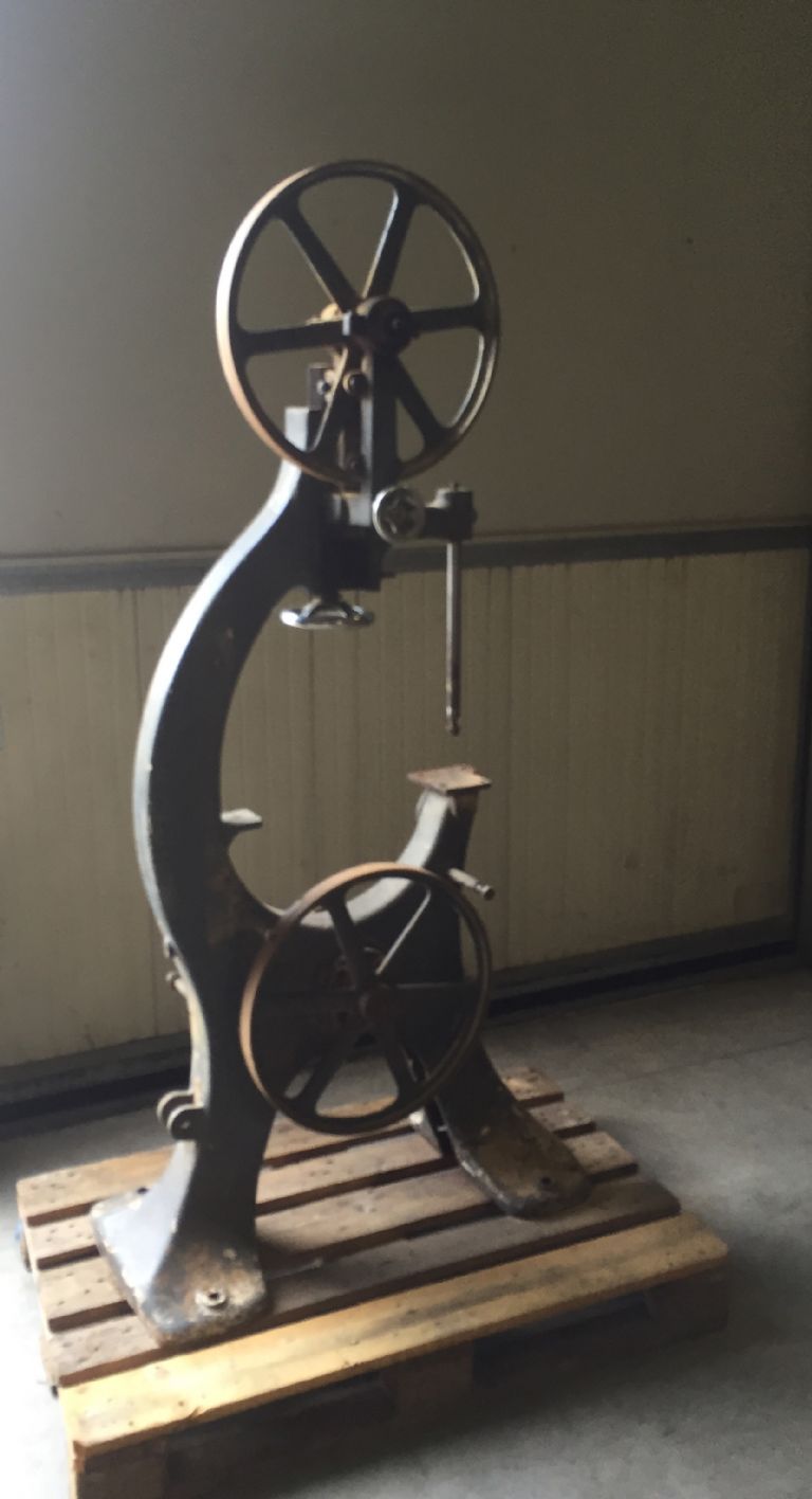

      I need to replace a piece of threaded rod on an Italian bandsaw probably mid 20th century. The rod measures 12.46mm diameter and when I put a metric thread gauge on it it comes out somewhere between 2 and 2.5. If I put a whitworth 55 gauge on it the 12G fits.
      i know nothing about thread sizes and have no idea where to start. The piece of threaded rod is used as an adjustement point for the motor.

          That is a half inch 12tpi Whitworth thread. Google Whitworth threads for a table of all sizes. You can find 1/2" W studding on your favourite auction site – and probably others as well.

            Is it possible that a large Italian engineering company used Whitworth threads on their machines?

              Possibly, but more likely that part has been replaced previously? Or it’s not actually an Italian machine?🙂

                Definitely an Italian machine, still in Italy too. I feel it is unlikely to have been replaced here in Italy, finding 1/2" would be impossible unless you were a big manufacturer.
                I have been trying to find some high tensile 1/2 threaded bar in the UK and I haven't found any yet. It has rather a large 3 phase motor hanging off it and has bent. I don't think mild steel would last long.

                  Quite possible – mid 20th century would have been just after WW2, and with material in short supply there would have been a lot of US and UK war surplus available.

                    I'm guessing at the mid century.

                      Not likely, but not impossible either. Possibly the band-saw was made for export to the UK or made to a British design.
                      Or it's been repaired in the past by someone who had Whitworth to hand. For adjusting a motor 1/2" Whitworth, M12 and 1/2" UN are all similar.

                          Having seen the photo, which century?
                          smiley
                          That's a classic Victorian design. They might still be making them!

                              Did they have 3 phase motors back then?

                                              Though the first one appeared in 1890 a 3-phase motor makes it 20th century!

                                                I think it was the guy selling me the saw manhandling it into the back of his van that bent it, not the weight of the motor.
