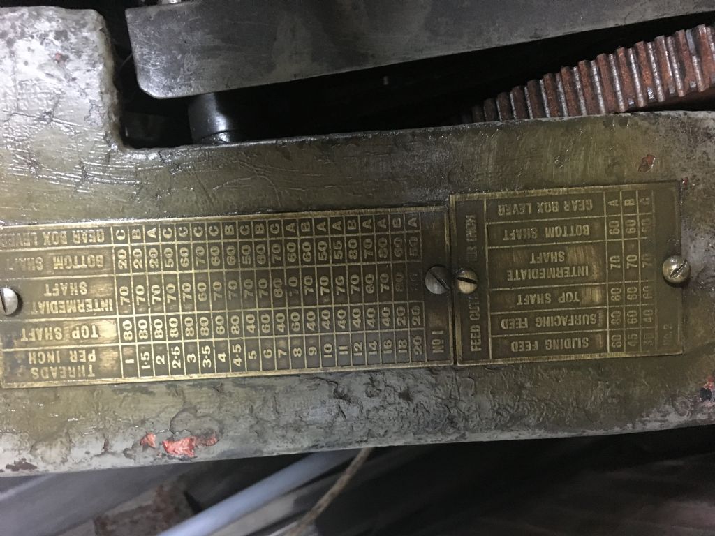

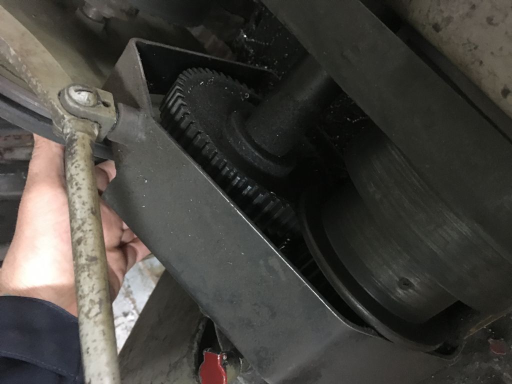

          The top gear in photo two is probably rotating at the same rate as the spindle. Check this by rotating the spindle by hand.
          Also it looks like that gear is 25 tooth which would be a common value.
          Also you have a partial gearbox with settings ABC. You can check what each setting gives as a reduction ratio. Probably one is 1:1, so what are the others?
          Now your leadscrew is 4 tpi so each full turn gives you about 6mm pitch. But you want 1.5mm so roughly you want a 4:1 reduction between the spindle and leadscrew. This is a rough sanity check.
          The actual gears (if your little gearbox is set to 1:1) are 25:50:60:127. That is 25/50 X 60/127 which is roughly 1/4 or a four to one reduction. The 50 and 60 are on the intermediate stud.

                First thing to do is check the ratio between the headstock spindle and that first gear sticking way out there. It SHOULD be 1:1, but who knows for sure unless it is checked?
                Also, check to see if that round knob sticking out the front of the headstock in that same area is a tumbler reverse mechanism, ie does it reverse the direction of rotation of that first gear when the knob is moved?

                  The knob on the front near the gears turns the lead screw into forward or reverse, the other gear that is at the top with the lever folds up and that stops the chuck from turning

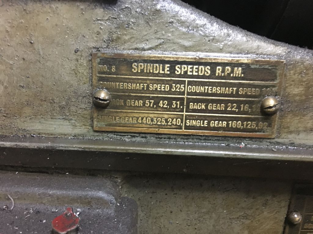

                      … the other gear that is at the top with the lever folds up and that stops the chuck from turning
                      That will be your back gear. It is used to slow the headstock spindle down for screw cutting. There will be a pin or dog of some sort that disengages the belt pulley unit from the spindle so the gearing is reduced through that gear with the lever on it when engaged.

                                  OK. that is right handy. We can deduce from this chart that the top gear's shaft rotates at 1:1 with the headstock, because the gearing for 4tpi with a 4tpi leadscrew is 60-idler-60, ie 1:1. Presuming that C is 1:1 also.
                                  To cut an 8tpi thread you use the same gears but put lever in position A. We can deduce that position A therefore doubles the ratio to the leadscrew.
                                  Position B appears to increase the leadscrew rotation by a factor of 1.5, as in the 6tpi setting where the gears used create a 1:1 ratio the the lever increases that to 1:1.5.
                                  So I guess you would leave it in position C for metric screw cutting. ie 1:1 and use the gear train for ratios.
                                  But I may be wrong so you need to check it out in acutallity by rotating the large gear at the bottom one revolution and noting how many turns the leadscrew actually turns. Ditto the headstock spindle and first gear, just to make sure they are 1:1.

                                                  From the right hand end of the table (left in upside down picture) we see the first three rows have the same gear configuration but the lever is set to C,B,A. which clearly gives you those ratios.
                                                  Interesting that it is designed for 1tpi to 20 tpi. Big stuff only none of that tiddley stuff model engineers do and cleverly minimises the number of loose gears it needs.
                                                  So the lathe originally only had 20, 40, 50, 55, 60, 60 again, 70, 80. 30 wasn't needed. Also it always used the intermediate gear as an idler so no need for a compound arrangement in the middle.
                                                  To allow for the gears you (should) have the train is now 20/40, 60/127 using the 40 and 60 linked together on a new intermediate stud for a compound pair ( which you would have to make) and the gearbox in the 1:1 position. However luckily for you you can get the 1:2 ratio provided by the 20/40 from the position C of the gearbox.
                                                  So the final configuration is 60 on top shaft, anything on the intermediate stud, 127 on the input to the gearbox, gearbox position C.
