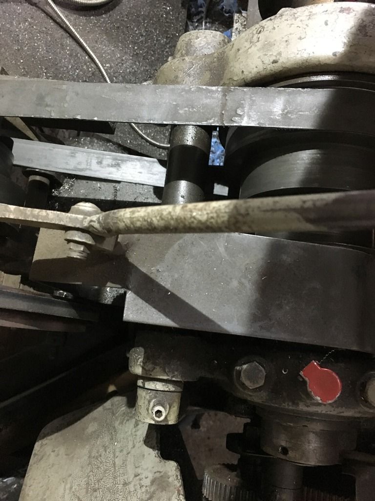

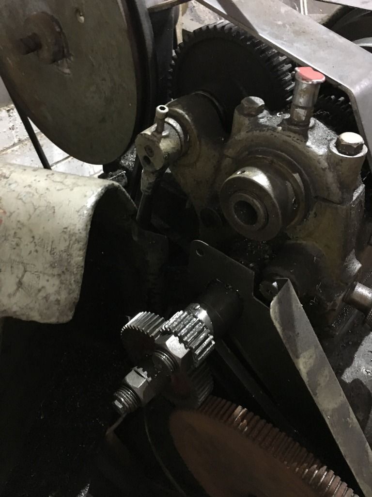

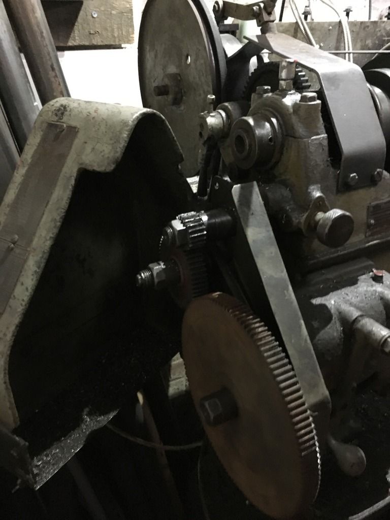

      hello folks i have a harrison l2 imperial lathe and i need to cut a M18x1.5 left handed threads, i have a box of change gears.
      What would you suggest for cutting this thread please.

          Chris,
          There will almost certainly be a gear combination which will basically convert your lathe from tpi to metric pitch. It may well involve a 127 tooth gear, but may be other very close conversion ratios. You will then need to thread without the use of the thread dial as that will be inappropriate. The usual is to reverse the lathe for returning the carriage, after a cut, in order to keep the cuts superimposed.

                          Martin Cleeve's book Screwcutting in the Lathe has charts on pages 54-55 for cutting metric threads using standard changegears on an Imperial lathe without needing the 127T gear. Not sure what tpi your leadscrew is but he suggests for 1.5mm pitch with 8tpi leadscrew to use gears 40- 60/50 – 65/35 – 38. This gives an accuracy of 1 in 4,446 which should be close enough for the average home shop!
                          He does tell you how to calculate it yourself, but don't ask me to explain it.

                                So back to the OP, what gears does he need to use on his Harrison L2 to cut a 1.5mm pitch LH thread.
                                He says in a subsequent post that he has a 50T and 127T gears in his box of stuff.
                                Anyone?
                                Does someone have a threading chart for that lathe? Know if there is a tumbler reversing mechanism on that lathe?
                                Barring that, if the OP shares with us the TPI of the Harrison's lead screw and posts a pic of the change gear stud area of his lathe, the resident experts should be able to calculate the gear train required.

                                                  There are 4tpi on the lead screw
