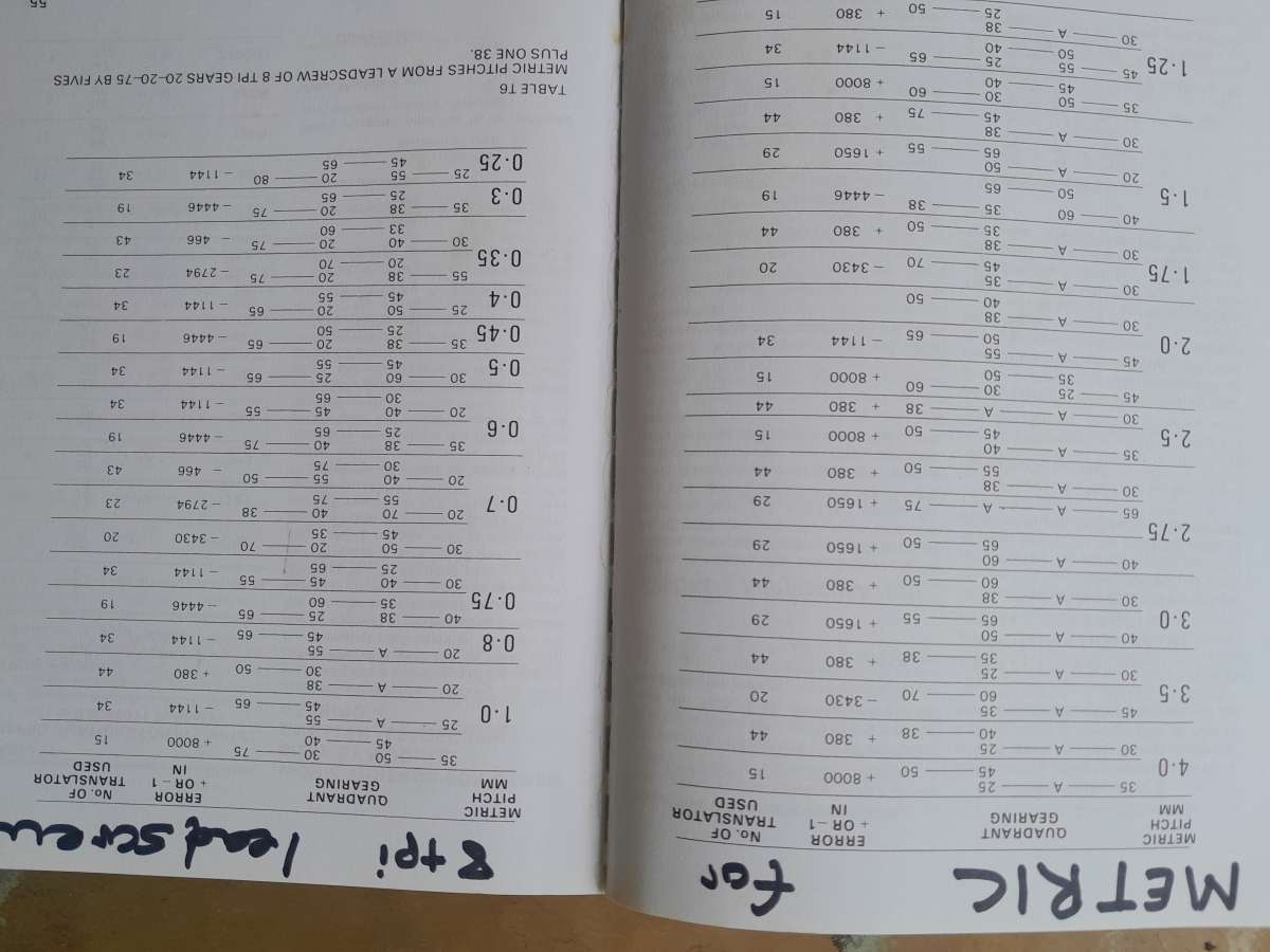

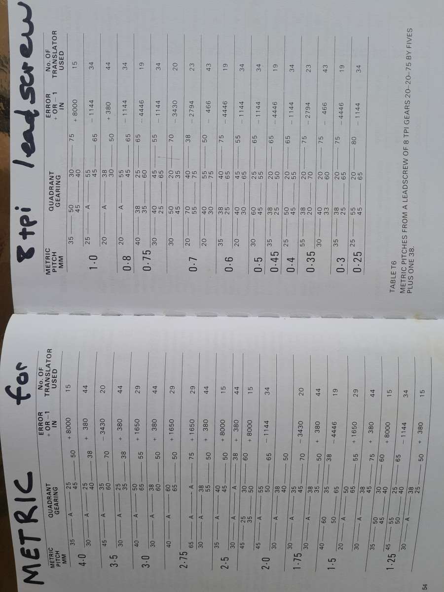

        If you have a set of standard Myford imperial change gears, you can cut all metric threads using the chart below.
        Accuracy, as shown, is generally in the range of + or – 1 in 1000 to 8000. That is one thou per inch to 8 inches. More  precise than your leadscrew.
        Ignore the final column headed No. Of Translator Used. It refers to the mathematical calculations, not to any gear. Just follow the gear train in the main body of the chart.

                halfnut – your chart hasn’t embedded. probably only accepts JPEG pictures. It may be showing on your computer as it is a local link.
                #793613
                halfnut
                  @halfnut
                  It was a photo taken on my phone so should be Jpg. I will try again.
                  20250416_08461220250416_085409
