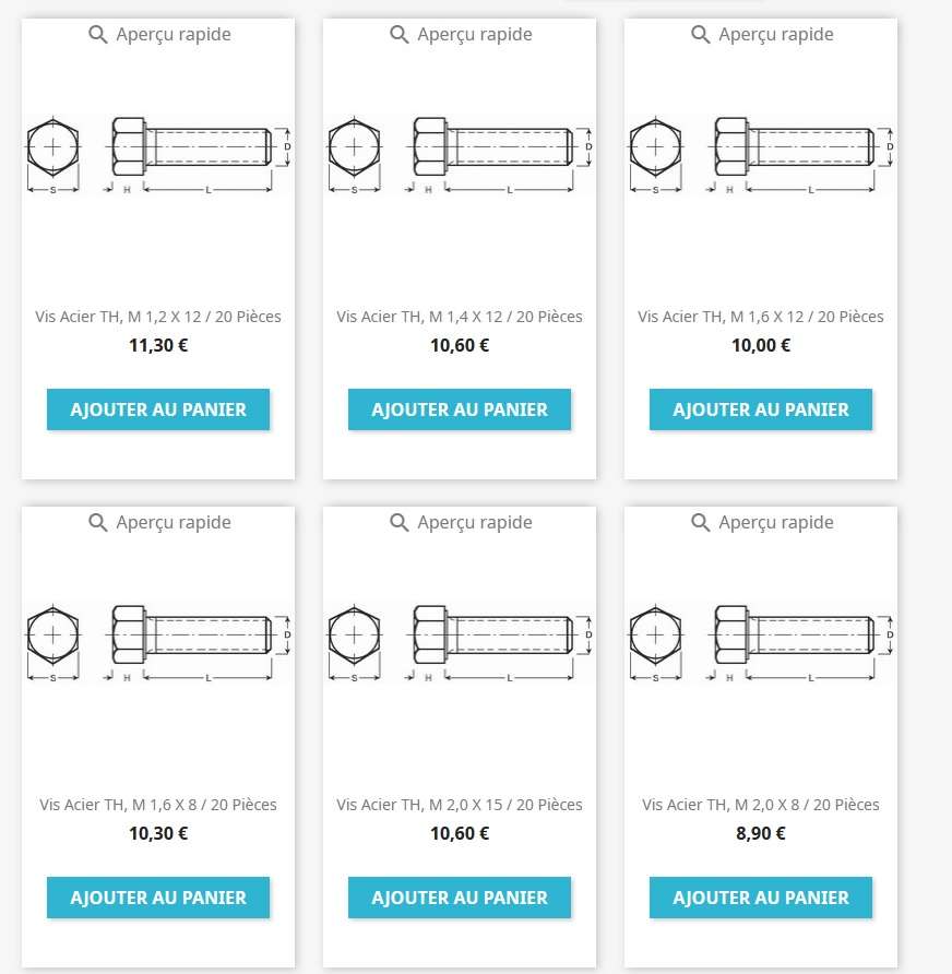

                                    The French site that I usually offer up in answer to this question also appears to have been taken over, and the home page says it’s in the process of regeneration, but still gives useful links to their extensive catalogue.  For example, their special screws page starts at the smaller end of the range with these:
                                    Small hex screws
                                    https://www.metivier-modelisme.com/598-vis-tete-6-pans
                                    These, as you can see, are in steel, but they also do a selection in stainless steel and fewer in brass.  When I first clicked on the home page, Google Translate came up and offered an English version if your French is not up to scratch.  They ain’t cheap, are they? Although the heads seem to be smaller than the average offering.
