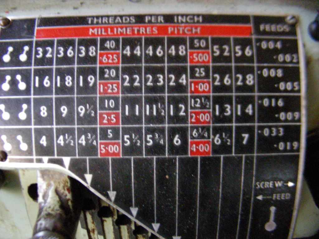

          Posted by DC31k on 04/11/2021 15:03:01:
          How many imperial threading charts do we see that include 6 1/2 tpi or 15tpi or 9 1/2 tpi?
          Here is the gearbox chart from my Willson slantbed which offers both 6 1/2 and 9 1/2 TPI. Some of the metric pitches are non-standard, too.
          Incidentally, the lathe has an interesting change gear arrangement using a 125/127T pair with the same OD thus permitting rapid changes between metric and English. The system is covered in detail on lathes.co.uk.
          #569954
          Pete Rimmer
            @peterimmer30576
            9 1/2 qnd 6 1/2 are only there because they are half of 19 and 13. It's either have them on the gear chart or have a space.
            There are 9.5tpi threads but they are so uncommon you wouldn't deliberately add that pitch to a selection if it weren't for the above.

              Posted by Pete Rimmer on 05/11/2021 14:32:02:
              Of course, but I was responding to DC31k's (possibly rhetorical) question!
              I will pose one of my own: how many gearboxes provide standard pitches only?
              #569959
              Pete Rimmer
                @peterimmer30576
                Posted by ega on 05/11/2021 14:37:34:
                No idea, not many I expect.
                The HLV offers different imperial pitches depending if it's a UK or USA machine, and non-standards are incidental.
                Of course, screwcutting isn't the only reason for using the leadscrew. Spring winding or coil winding might use odd pitches. I used my lathe gearbox to wind a coil with the pitch set to the wire diameter.
