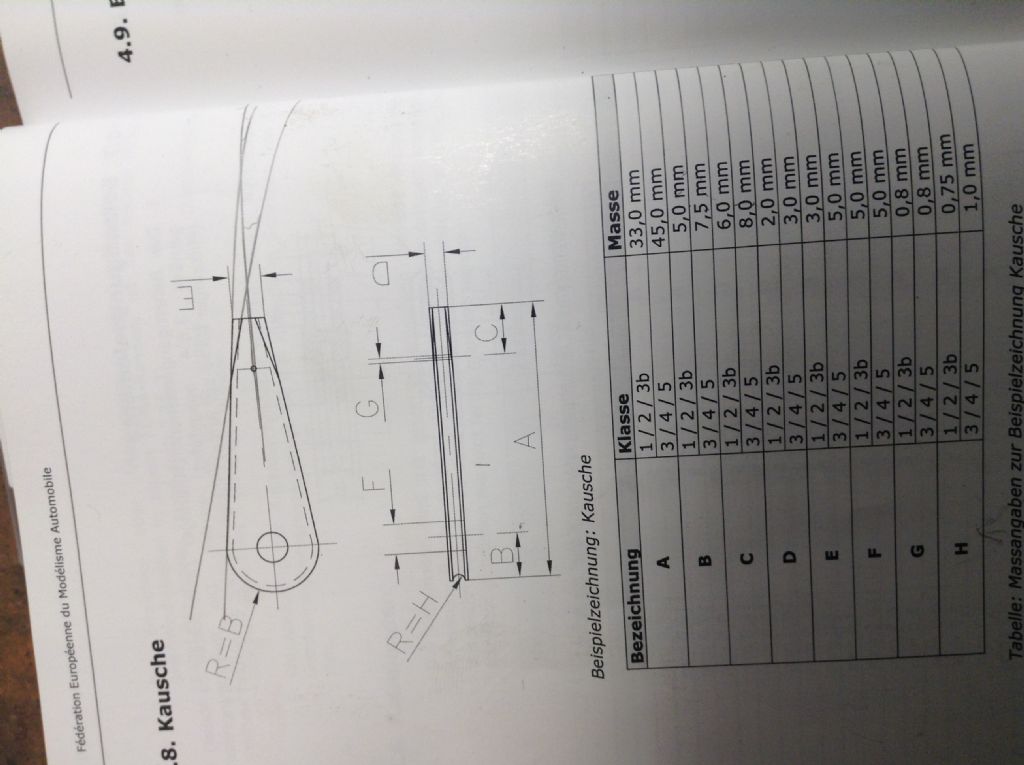

        Where can I buy metric sized flat brass bar I need the following two sizes.
        8mm x 2mm
        10mm x 3mm
        i need about 600mm of each.
        i have tried milling brass plate to size but it ends up bent.

              What size plate are you milling it out of? Should not be a problem if done from readily available 2mm and 3mm thick sheet as that only needs milling to width. If you are milling something thicker down particularly drawn hard brass then yes you will more than likely end up with bananas

                I had a similar problem to the OP. I ordered 4mm thick bar which turned out to be imperial and slightly too thick. I tried to thin it down and ended up with brass bananas. You've been given a source for 2 x 8mm and Jason has suggested cutting from 3mm sheet, but if you really must have metric flats, then you are probably going to have to order from Europe, I would have thought. Without wishing to labour the point, these suppliers will sell you 3mm x 10mm x 250mm brass flat at €4.60 per length and also do 2mm x 8mm x500mm at €5.30 per length. Plus P&P of course.

                  Jason
                  The plate was around 2.5mm thick which I machined down to 2mm the plate was from when I cleared my fathers workshop so it was for clockmaking.
                  I would quite happily use plate of the right thickness if I could find it.
                  Oliver
                  #448103
                    M-machine do 14swg which is only 0.03mm thicker than 2mm and actual 3mm sheet and should be able to cut a size to suit
                    The clockmaking brass was more than likely a hard brass so prone to distorting.

                          Just be aware that sheared sections will have deformed edges, if you need then crisp then cut wider and mill to width as it is generally playing with the thickness that causes distortion of plate and sheet.

                            one solution i have used when milling thin brass is to soft solder it to a bigger piece which wont deform in the vice. Solder paste is good for this job but not essential. When its milled simply hot the piece up and off it pops. Soft solder can be wiped off ur lightly sanded.

                              This what I am making, cutting the profile out on my cnc machine and putting the groove round the outside on my manual mill. Got quite a few to do both sizes.
