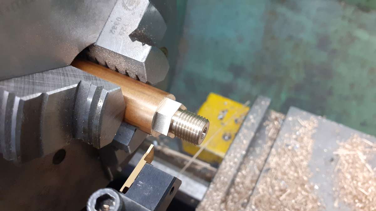

                        Howard, Bob’s problem is that many dies these days have the lead chamfer on both sides so turning them round won’t get the thread any closer to a shoulder. These are also quite often “gun nosed” where a second angle is ground onto the leading edges to drive the swarf forwards much like a spiral point tap does as the dies are often intended to be use din diestocks with the work rotating under power so no backing off to break the chips.
                        If it’s a part where I’m worried about stress rizers I have a 1mm half round (0.5mm Radius)parting insert that will do the relief with the minimum risk of stress spreading from an internal corner. However most of the time on a lightly loaded model a flat ended parting insert is OK. This M10 x 1 thread on a stuffing gland would be the sort of low stress part where the plain cut is OK. I would not do it on the end of say a crankshaft that may have the thread retaining a propellor or heavy flywheel.
                        20231118_110824
                        Interesting bit bottom right of page 155 about this maker (one of the brands Cutwel do)doing short chamfer on request but not that short. Also note that generally they are unsplit like most of what is now made.
