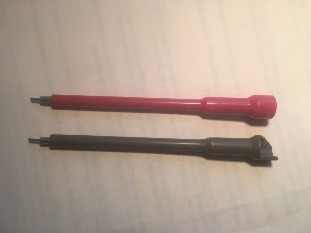

      I'm running short of simple meter probes, eveything I look at is either expensive rubbish or not what I want.
      This is what I've previously used, plugs onto a bannana plug lead (4mm?) so I can change it for a croc clip.
      Does anyone recogise them and know if anything similar is still available?
      Thanks Peter

          CPC do a selection which may be suitable – see here

            I'm pretty sure those were the ones which came with most B.T. test gear when I last worked for them, now 23 years ago. In all that time I've never been able to track down a source of supply for replacements and I too have had to buy sub standard flimsy stuff. I'll be interested to see what else comes up.

              If you are looking for ex GPO what about the Rugby Radio Rally this Sunday at Princethorpe College?

                Certainly the same as Post Office Telephones/BT as they are exactly the same as the ones I use.
                I've been looking for a few myself.

                  Yes looks like they are GPO/BT and we all want some!
                  Think I bought a box of them at the Telford rally some time ago. Cannot find the box which would have the part no on them.

                      The old BT leads were only designed for low voltage use. You should really only use leads and probes with sleeved safety plugs. Buy them from a reptutable supplier like RS Farnel, CPC or electrical factor. If you are a business or employer of any sort you must use appropriate safety leads. For domestic mains on the "user" side of the socket they should be "CAT II" at least andfor house wiring work CAT III see http://www.hse.gov.uk/pUbns/priced/gs38.pdf

                        Over the 33 years I worked for PO/BT I had pretty much daily contact with their multi-meters, both as an exchange maintainer and as a linesman. Over that time the test gear was updated and the test leads too. One of the more annoying "improvements" was to the test leads which joined the probes, pictured above in the original posting, to the meter. Later ones of these had spring loaded insulating shrouds which covered the bare metal lead ends if they weren't plugged in. These had the very annoying effect of forcing the probes off of the end of the meter leads at the crucial moment. The need to get the probe onto a soldered tag deep inside a switch was difficult enough without the thing coming away in your hand just as you were going to look at the meter.
                        The latest standard test leads are next to useless in those type of circumstances, so the message must be look after any of this kit you still have, there ain't going to be anymore.

                          Testing has become increasingly difficult as the requirements for shrouding have become more onerous. Needle points are useful for checks on PCBs that have been lacquered, they can also be useful for piercing the insulation on cable, obviously this must only be used where the pinhole left will not compromise the safety and integrity of the installation and personnel. Sometimes you can have fond memories of slate backplanes and rigid bare interconnections, accessibility was easy but so was an accidental touch when live testing.

                              Yes spring loaded shrouds were really annoying with leads popping off all the time. Also had bad experiences with lower priced meters belonging to others, the meters work fine but the leads just dont last.
                              Sorted for now but its opened my eyes to whats available for the future so thanks everyone.

                                  The 4mm plugs with spring loaded sleeves are pretty useless and no longer common (or acceptable for new mains rated leads).
                                        Don
                                        Still got mine and they still push the probes off smiley
