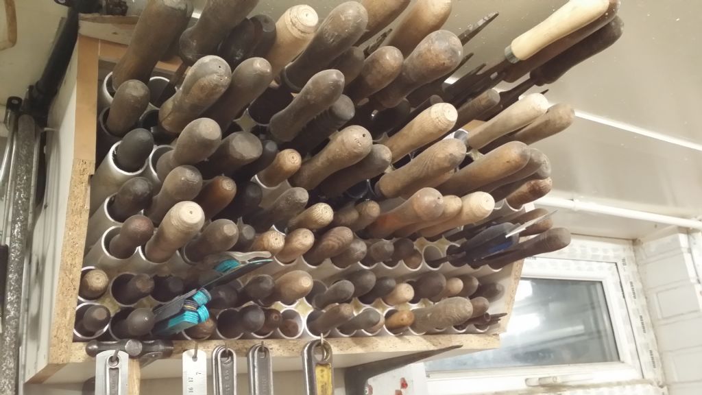

          #326708
          paul rayner
            @paulrayner36054
            this is how I've stored my files. I just used 1 1/4" waste pipe cut to 3 different lengths, stick together with expanding foam and cobble together a box to go round it.file storage.jpg

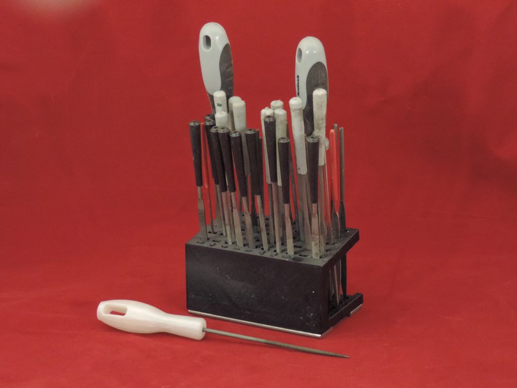

              #326739
                3D printed needle file rack. IIRC a few stubs and 1 or 2 Vallorbe in there… mostly Draper and obscure names. The 3D printed handles off thingiverse are great, I now have many more:
