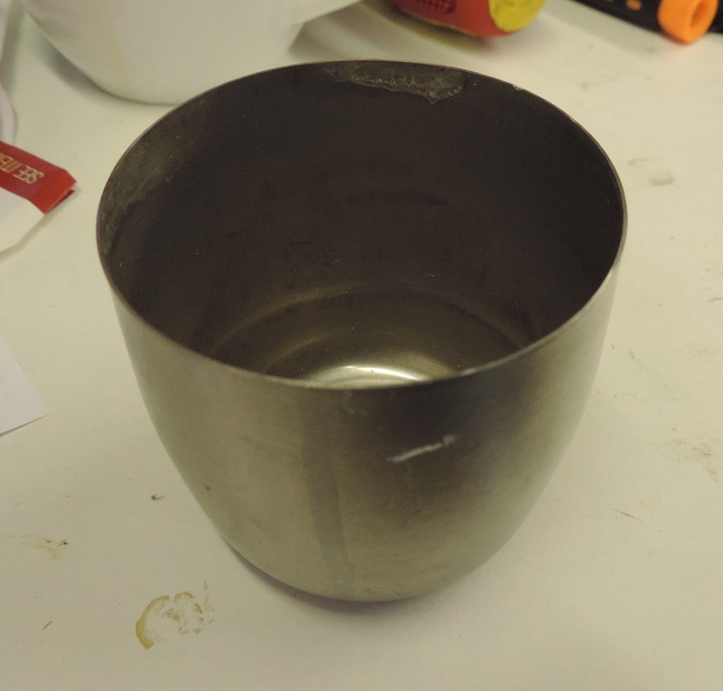

            It might be more reliable to make some sort of bead roller to use on a section of thin stainless tube. If the size is right the sort of stainless used for things like toothbrush holders and cruet sets can obviously be formed into deep shapes, like cartridge brass. I imagine it would need some sort of heat treatment first.

                      I don't think I expressed what I meant very clearly. I meant you may be able to use an off the shelf item like the flask top below as a starting point. The Range and pound stores are a good source of cheap, thin stainless steel items. And those useless travel coffee cups that keep appearing in our cupboards! As the grain runs around not along the cup below, I think it is spun, but I suspect other items are made using dies.
