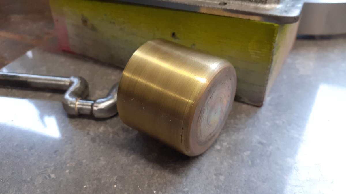

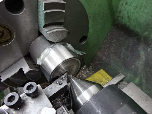

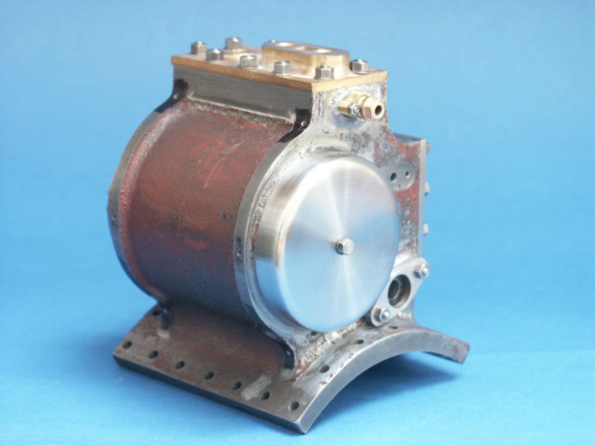

                  #785802
                    Another one who has only had the need to do it once. Steel just over 2″ dia with a 3/8″ return. Think it was 22 or 24g
                    I turned a hardwood former and held a ring spanner in thetoolpost and used the hard chromed convex part of teh ring as my tool.
                    PICT0067
                    I have needed deeper cups a couple of times but took DC’s option of turning to about 1mm thickness from solid, then put it onto a wooden former to finish turn to 0.5mm thick wall and base, this one is stainless 303
                    DSC03086
                    A soft grade of aluminium or spinning brass may be easier than steel. This is a nice deep piston spun by a pro from spinning brass that came with the castings

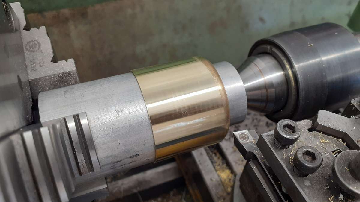

                    #785818
                    Andy Stopford
                      @andystopford50521
                      I’ve only done it a few times – I found that, at least for a simple boot polish tin lid sort of job, fortune favours the brave. A single good hard yank with the tool will flip the rim over perfectly. Do it too timidly and you’ll get a pie crust.
                      I’m not too sure about using soft materials – I remember having a real struggle with soft aluminium, requiring numerous annealings, in an attempt to make a pair of headlamp trims. It looked pretty rubbish, and wouldn’t polish to look even vaguely like the original chromed items, so I used hard un-annealed brass sheet and it was much easier (and looked spot on when I’d had it chromed).
                      1mm-ish steel worked OK too.
                      #785820
                        That commercially spun one was certainly a soft brass, you can see a few bits of swarf on the tool holder where I had to true it up, curly not the chips you tend to get from the harder brasses.
