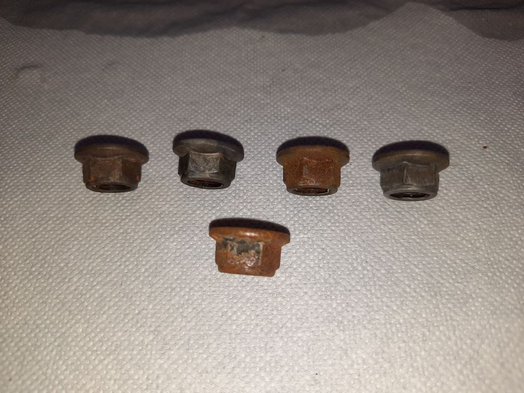

            While restoring a bike I had five identical rusty nuts taken off a sprocket carrier so decided to do a little experiment. Keeping one nut back as a control item I tried 4 different acid solutions overnight in an unheated garage to see what the comparative results where.
            The picture below shows the control item at the front and from left to right:
            • 14% sulphuric acid solution;
            • Gateros acid salts made to recommended solution strength;
            • White vinegar (5% acetic acid); and
            • Citric acid crystals made up to 3 heap teaspoons in 200ml aprox water.
            The results show that the vinegar was the least effective with the sulphuric not much better. (As a side note sulphuric acid tends to be more reactive with organic materials than metals compared to hydrochloric acid. Harpic toilet cleaner contains hydrochloric acid and can be used as a mild metal cleaner.) The Gateros product left a dark tarnish.
            The clear winner was citric acid. It was also the cheapest, costing £5.39 for a kilo from eBay.
            As all four products reduced the rust there were no losers and leaving the nuts to soak for longer or in a warmer environment would also have improved the results.

              #586393
              noel shelley
                @noelshelley55608
                Graham, purely on a note of safety, they look like nyloc nuts and as such should not be reused ! Noel.
                #586398
                Graham Stoppani
                  @grahamstoppani46499
                  Posted by noel shelley on 20/02/2022 11:24:39:
                  You're right Noel. They were destined for the bin anyway so I thought I'd just experiment on them on their way there.
