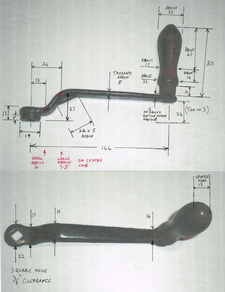

      Hi,does anyone own one of theese?i would like to know the dimentions for the hand crank as mine is missing,also what is the scew for just below the flywheel.Please look at photo in my album ive tried to put it on but wont do it.

            Hi Kevin, I have one that looks identical, but it is un-badged. On mine the front cover is 110mm long, the flywheel is 124mm in diameter and the cranking handle is 144mm between the centre of the square hole that fits the spindle squares and the centre of the wooden handle that is used to crank it. The set in the top of the cranking handle is approx. 30mm from the face that is close to the drill body when it is in position and the centre of the handle and is approx. 34mm down from the square hole. The handle also toe's in towards the drill body, the wooden handle is 80mm long. You can view my one stripped down in this **LINK** although the last three photos are not part of this drill.
            The screw just below the flywheel puts pressure on to the shaft attached to the flywheel, via a spring and a steel ball. Turning the screw inwards puts pressure onto the shaft which in turn increases the inertia on the flywheel and thus drives the drilling spindle downward with more force.
            I can do a sketch of the handle with the dimensions on tomorrow if need be.
            Regards Nick.

                Thanks neil for photo,yes Nick that certainly look like mine thats a great help if you could do a sketch of the handle that would be great,i notice that the screw unerside of the flywheel has a spring and ball on mine they are missing, is this for tention?I got mine at a carboot a while ago for a tenner thout it was a good price so i snapped it up,just had a mesure and it seems to be the same as yours nick.Thanks for the responce and i will look forward to seeing the sketch cheers.

                  Hi Kevin, hope you can understand my photos of my cranking handle with the dimensions added.
                  Dimensions of Cranking Handle
                  Forgot to add some diameters, the part of the cranking handle under the wooden handle, which is 18mm and the spindle which the wooden handle turns on is 8mm, and the steel collar on the wooden handle is 15mm.
                  Regards Nick.

                            Many thanks Nick good drawing i wasnt expecting a full detaild drawing like that,and thanks for taking time to do it,i hope my handle will do your drawing justice when made.thanks for the link MichaelG
