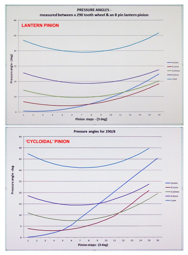

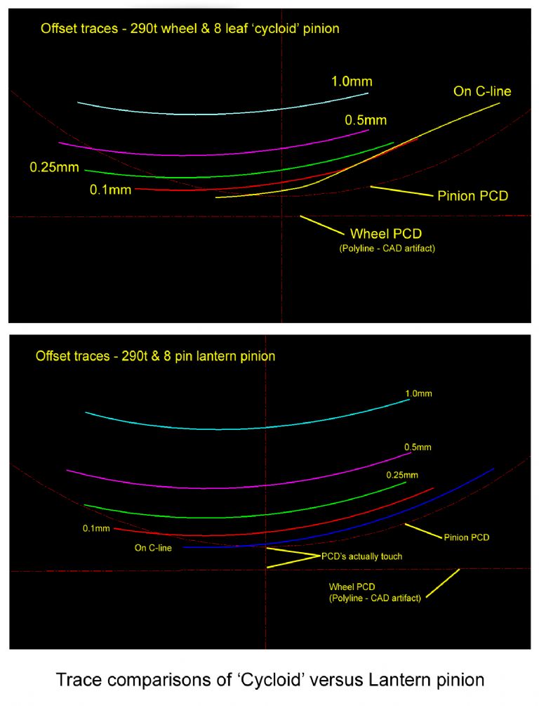

      290-8---five-trace---cycloid-versus-lantern-pinions---02.jpgTo conclude, perhaps I should have carried the exercise to include deepening the meshing, i.e. crossing over the two PCD’s. However, I’m inclined to think that the results would be fairly obvious in that the teeth/leaves/pins would soon clash.

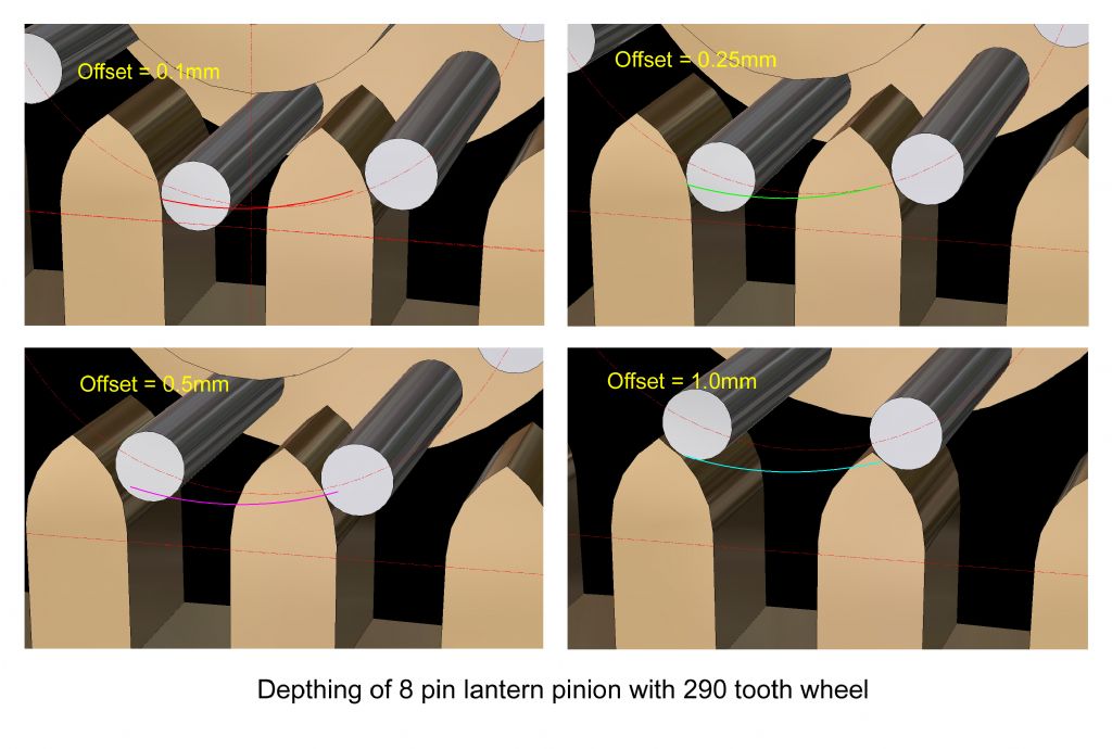

      Unlike the previous exercise where contact of wheel teeth and pinion leaf flanks produced slight changes of contact traces (especially the ‘On centreline and 0.1mm offset), the round pins of the lantern produced smooth curves. Similarly, as here …290-8pin-(cycloidal-&-lantern)---pressure-angle-comparison.jpg
      … the cross-overs of the pressure angles are less severe.
      Finally, and despite my own luck, only slight changes in depth from the theoretical (i.e. less than 1.0mm) suggest that depthing, at these sizes in particular, needs to proceed with extra care. No doubt for those with depthing experience, you will recognise how the meshing behaves. Too deep and there will be a gnashing of teeth? Too shallow, more gnashing?
