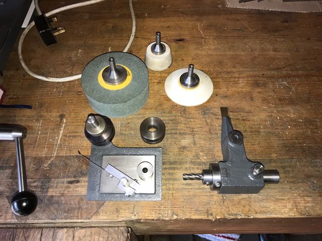

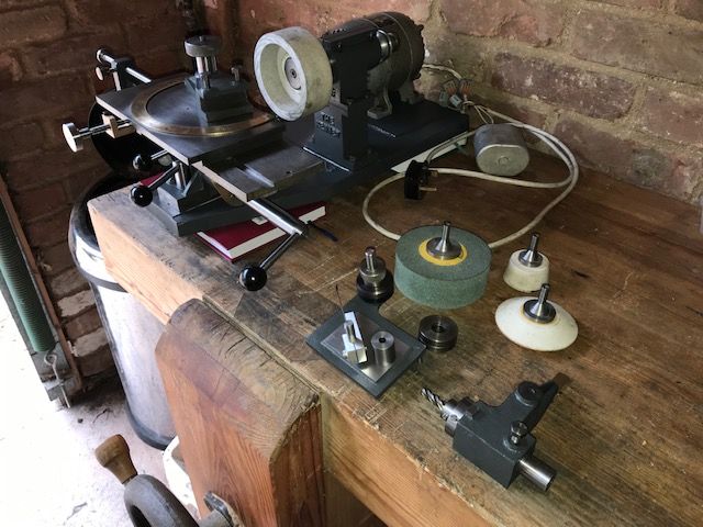

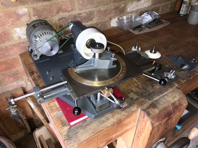

      I've just about finished a Kennet Grinder I recently bought off ebay. It was part machined and not in the best condition, but it did have all of the castings and plans. So, after making the various missing bits – pulleys, stops, etc. – and finishing off the three part completed toolholders, I hope I've got a decent little tool grinder. I still need to add a power switch, make a box for it to sit on and complete the set of end mill adaptors. I should also sort out a guard of some description around the wheels.
      MES Kennet Grinder
      MES Kennet accessories
      MES Kennet Grinder
      Edited By smf on 12/05/2022 20:33:37
      Edited By smf on 12/05/2022 20:34:24

          Nice toolgrinder. An ER collet block could hold milling cutters for sharpening the end.

            Very nice ! Like thor I would consider ER collets 32 in size. I would also put a guard/ sheild round the motor to prevent dust being drawn in. It still needs cooling but try to keep the worst of it out ! Noel.
            #598107
            ega
              @ega
              If practicable, the motor should be positioned so that the cooling airflow does not draw in the grinding dust.

                Thanks for the replies. I'd thought of using an ER25 collet holder (as I don't use milling cutters over 16mm) but there isn't really space to incorporate one with the existing end mill holder. I should also say that the existing holder works well and it's much cheaper and easier to make some adapters for it given the small number of end mills and slot drills I use. However, at some point I plan to make Harold Hall's end mill holder as I think it can be adapted to fit the Kennet. That would enable me to grind the flutes of cutters. I would try to make that with an ER25 holder. As for the position of the motor, that is fixed in the design. I'll see if there's a sensible way of incorporating some dust protection.

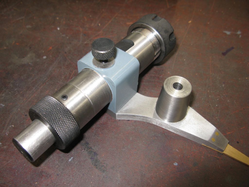

                  img_0124.jpgThis should be a picture of the ER25 collet holder I made to fit my Kennet, all fabricated from odds and ends because as you say there is not much room with the existing casting. The collet holder is an ER25 straight shank one, unfortunately I bought mine from a well known UK tool supplier that also sells on ebay, and the chuck was .005" out, and was not as shown in the pictures drilled through. Couldn't send it back as it had languished in a drawer for a year or so before i looked at it closely, fortunately managed to remachine it and drill it through.
                  Have not tried sharpening any milling cutters on it yet ,but it is most usefull for making D bits and simple reamers, and screwdrivers ground on it are excellent, Wouldn't be too difficult to arrange a finger stop and alteration to enable the collet to slide and thus sharpen the sides of cutters, some method of locking the Kennet table wouldn't be too hard to arrange
                  Edited By Dave Wootton on 14/05/2022 13:29:16

                    Dave – Thanks. That's really helpful to see.

                        Concerning dust its well worth rigging up some shields and casings with vacuum cleaner fitting ducts to collect the grinding dust and keep it out of motors et al.
                        Henry with a HEPA bag will be fine. Dyson and ordinary cleaners will go pop.
                        Whilst you are at it adding similar to your grinder / wire brush / linisher et al will be well worth it.
                        I splashed out on a Morrisflex linisher and double ended grinder / wire brush units with built in vacuum collection devices. Even at E-Bay prices a moderately painful pair of purchases. But objectively well worth it for the reduction in cleaning duties. I'm lucky insofar as I have space for a separate section for such dirty work. Basically a small doorless room 8 ft (ish) square. So dust build-up wasn't a major issue beyond the need to swab out every month or three when I got fed up with getting black fingers every time I touched something.
                        Since installing the machines with extractor bases the dirty shop is probably cleaner than the main part. Cleaning is more on a "whilst I have the shop Henry out" basis than dire necessity. Helps that the sandblaster also has its own extractor and collection system. My Clarkson T&C grinder is an early version with minimal wheel guarding so I copied the late type shroud.
                        Pulling out the dust collection trays for dumping makes for sobering thoughts about the good old days working in the open. "I used to breathe air with all this stuff floating around in it." Ooops.

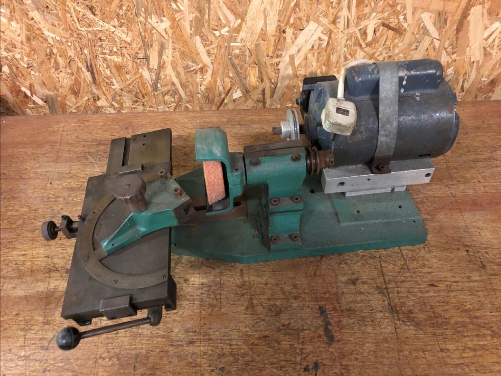

                                    Regarding a wheel guard this is what my yet to be received unit has fitted:
                                    I am no expert but could that be a Quorn casting? If so my friend was able to buy one from Hemingway at a reasonable cost as it was missing from his recently acquired Quorn.
                                    As you can see there are various parts that are missing or probably never made and I can see that there are some clamping? Devices at each end of the table that I haven’t seen on other examples.

                                      Tony – it would be great if the Quorn casting fits. I think you can do a fair bit with the lathe tool holder that you have. For example, for drills up to about 3/8"/10mm, I was contemplating making 1/2" blocks to fit in the lathe tool holder. These would have the relevant size holes drilled thriough the length and a brass set screw to hold the drills in place. Stefan Gotteswinter has a youtube video on grinding the four facets on drills. You'd have to adapt the techniques slightly given the limitations of the Kennet, but I think it should all work without having to make lots of new attachments.

                                        For my Worden, like Giles Parkes, I made up a holder for ER25 collets. These enable me to grind End Mills and Slot Drills; and allied to the 31 degree wedge for the "standard" drill grinding attachment, four facet ground drills,
                                        ER collets allow Imperial, Metric, Letter or Number drills to be held with the minimum of holders, ( 13 rather than over a hundred needed to make a specific holder for every size, as the Hemingway basic instruction suggested )
                                        The clamp nut required some machining of both front and back faces, at suitable angles, with a carbide tool, to maximise clearances between wheel and table.
                                        With the drill inclined at 31 degrees, the end angle will be ground to 18 degrees, ( 118 / 2 = 59. 90 – 59 = 31 ) and the secondary and primary clearances are obtained by swinging the holder about its pivot point.

                                                Adding a shop made ER20 collet holder (A la Giles Parkes ) to the Hemingway Inclined jig, enables almost any straight shank drill, upto 13 mm to be held for grinding, and with the holder being square, repositioning it to grind the other face or lip at the same setting is easy. (I marked the rear face on the one that I made, making it easier to keep track of where we were.)
                                                Having four faces, in the conventional Worden Tool Slide, it can be used to grind Slot Drills, or four flute End Mills, as well.
