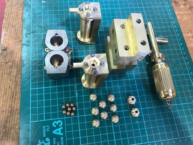

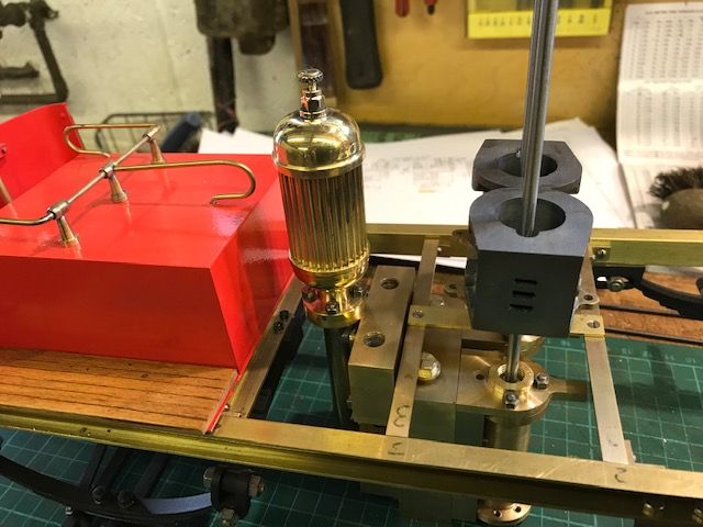

      Well I'm back from my tour of the UK from the Lake District to The Yorkshire Dales by way of Devon. In between pitstops I've managed to get the water pump finished. Here are the parts:
      And here is the assembly complete with the steam cylinders:
      and placed in the Merryweather:

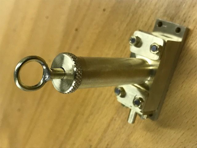

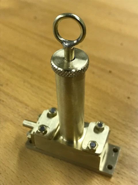

      Before I go any further I need to pressure test it. Been racking my brains thinking about how to do it and then it came to me. The Merryweather already has a hand pump for the boiler feed, so I can use that. And here it is:
      My only problem when I build it is how to seal the joints. I have some fibre gasket material, Hylomar sealant and some PTFE tape, but haven't a clue which to use and where. Or should I get something else? Any suggestions would be most appreciated.
      Incidentally, I have just realised that this forum doesn't like Portrait photos. Note to self for the future.

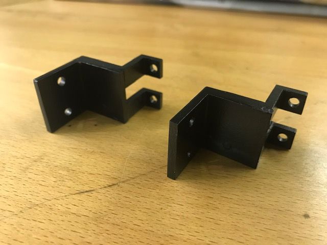

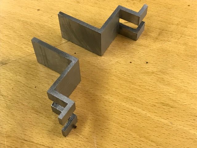

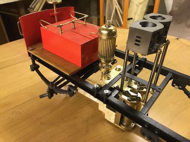

                        These brackets look fairly straightforward, but they have given me a real headache. So I thought they deserved a mention in my build thread::
                        The drawing called for them to be bent from 3mm strip. But I wasn't confident in making the double bends in the right place, so decided to machine from solid. Two pieces were glued together so I could machine them as an identical pair. I chain drilled first to remove as much metal as possible:
                        This is where the problems started. Because I'm using Stuart cylinders I had to recalculate the width, and somehow while allowing for the 3mm thickness I ended up with then being 3mm too wide. I couldn't face throwing them away and starting again, so I cut off one face and screwed and glued another piece of machined angle. This gave me the opportunity to use JB Weld for the first time:
                        I painted the chassis while I was at it, and here is the pump assembly finally in position:
                        Next up, a leek test. I have learned from bitter experience not to delay this!!

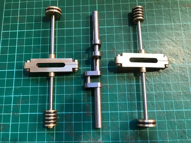

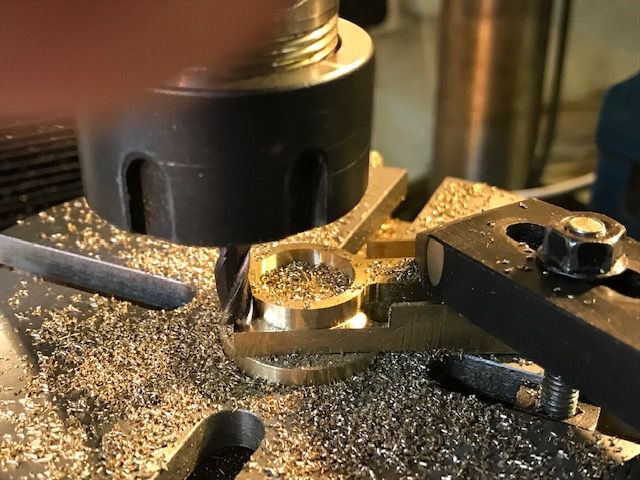

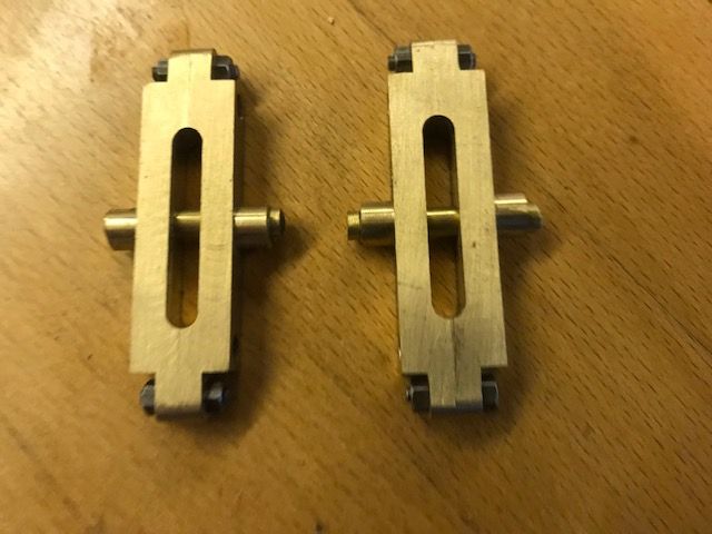

                            Finally got all the parts for the engine finished. First the crossheads:
                            and with the pistons and crankshaft:

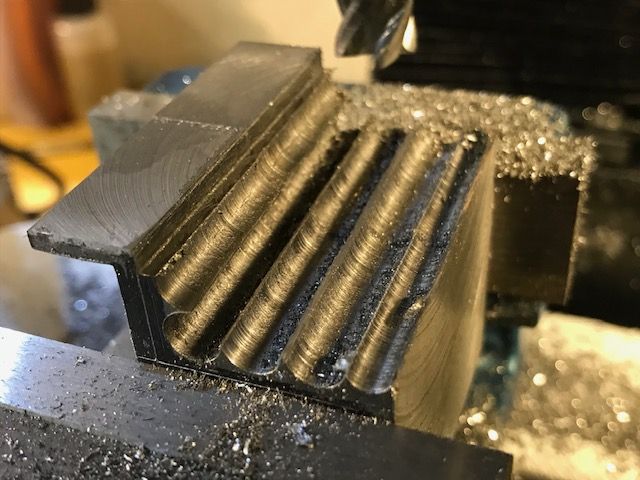

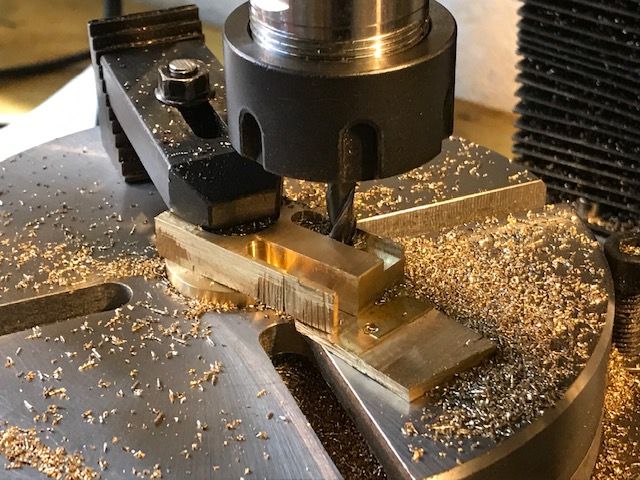

                            and to show my new toy milling machine, working on the eccentric rods:
                            and finally the valve chest and other bits:
                            Spent ages lining everything up and getting things to move almost freely. I've got a way of mounting the assembly on the lathe so I can then try and run it in and get it rotating smoothly.

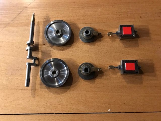

                                  Still struggling on. Finally got the engine assembled and after ages finding the tight spots (I now have a new meaning to the term “Quantitative Easing) it now turned over relatively smoothly. First run on air would not rotate, but there was a significant downward thrust at times. I had followed the dimensions in the book for the valve mechanism, which occurred to me was a metric conversion from the original imperial drawings. Upon reflection it occurred to me that there may be minor differences. So I reduced the width of the slide valve by ten thou each side. After a lot of fiddling with the timing – bingo, it run. It needed twenty psi to get it started, but it ran like the clappers and nearly shook itself off the bench! And then disaster. The crankshaft had come loose. I had prefabricated it, cross pinned it and loctited it, but two of the joints had come loose. So off to make another. I don’t think I can retrieve it so it’s a matter of staring from scratch. I’m wondering whether to persevere with loctite or to try and silver solder it or even soft solder it. I’m a bit concerned that if I use solder that it will distort. Help please, this is driving me mad!!!!!
                                  Bob

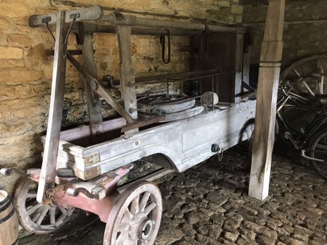

                                        059acea8-460e-4837-a530-b679feedb730.jpegFound this on my travels, but a bit older than mine:

                                          At long last we have success. After so many attempts at getting the crankshaft made it runs. And to think that I was seriously thinking of abandoning the project and throwing it in the bin.
                                          It is still a little tight and doesn’t turn as freely as I would like, but I can put up with it for now and it may improve with running. I have noticed however that the air coming from the exhaust seems to come out stronger from one cylinder than the other. I tried to set the timing so that the valves opened just before tdc. Perhaps one of you experts can advise which is better.
                                          Bob

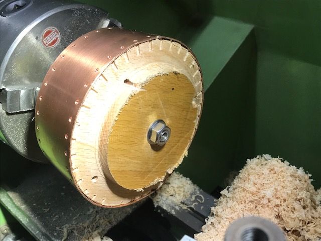

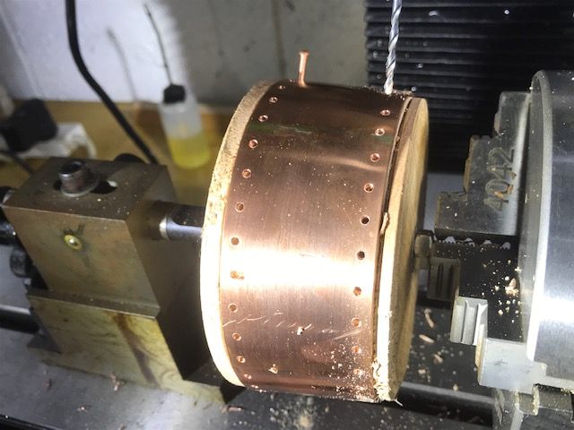

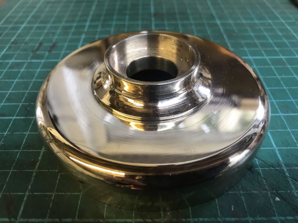

                                                    I said that I was a novice ! Made a lovely hardwood former to shape the lower tapered part of the boiler. Sawed off the excess overlap after bending and silver soldered the join after a fashion. Drilled two sets of 36 rivet holes at a 6 degree angle by tilting the head. Being a novice I completely forgot that the burrs from the drilled holes would dig into the wood. No amount of (gentle) tapping or prising would persuade the ring to separate from the former !!!
                                                    So as a last resort I decided to (hack) machine away as much wood from the former as I could to expose one set of rivet holes
                                                    The former is actually made from two pieces of 25 mm beach screwed together. So I figured that if I drilled four clearance holes in one piece and bashed four screws it was worth giving it a try to separate the two pieces to improve my chance of getting the ring off the other piece of wood.
                                                    And bingo, it worked. And finally the ring came off the former in one piece. Got to fettle it up and figure a way of riveting it to its mounting plate. That will be in a while since SWMBO wants to go off in our caravan for a while.
                                                    But it gives me an opportunity to think about how to fix those rivets. My inclination is to glue the lower ones in place since they are purely cosmetic and don’t hold anything. Especially as the annealed copper scratches even when you look at it.
                                                    When it comes to the upper mounting plate I thought about tapping the end of the rivet and bolting the ring to its mounting plate. The rivets are 3/32 dia which is only a nat’s whisker over 8ba. So a little skim on the end of the rivet would make this possible which would avoid any bashing to form a proper rivet. Any thoughts from you experts would be most appreciated.
                                                    Bob

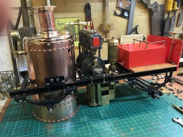

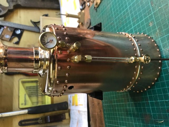

                                                      Still plodding on slowly thanks to the demands of Mrs W and her other hairbrain projects. But anyway, I have finished the boiler and mounted it in the chassis. Bit of a problem because I used the boiler tube which was 110 mm diameter rather than the 4 in as specified, being the nearest I could find. The upshot was that the rear cross brace and axle fouled. So I had to move them both which was a nuisance. Anyway I got it all to fit and am quite pleased with the results. Here are a few shots of the installation. Next up are the water tanks which will be interesting.
                                                      Sorry about the orientation. Blame Steve Jobs.
