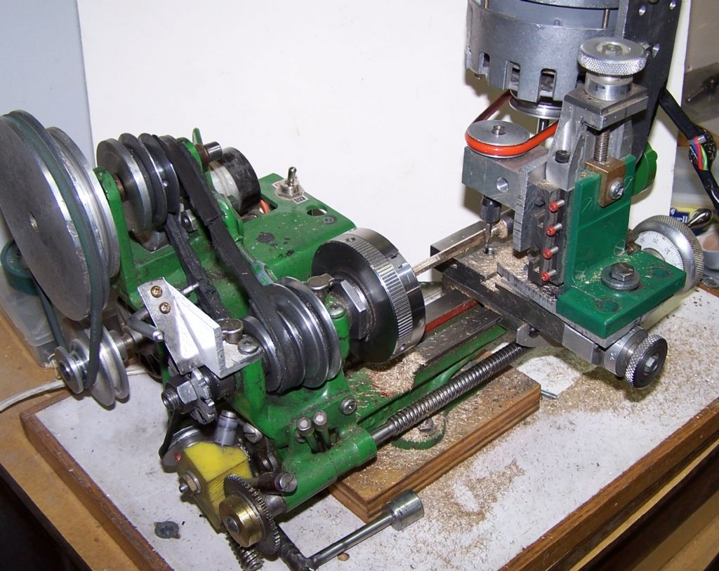

        Saskatoon Model Engineering Society
          @saskatoonmodelengineeringsociety
          Posted by Neil Wyatt on 11/10/2016 08:13:51:
          Posted by Saskatoon Model Engineering Society on 11/10/2016 02:44:16:
          Change gears look good, Neil. I gave up on doing a change gear set for mine and made a belt and worm wheel single speed leadscrew drive instead. It can be seen in the photo, the yellow thing is the plastic bearing block for the worm which can be swung in or out of engagement with the leadscrew gear.
          A bit off topic, here's a pic of mine with a shop made milling spindle and vertical slide being used to mill lengths of home cast bronze into 5/32" hex bar stock for making #4-40 UNC hex head bolts.
          MakingHexBar
          Is here an Adept under all that?
          Yes there is, Neil. Described in my post of 10/10/2014.maximumdiameter.jpg
