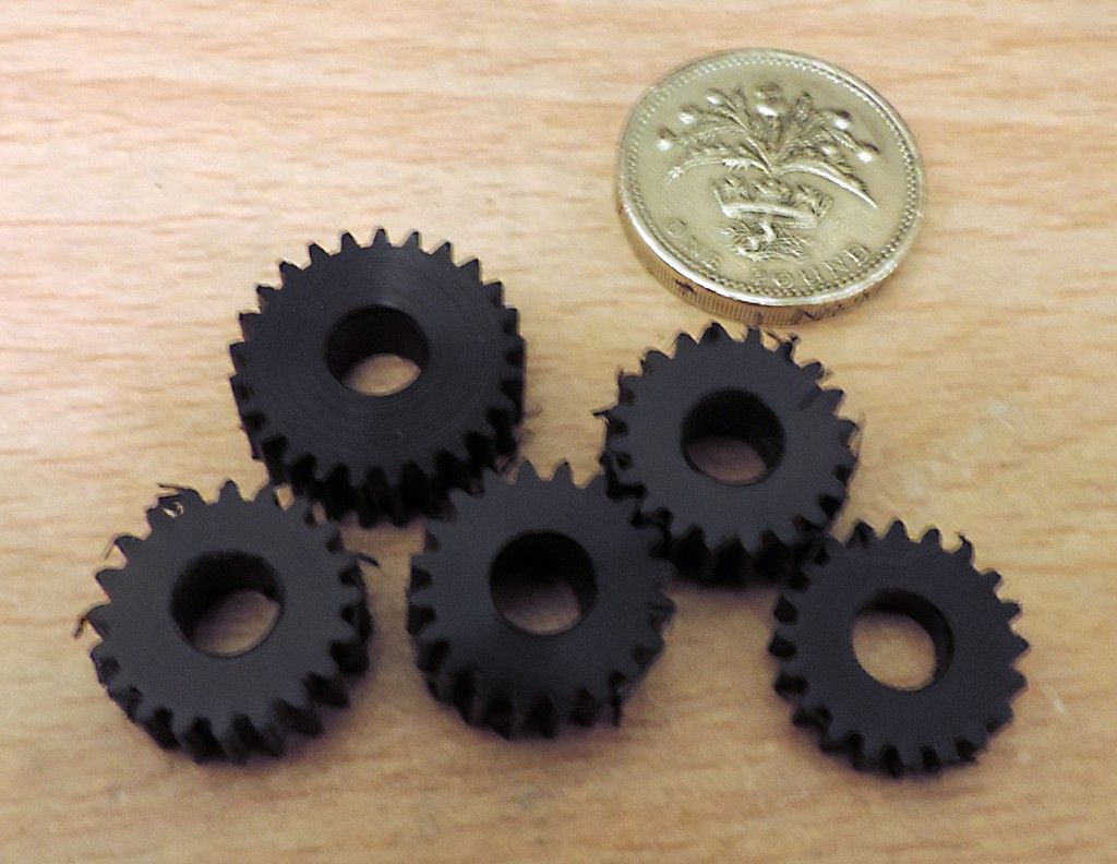

      Now sacrilege time – I'm contemplating making change gears from plastic!

          The idea of churning out a big pile very quickly by using a parallel (rack form) hob appeals.

              Real sacrilege…….printed plastic gears using a 3d printer.
              Already there are print files available for mini lathe change gears on thingiverse.com.

                Art Fenerty's Gearotic program will spit an STL file out of any gear it can produce, internals, ratchets, cycloids etc

                        I wondered if plastic gears blanks, mounted on a mandrel could be formed by heating the outer edge and running a metal gear against the softened plastic, allowing the form to harden as the heat is gradually removed. Some facing cuts would be required obviously and maybe the OD machined to allow for the root clearance.

                                                    Not much has happened… but I'd like to show some progress at MEX. next task after the back gear and new headstock/spindle is screwcutting, which means a 60T gear for the back of the spindle minimum!
                                                    Gears are metric as I'm more likely to find mating gears for future projects that are mod than dp. I chose 0.7 mod as this is about the smallest size where a 20T gear can comfortable take a sleeve with a key and have enough meat in spindle,sleeve and key.
                                                    I used the rack form cutter method and it was a breeze. The cutter turned the nylon into fine powder and left a nice finish. I made four 20T gears on a stick. Still some burs to rub off, this is a bit blurred (1/2.5 seconds!)
                                                    I'm going for mostly nylon gears 1/4" thick. I started with a 25 and some 20 tooth gears. I'm not sure what size to use for the tumbler reverse yet, it will probably be 25.
