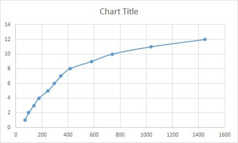

It's interesting looking for a suitable countershaft ratio. The back gear is fixed at 1:1 or 4.2:1, the pulleys offer 1:1.4 and 1.4:1 (i.e. two speeds in ratio 1:2). With an angled belt and a tensioning arrangement, I can also add 1:1 on the pulleys.
So the question is, what ratio to use for the countershaft? With a motor speed of 1450 rpm and a bit of help from Excel, countershaft ratios of 1.4:1 and 3.5:1 give an almost perfect spread of speeds:
C/Shaft |
B/Gear |
Pulleys |
Speed |
High |
High |
High |
1450 |
High |
High |
Med |
1036 |
High |
High |
Low |
740 |
Low |
High |
High |
580 |
Low |
High |
Med |
414 |
High |
Low |
High |
345 |
Low |
High |
Low |
296 |
High |
Low |
Med |
247 |
High |
Low |
Low |
176 |
Low |
Low |
High |
138 |
Low |
Low |
Med |
99 |
Low |
Low |
Low |
70 |
If I don't want the angled drive on the main pulleys, I can just have a third countershaft ratio between 1.4 and 3.5.
All this begs the question, why do so many machines have really poorly spaced speeds? Is it because the designers didn't have excel?
