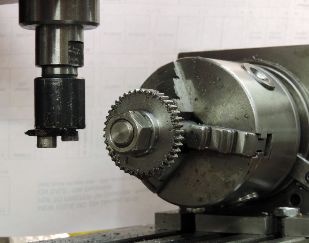

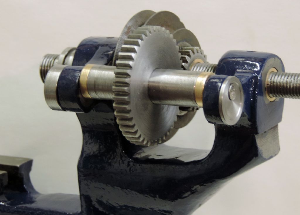

                      #170947
                        Your first chance to see the new headstock properly done.
                        Also, real progress with the back gear. The 22-tooth pinion is from a paper shredder, so I feel a bit of a cheat, but the 41-T gear was made this evening. The eccentric allows them to be out of mesh by about 1/16 and to engage more than fully. Next I add a 43T/19T pair at the front.

                          I notice you aren't using a nice round figure for the bull wheel. Will you be drilling index holes? I am contemplating a back gear for a different small lathe using a 75 which I happen to have but it doesn't provide useful indexes so was going to drill 24 holes for divisions of 3,4,6,8 which seem to be the useful ones.

                              It should be 43/20 at the front…
                              I could make the bull wheel a 40, and match it with a 23, but I want to maximise the reduction rauio.
                              One possibility is a 45 and an 18 or a 48 and a 15, but a 15T will struggle with a 1/2" bore".

                              I am a little nervous about this, although the eccentrics a are good fits. Worst case is fitting a detent at both ends, instead of just one. Still, this arrangement woks on Boxfords (albeit a bit heavier duty).

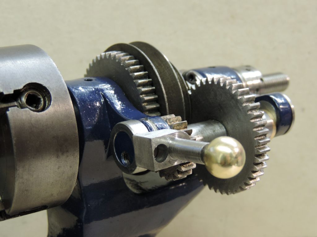

                                                  #172752
                                                    I've almost completed the Back Gear. The elegant brass knob is a sprung detent for engaged and disengaged. Still thinking about whether I can make a bull gear to pulley lock that doesn't involve a removable pin.
                                                    #172754
                                                      That's looking really good, Neil star
