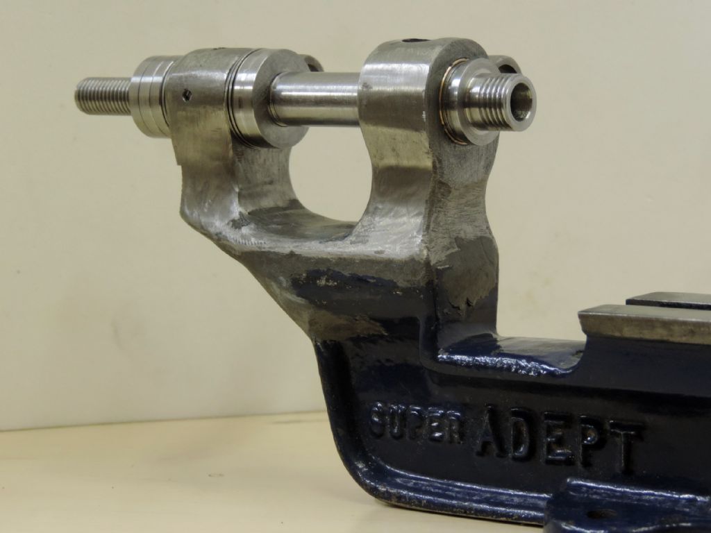

            Thanks Ian,
            I'm sure my new spindle could take more power, I just did a mental calculation of the power that I could get through 1/8" thick 1mod gears at 1000 rpm using some formulae I found in the Davall gear handbook.
            Run in at 1200rpm driven by my main lathe and lots of 3 in 1. Spindle feels lovely in the bearings now, pushing it into the tapered bearing as hard as I can, it won't drag or seize. Getting keen to see it in action!

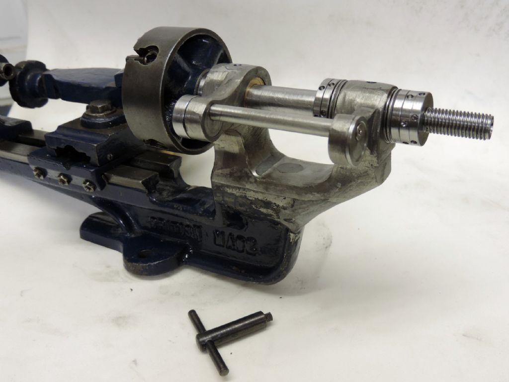

                  #169677
                    ETW recommends similar powers for lathes of this size. Nothing helpful in Machinery's though!
                    Made the bearing thrust rings (and a spacer to go in place of the gear at the back of the mandrel), still have to either drill holes of make slots for adjusting spanners.
                    You can see progress with fairing in the new headstock as well. Pretty sure it will be at least as good as the original.

                                  #169996
                                    A bit more progress, this is the back-gear eccentric shaft in place, plus I've finished the bearing adjustment washers.
                                    Apologies for the grubby background.
                                    Much delay now while I ponder making the gears.
