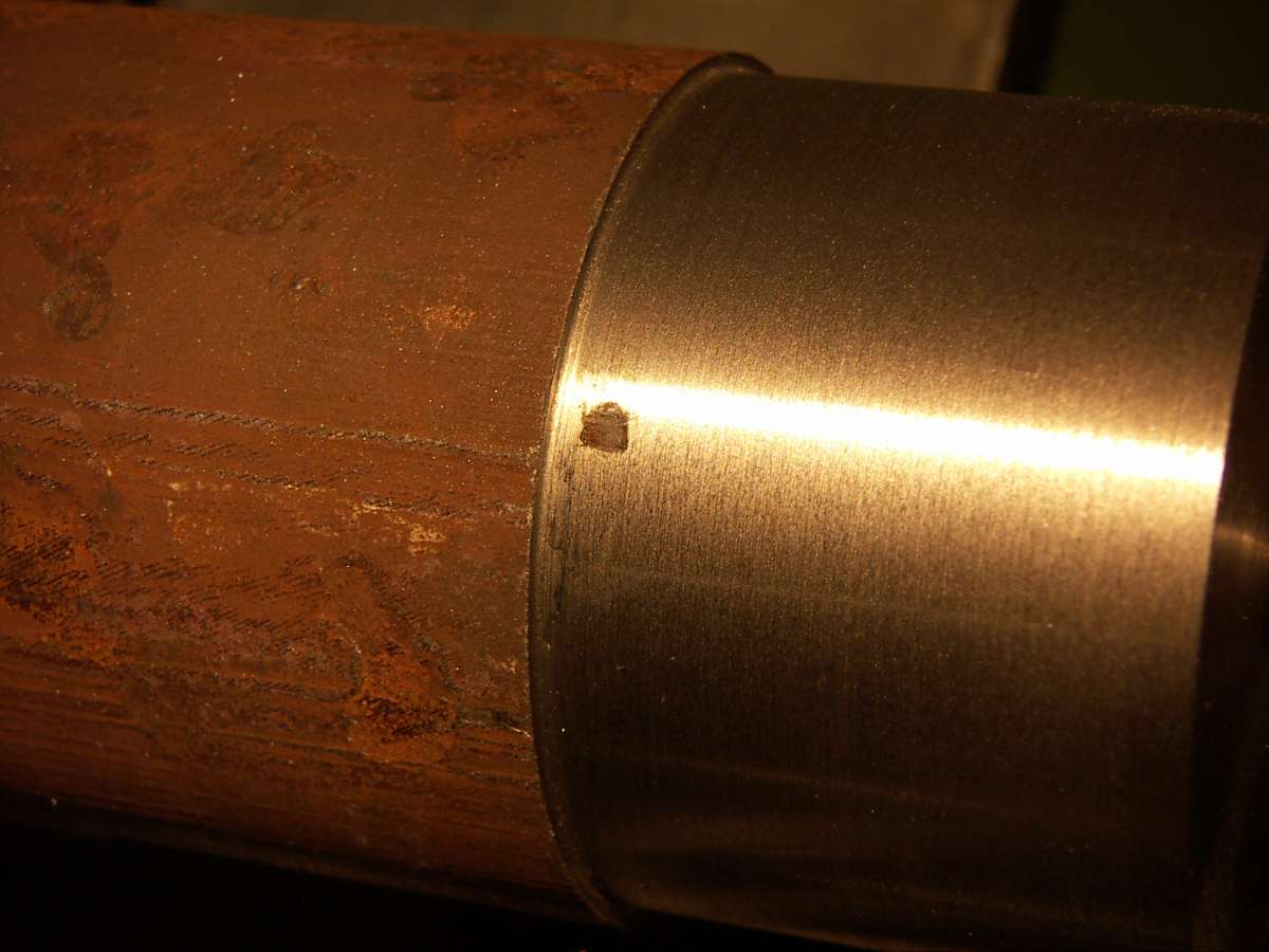

      What depth of defects in the surface of cast meehanite bar would be considered excessive ? Turned a 50mm bar down to 48mm and still have a defect of at least 0.5mm deep which is going to be close to the finished size.

        The risk of defects in any cast item or material is always possible and not just on the surface. Bearing in mind the casting process, although efforts are made to remove slag or detritous both before and during the pour problems can still occur. Contact the supplier with a view to a replacement part or item. Taking only 1mm off is a small machining allowance.  Good Luck. Noel.

          Pretty much none. What you have isn’t Meehanite, which is a trade marked production and quality control process.
          The seller has used a false trade description for common continuously cast iron bar.

              This website gives a ‘surface machining allowance’ of <3mm for ductile cast iron (“S. M. A.” means ” Surface Machining Allowance”. That is the allowance of removing the surface irregular part.”)
              https://www.us-metallteile.de/cast-iron-bars.html
              As your defect is only 1.5mm below the nominal surface then it’s probably not unreasonable.
              You should allow a  fair machining allowance anyway as ductile iron is often chilled on the surface, and you need to machine through this to get down to metal with the ductile properties you are paying for.

                  Anything being sold as Meehanite is likely to just be grade 250 grey iron not ductile iron
