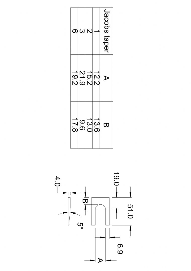

            If the chuck is mounted on a male taper on the end of the spindle, you may have to use tapered wedges to remove chuck from its taper. You can buy such wedges made for the purpose. But you need to be sure that is how the chuck i smounted before applying such force. Pics would help.
            #586413
              This Instructables explains wedges quite well. ArcEurotrade used to sell wedges but it looks as if they only have drifts at the moment.

                    have previoulsy attempted a 'Wedge' seperation again with violent encouragement
                    One wedge is inefficient and likely even counter-productive – especially with violent encouragement!
                    You need two proper wedges acting in opposite directions, thus providing a force in the direction of ejection.
                    Generally, ejection only need a ‘stop’ on one wedge and the other tapping with a mallet. I use them whenever I need to eject a morse taper from my my mills, if more than gentle persuasion is needed for removal.
                    The wedges need to have a long taper, so they overlap each other when in use.

                    DC31k
                      @dc31k
                      This thread has some useful information:
                      https://www.model-engineer.co.uk/forums/postings.asp?th=165978&p=1
                      Dimensions for wedges, should you wish to make your own as attached (derived from measuring the ones supplied by Arc).
