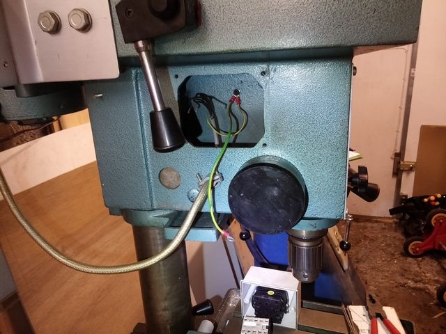

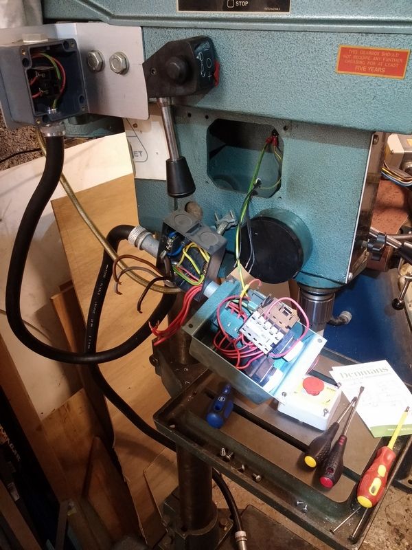

      So, first step was to see what I have got to work with and document the existing setup just in case I want to return it to 3 phase.
      So it looks like the stop start switches are orginal, as is the contactor but the reversing switch and e-stop look to be add ons. Oddly, the reversing switch appeared to be linked out, not sure why!
      Also an interesting arrangement of square of polycarbonate behind the reversing switch, held on with a small stud but no nut…..
      Anyway, that lot was all stripped off, leaving just the ally bracket at the back which I am thinking of using to mount the inverter.

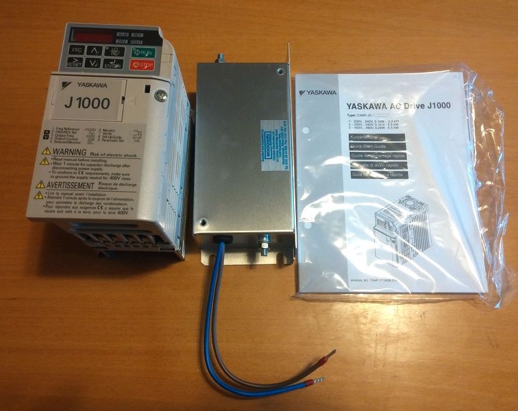

      Next step was to get an inverter. I do have a spare but it is 1.5kW and pretty bulky. Plus it doesn't have a display/keyboard and I have yet to work out how to configure it via RS485. So for this one I decided to buy new.
      Given that, first job was to decide what size. The motor plate says 3A FLA at 240V 3 phase and I will be using this inverter only for the drill so can use soft start. Given that, and the fact it will not start under load I think (hope! ) I am safe using a 3A+ inverter.
      A quick trawl of the internet found a Yaskawa J1000 (0.75kw/0.4kW) that appears to fit the bill at a reasonable price. The two ratings are because it has two modes: Normal duty where it is rated at 3.5A and 120% overload for 60 seconds and heavy duty where it is rated at 3A but 150% overload for 60 seconds. Doing the sums shows that normal duty is good for 4.2A for 60 seconds but heavy duty is 4.5A for 60 seconds. I'll probably use heavy duty although I doubt it will matter much in practice.
      Less than 24 hours from ordering (from http://www.inverters-uk.co.uk) this turned up……
      The silver box in the middle is an emc filter. Previously (on my boxford) I have got away without using one of these but you really should and it can cause real problems with other equipment if you don't so this time I ordered one. It was a bit of a shock to find it has a bigger footprint than the inverter but that isn't really a problem

          What does a emc filter do in practice?
          And what problems will the lack of it do to other equipment?

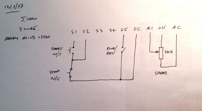

            Next thing to do is decide how to wire it. Obviously the 1st thing to do is swap the motor over to delta configuration but it is snowing outside so I don't fancy going out the garage frown
            In lieu of that, I have looked at how the inverter control can be connected. Looks like 3 wire mode is best which gives me the following:
            I can use the existing stop and start switches but have yet to decide whether to fit the reverse switch and speed control pot. If I do I suspect I will put them at the back with the inverter so my general wiring will be 240V in to the filter/inverter on the back of the drill, 3 phase out to the motor and control cable forward to the existing start/stop switch box.
            What I haven't decided yet is what to do about an e-stop. The inverter will deal with the NVR but it would be nice to have a more prominent stop button so I am wondering about something as a kick switch. The question being where to wire it in.
            I have two obvious options:
            1) as a hard stop input to the inverter. This will have the advantage that it can use braking and so potentially stop the drill quicker. The disadvantage being the (theoretical) chance a control software crash in the inverter means the e-stop is ignored. Not sure what the chance of that is though and, as a last resort, I can always turn it all off at the mains.
            2) Fit the e-stop before in the mains in to the inverter. This has the advantage of not relying on the inverter plus can be used to turn the isolator off. The downside being that the drill will freewheel when stopped.
            Anyone got any comments on this?

              Posted by Ian Parkin on 12/01/2017 17:30:55:
              It creates essentially a barrier directly between the power source and equipment, the power lines which are supposedly vulnerable to electronic noise.
              On our end of the spectrum, i.e home workshop use, where you're equipment is close to the power source, it wouldn't produce any noticeable difference to not have one on a typical inverter.
              However, if you were using it in a big factory where the power line "might" run many many metres(or in an area with a lot of other electronic equipment), you would probably find you would have difficulty holding a particular frequency on finer levels, the fluctuations; a result of the length of the line acting as a conductor for potential interference in the variable power supply that a wall socket gives.
              A reactor is different, where they are designed to stabilize and homogenize the frequency of the power from the wall socket.
              Michael W
              Edited By Michael-w on 12/01/2017 17:51:19
                It stop (or reduces) electrical noise going into or out from the inverter. If this noise is bad it could affect the operation of other bits of equipment, particularly if they are electronic.
                An inverter chops up the rectified mains to create the 3 phases. Given this it is a prime candidate for chucking this electrical noise back into the supply.
                A mate of mine was telling me last night that when he fitted an inverter (I think a fairly hefty one to his bridgeport??) it completely screwed up his fancy fridge (one of those that does ice on demand etc) until he fitted a filter on it.

                  Posted by Toby on 12/01/2017 17:42:50:

                  Hi Toby,
                  The one thing you must be careful with on a hard stop is that when a motor is running at full speed and the input suddenly is halted. The inertia of the rotor continues to spin, potentially sending a backward current to the inverter, to mitigate the effects of this, a braking resistor is often used.

                    Posted by Michael-w on 12/01/2017 17:48:32:
                    Hi Toby,
                    A good point.
                    Sorry, I was probably incorrect in calling it a hard stop. I think the inverter allows you to configure different deceleration times. So for for a normal stop I could program this to something relatively slow (eg a few seconds) to make it easy on the motor but for the e-stop input I could program it to be something much faster.
                    The inverter has two braking methods – an external resistor and DC injection. From what I gather the DC injection can be hard on the motor (it effectively dumps the energy back into the motor rather than a resistor) and isn't so good if the load has a lot of inertia but it is probably ok on a drill for emergency use?
                    Any thoughts on this?

                      I wouldn't disconnect the input to the VFD when it's running as a means of e-stopping the drill. It should survive in the same way that a power cut when running shouldn't cause damage. But it's not going to stop quickly. These VFDs are going to be very well designed and pretty well flawless in operation. If you are bothered about bringing the spindle to a rapid stop, you could just fork out on the recommended braking resistor. Having said that, DC injection isn't going to stress the motor unduly, as the moment of inertia on a drill is dominated by the motor itself. Induction motors are pretty simple and robust.
                      It's a bit late now although hardly relevant when you are talking about a pillar drill but the vector control sister of the J1000 (called the V1000) has a hardware inhibit input called "safe disable" which is intended for use where it used in more safety critical applications. The idea is that you could use this to provide a more failsafe inhibit. It's to ensure you can shut down in the unlikely event that the control software has a wobbly.

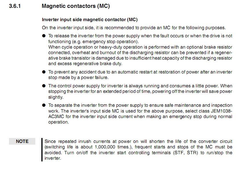

                                            Going on my Mitsubishi inverter the emc mains filter is optional and only fitted if required. It has a built in emc filter. Lots do have now. They also show the fitting of an AC reactor in the mains line if needed. A lot of this is woolly because there are variables outside of their control In other words if the unit does cause interference fit a filter and maybe also a reactor.
                                            They show a magnetic contactor in the supply and point out that this shouldn't be used to start and stop it. It can be done but it will shorten the life of the unit. They also show a current trip pointing out that allowances have to be made for in rush current . Effectively some large very high quality capacitors are being connected to the supply when it's powered up.
                                            Later they give some numbers if the mains to the inverted is disconnected via an emergency stop to the contactor. Life 500,000 cycles dropping to 25 times if used for an emergency stop. (AC-1 rated contactor.) They then go on to mentioning what rating of contactor should be used on the motor side if that is used for an emergency stop. They also discourage doing this. AC-3 rating for any contactor there.
                                            Most of the em noise from these units come from the drive to the motor. They stress single point earthing and shielded cable. Plus earthing of the motor and inverter. Optionally filters can be installed in this line as well. A simple one or one I wish I could get my hands on, a sine filter. (1hp if anyone wants to give me one.) These may be needed I assume on long feeds to the motor.
                                            The earth current flow may have an influence on the rating of any earth leakage trip that is fitted.
                                            They give minimum motor cable sizes based on a max drop of 2% over 20m.
                                            Then comes sensible routing of the control cables. In other word keeping them away from the others. >= 10cm. They show shielded cable being used to the speed pot or current drive and also on the analogue speed output. Not on the rest though as all leads go to the inverter and represent 24v being pulled down with a current of 100ma max. I ran mine in a shielded cable.

                                              I haven't fitted a contactor on mine by the way. I rely on the inverter and a switch. Mit list it as they do because this is often how things are wired, machine tools and conveyors etc. Metal boxed multipole isolator some where. A no volts switch, a contactor and a panic button plus any safety cut outs. People do wire the panic button to the inverter rather than breaking the supply and I understand some inverters say don't stop the machine by disconnecting the supply. I've not seen one though. The panic button wiring will vary according to the inverter. It need to stop the drive and prevent the start button from working. . Mit do a separate safety module but I haven't looked at the data so no idea what that actually does. Might be for something else.
                                              What they effectively say is us a magnetic contactor to power the inverter, include a panic button and no volts type on off switching to the drive to that but start and stop the drive using it's controls. ie
                                              What that means effectively is the usual no volts release switch and that it can be de activated by the panic button. They add a magnetic contactor because the inverter currents can be much larger than what these switches can handle. A NVR switch contains a contactor of sorts so the panic button can simply break the supply to that.
                                              The current inrush when powered up will be there on all makes because of the capacitors in them.
                                              If it sounds complicated I've heard unwiring even a simple Boxford that has been wired to the book can be a bit confusing. Most drop the lot.

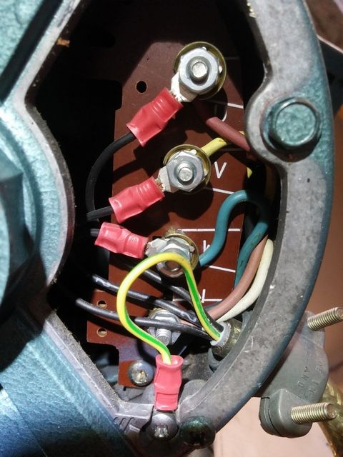

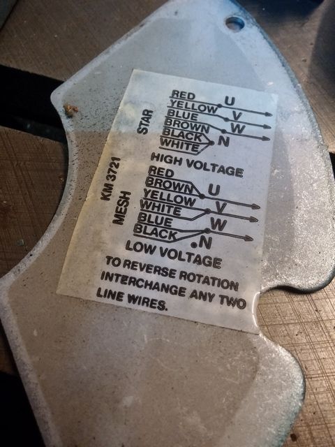

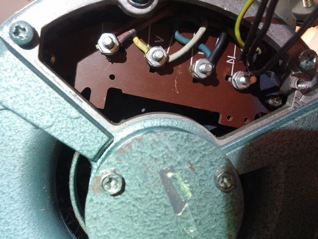

                                                  ok, next quick installment. changing the motor to delta configuration.
                                                  It is a Brook Compton and the wiring info is on the terminal access cover……
                                                  So this is the original wiring in star configuration……
                                                  and this is it changed to delta (or mesh as it is called on the label)….
                                                  I noticed a few things when doing this.
                                                  First the incoming cable appears to be screened SY cable but the screen is not connected either end. Not a great problem, there is at least an earth, but silly not to do it properly.
                                                  Second, I haven't measured it but to my eyes the SY cable looks to be 0.5mm2. If it is, that would be ok in star wiring (1.7A FLA) but a bit marginal in delta (3A FLA). I need to check it properly but I might end up replacing it.
                                                  Lastly, you can see crimp terminals were used, trouble is the washers on the terminal posts were not in the right order. So it went backnut-washer-washer-crimp-nut rather than backnut-washer-crimp-washer-nut. Consequently the crimps were firmly stuck to the back of the nuts and I bent them undoing the nuts.
                                                  None of this a big deal but it does make me wonder about the competence of who wired up the motor!

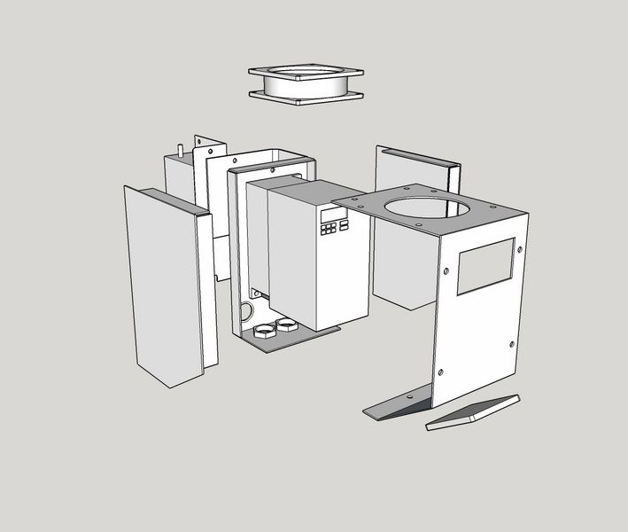

                                                      On the drill though I fancy making it "self contained". ie the inverter mounted on the drill. Given this inverter is pretty compact I reckon I can put it on the left hand side where the e-stop used to be.
                                                      To this end I have spent a few hours learning sketchup and modelling what it might look like. This is the result so far:
                                                      It has a fan on top as there will be little airflow in the enclosure and the fan will have a dust filter to stop swarf etc falling through! The square block on the lower front diagonal is another fan dust filter used as an air inlet filter.
                                                      The emc filter is external on the back but there will be a cover over the top to protect the mains in terminals.
                                                      This will probably change as I build it but it was fun modelling it
                                                      First job though is to lash up the inverter on a bit of ply to check everything works!
