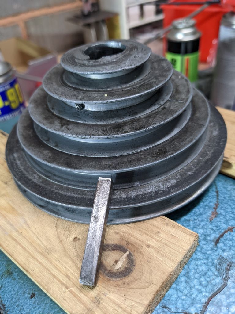

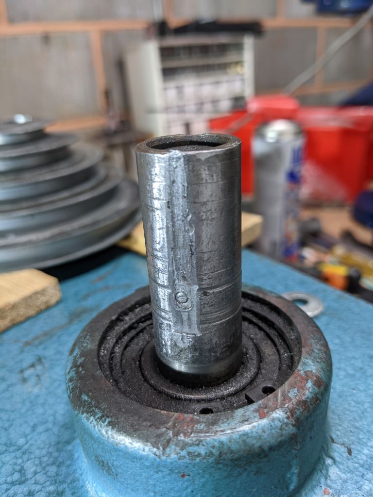

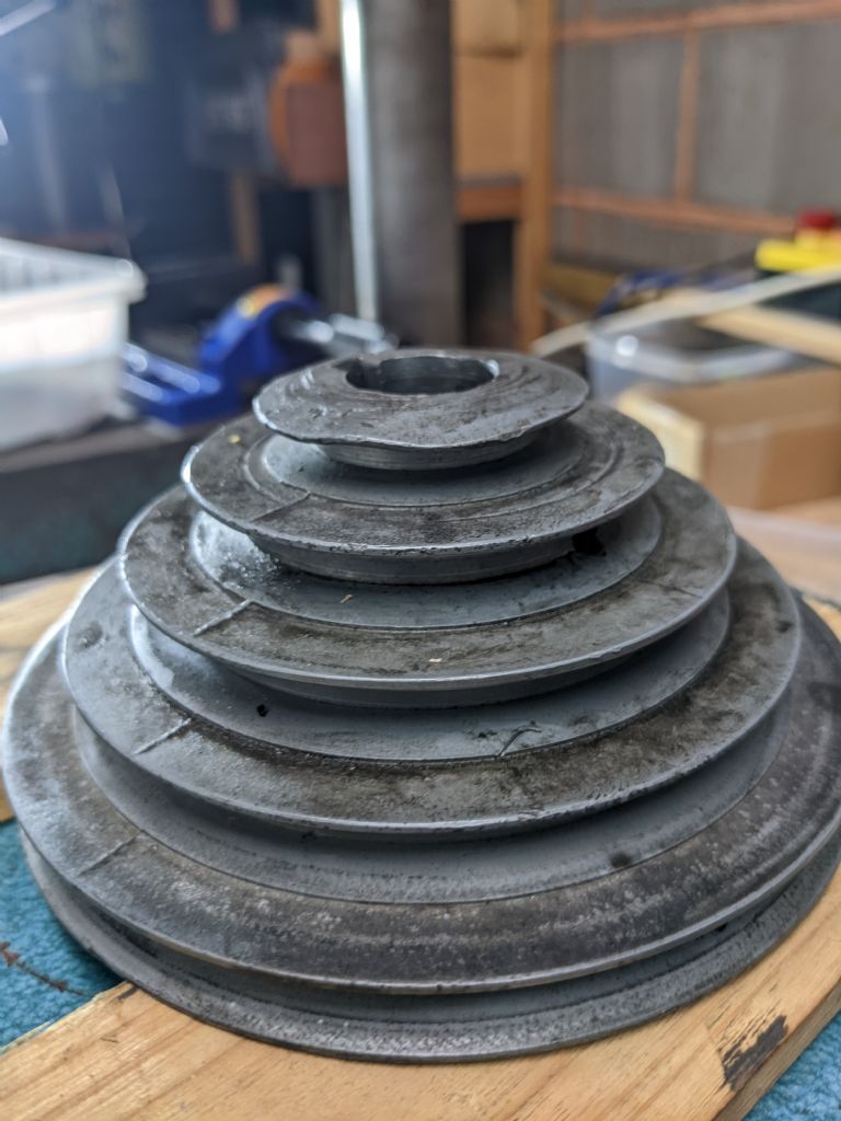

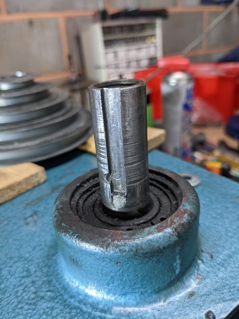

The main problem is the spindle pulley and axle. The pulley it is off centre on rotation and also not square on the axle when the square pin is tapped in place, when the pin is not in the is a fair bit of play for the pulley to wiggle on the axle. See pictures.
My experience with spline axels and pulleys is limited and they have all been snug fits. Centred and square on the axel by the fit of the bore, easy drop in of the square pin, tighten set screw(s) – all good. So how bad is this? Replace or refurbish with a bush? Note: I don't have a lathe, a milling machine or the skills to do a refurbish.
