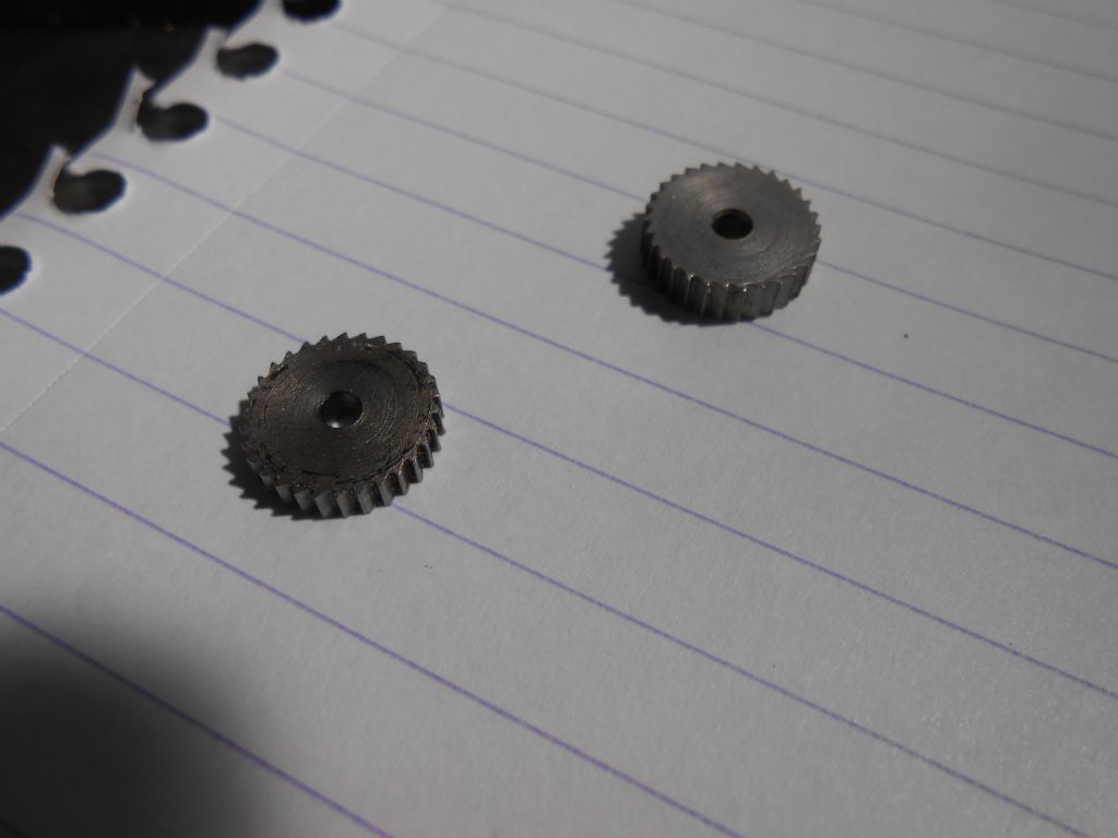

        I purchased a couple of 7/16" x 30 tooth wheels, I want fit them to an 8 BA spindle. The problem is the hole in the centre of the wheel 0,090" which is too big for 8 BA, the easy option would be to drill the centre hole out and fit a brass bush then drill and tap it 8 BA. The problem is the wheels appears to be case hardened and does not want to be drilled. Has anybody come across these wheels ?

          Do the wheels need to be hardened? If not, anneal them. Alternatively grind off the case hardening or get a drill/cutter suitable for cutting hardened steel.

                You could anneal, drill and then reharden. Press or Loctite the bush in once hardened.

                  If the wheels are case hardened would they anneal ? They are a dull grey colour so I assume they are not made of silver steel, machined then hardened.

                    I have no way of knowing for sure, but that sounds like they might be sintered … in which case, I wish you luck.
                    … could you post a close-up photo ?

                      Michael I think you may be right with the sintered suggestion. Looks like the spindle will have to be a push fit into the central hole in the wheel.

                        Ratchet wheels
                        One old wheel one new, Neither will allow a drill to enlarge the central hole which is 0.090" I have ordered some 3/32" En1a rod to make a new press fir spindle.

                          They are not hard to make from silver steel with a simple single point tool.

                            Not quite answering the question, but lubricator ratchet wheels are very easy to make from silver steel and some simple tooling. A suitably ground HSS toolbit in the lathe will readily cut the teeth by traversing the saddle.
                            Division can be by means of a change wheel and detent mounted at the LH end of the mandrel, or possibly using the bull wheel on some lathes.
                            After parting off, the wheel is hardened & tempered back slightly.
