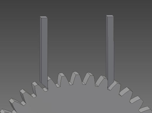

      If you have a gear and need to replace it or match to it (for example to make a missing change gear for your lathe) here is how to do it.
      (Most of this isn't new, but I think that the pressure angle table is)
      There are two main standards for gears, imperial and metric.
      To buy or make a gear you need the number of teeth (N) the tooth size (DP or MOD) and the pressure angle (PA).
      PA is generally 20° in modern applications, but was generally 14.5° early in the 20th century, and could be either mid-century.
      Designers use the Pitch Circle Diameter (PCD) to design geartrains, but that's in the middle of the teeth and can't be directly measured.
      For metric (module, or mod) gears the PCD is N x MOD
      For imperial (DP) the PCD is N / DP.
      The OD of a gear is the PCD + the "Addendum" which is normally 1 module (or 1" / DP) per tooth, so 2 modules extra on diameter.
      So, to identify a gear.
      1) Count the teeth. = N
      2) Measure the OD in mm and divide by (N + 2) = MOD
      3) Divide (N + 2) by the OD in inches = DP
      4) DP is generally an even number, MOD is usually an integer down to 3, then goes by 0.5, 0.25 or 0.1. Pick the most likely.
      4a) Gears can be "profile shifted" to improve the geometry when the ratio is large, or if the centre distance is critical, and not easy to change. Note this deviation from the theoretical OD.
      5) (The main point of this email) To measure the Pressure Angle (PA) measure the span across the flanks of 4 teeth (or 3 on a smaller tooth-count gear) with a digital caliper and zero it.
      Then measure the span over 1 fewer teeth, and over one more teeth. That should give the same number both times (one being negative, of course.) Refer to the table below to determine the most likely PA.
      ->VVVV<- would be the span over 4 teeth. The caliper jaws need to be on the sides of the teeth, not the tip.

                Cooincidentally I gave the PA measurement/calculation method a try on my 14DP gears just a few days back. I found it impossible to get a usable answer just using the calipers and formula. As your table shows, the difference between 20 and 14.5 degrees is a little over 0.2mm. My measurement error was a good deal more than this because I could only get the very tip of the calipers between the teeth at the root and things were further thrown into doubt by the radius at the root. I didn't get an answer from the formula because I ended up with a 'cosine' number of more than 1.
                I found this thread which suggests a couple of other bits of 'evidence' including the age of the machine and the appearance of the root area…
                https://www.practicalmachinist.com/vb/general-archive/measuring-pressure-angle-spur-gears-74835/
                Starting with the possible answers (as per your post) to the calculation was somewhat more useful – I guesstimated the root pitch using a steel rule (measuring just one tooth and gap) and decided whether it was closer to the higher or lower figure.
                So all things considered I concluded that my Faircut 14DP gears are more likely 14.5 degrees PA.

                  Use a disc micrometer.
                  The underlying maths is simple. The disc micrometer will measure the distance across the teeth, but not on the pitch circle diameter. By varying the number of teeth the exact point of measurement will vary. The thickness of a tooth, away from the pitch circle diameter, is determined by the pressure angle. So by comparing the results to the theoretical values the pressure angle can be determined.

                      I'm not sure how to measure the span across the flanks. Are the tips of the caliper presented to the circumference of the gear, which will measure the span fairly high up the tooth, or to the side of the gear where the span can be measured fairly close to the root?
                      The measurement should be tangent to the tooth flanks. As long as it isn't wedged deep in the root or teetering on the tip the measurement should be the same.

                        It is measuring "Basic Pitch".
                        I have an excel spreadsheet that does basic gear calculations, and one thing it gives is a "span across N" which can be used to check when the hobbing process has cut deep enough.
                        I found a reference online that mentioned using the difference between two spans to determine PA, but that only had an equation.
                        I used my spreadsheet to calculate the numbers for the range of gears shown

                                Another method, assuming involute teeth:
                                Take some plasticine or other softish clay like material, create a small block on a flat surface and then roll the gear over it.
                                The matching rack form is then created and the pressure angle can be measured directly with a protractor from the sides of the flanks.
