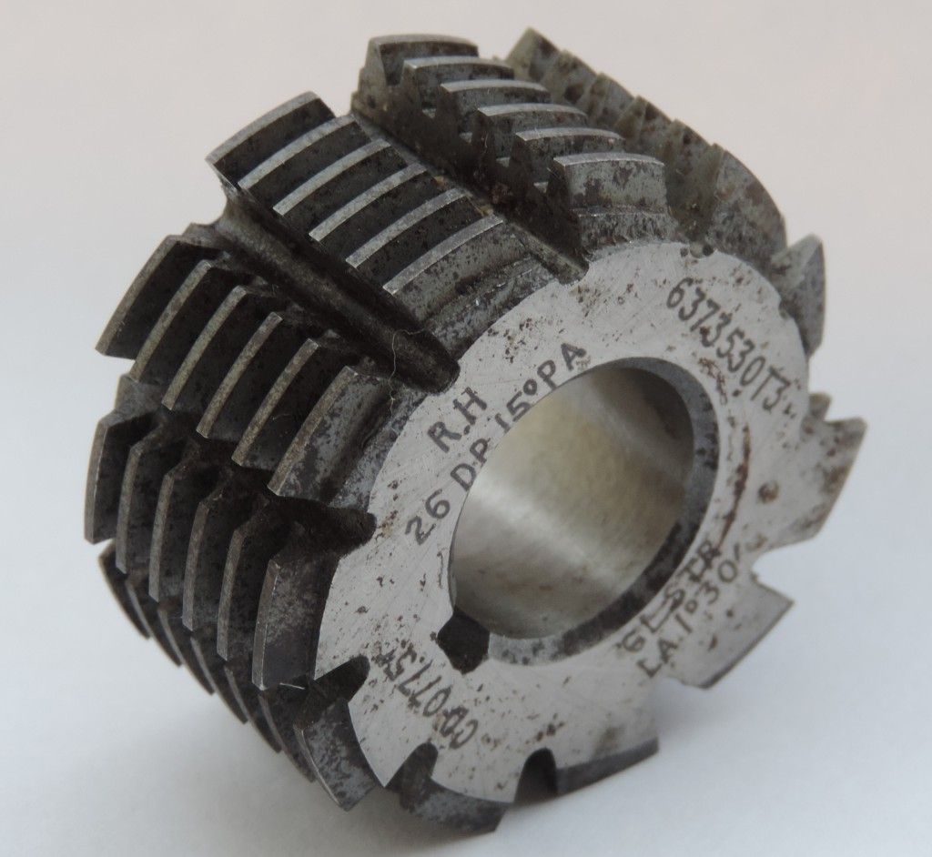

                            John Stevenson 1
                              @johnstevenson1
                              That link only works if the gear is a standard gear and follows all the text book formulae. As soon as you modify one thing that pin method goes out of the window.
                              These three gears are all the same OD, they have all been hobbed with the same hob but only the 22T is a correct text book gear. The 20 and 21 have been corrected so they will interchange between any shown.
                              The 20 and 21 will not measure correctly across pins but all three will give the same PA [ 20 degrees BTW ] when rolled into blue-tak or plasticine.

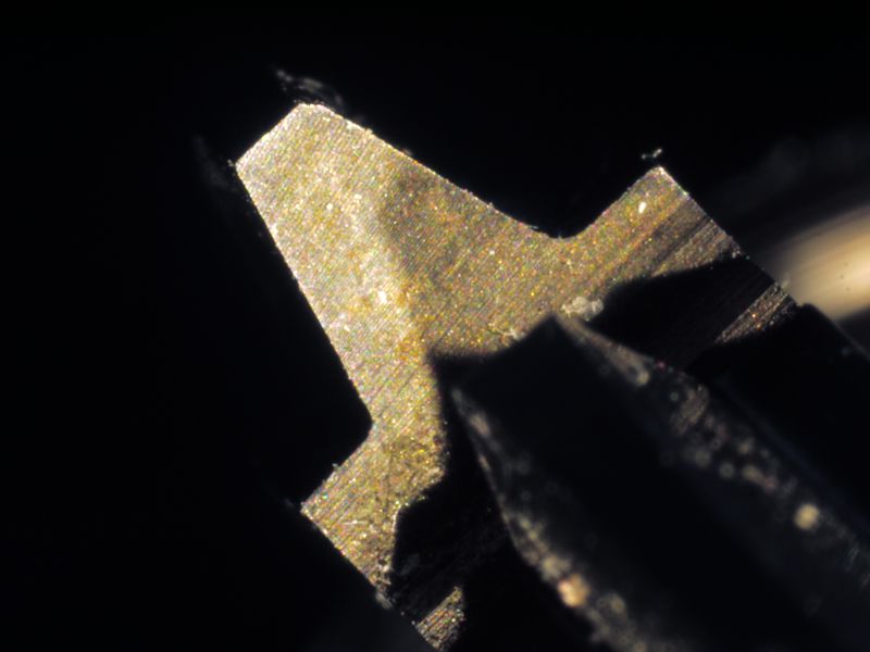

                                                    Posted by Adam Harris on 19/03/2015 11:44:40:
                                                    … Since the gear is quite thick I cannot see how a photo could produce an accurate 2D image.
                                                    Adam,
                                                    Just returning to this comment in your original post. ^^^
                                                    [unless the gear has chamfered ends, which could make it tricky] … If you can photograph the gear exactly end-on, there should be no problem: The combination of perspective and depth of field will hide most of the confusing details, and it is a simple matter to identify the edges on the plane surface.
                                                    The worst you are likely to get is some lens distortion [barrel, or pincushion], but you can easily check the performance of the lens by photographing a sheet of graph paper.
                                                    Alternatively, as I said before; if it's flat, put it on a flat-bed scanner.
                                                    P.S. … Here is a photo that I took a while back; showing one tooth of a cutter … The lighting was awkward, but the image is certainly fit-for-purpose.wormform_tooth.jpg
