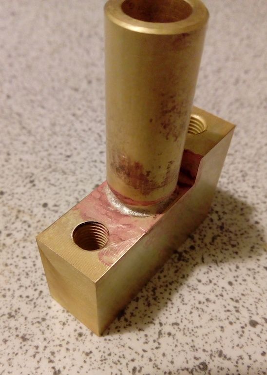

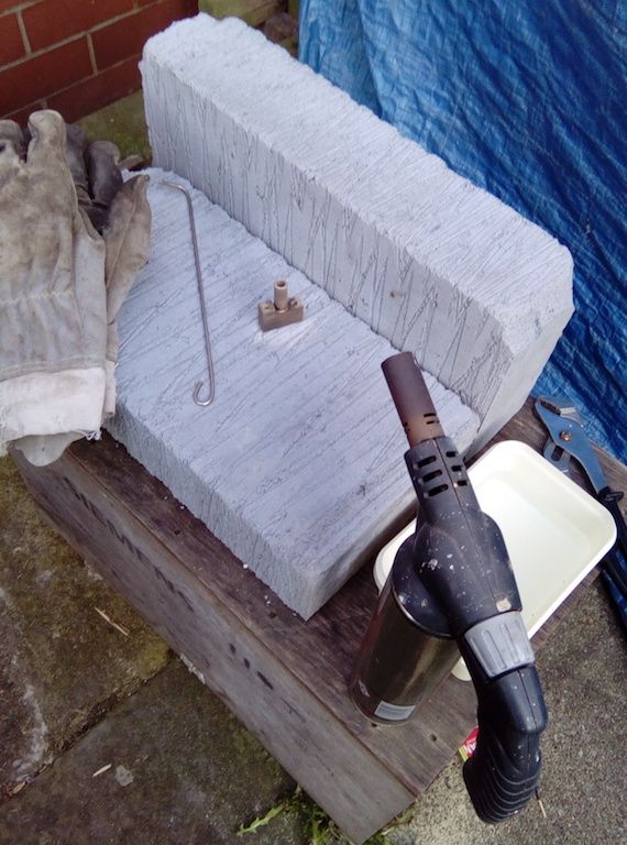

                                      As a soldering novice I'm hoping to get a little bit of advice:
                                      I have just completed the first big soldering job on the ME Vertical Boiler – soldering the fire tubes, bushes and stays to the smoke-box end plate.
                                      All the joints seem to be sound with good fillets – but I have a bit of a problem with one of the bushes: solder appears to have found its way down the thread between the bush and the thread protection plug – soldering the plug into the bush.
                                      Any ideas as to the best way is to rectify this?
                                      Regards
                                      Dom

                                          Were the protection plugs made with a small hole in them – then if they did get soldered in theres a guide hole to drill them out and run a tap through.
                                          Other wise drill out and fit a new bush – put some tippex (typist correction fluid) on the thread that usually stops the solder creeping .
                                          Pete

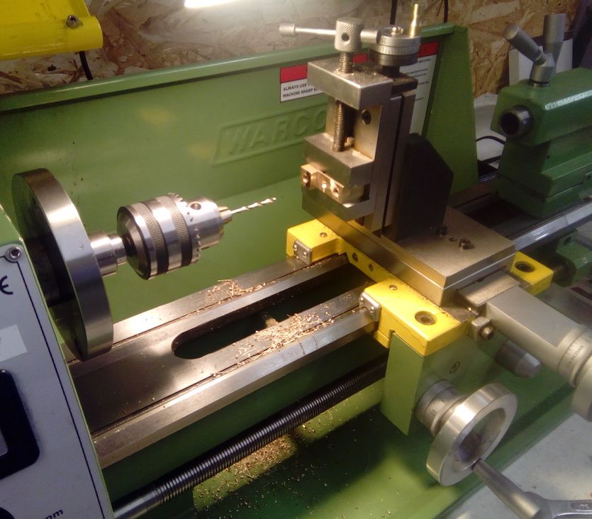

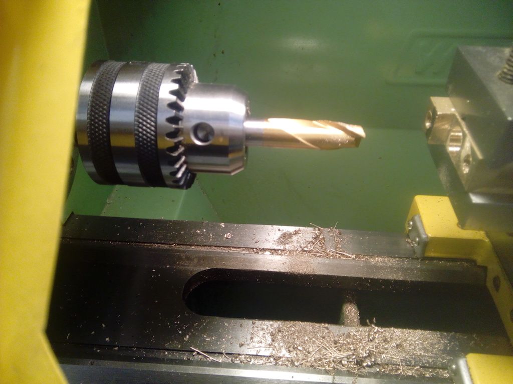

                                          Dominic Bramley
                                            @dominicbramley60728
                                            Many thanks for the replies – sounds like drilling is the way to go.
                                            I don't have a pilot hole in the plug – it just has a screw head.
                                            Do you think it would be feasible to turn down a guide for a drill though? One side reamed to fit over the proud portion of the plug and the other to accept a spot drill to make a pilot hole on centre?
                                            Having got the fire tubes soldered OK I'm keen to avoid applying any more heat to that end!
                                            Regards
                                            Dom

                                              Dominic Bramley
                                                Quick update: the drilling guide jig worked perfectly and I was able to drill out the plug and re-tap the bush.
                                                Many thanks Bill and Peter for the pointers yes
                                                Dom
