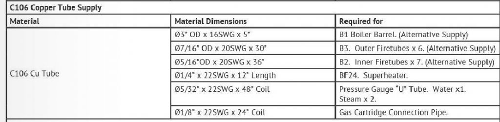

                                  As welll as the following tubes you wil need a piece of 16swg C106 copper sheet 4" x 12"
                                  #346694

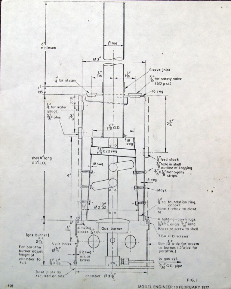

                                            I find the materials list interesting.
                                            I know very little about boiler design and cannot visualise the internal layout of this boiler from the list.
                                            Can anyone explain to me what the arrangement is LIKELY to be inside the 3" diameter shell.
                                            I've been looking at the 3" Tubal Cain vertical boiler in M.E. feb/april 1977 and it would appear from the materials list that the internal structure of the current M.E. Boiler is completely different. The Tubal Cain design has conical firebox with 3 crossing and angled fire tubes.
                                            Issue numbers 3555 to 3558 over a period of 6 weeks cover the whole design with detailed and informative diagrams and building notes all aimed at the beginner to boiler making making their first boiler.
                                            geoff
                                            #346728
                                              I think it will have a flanged plate at the bottom and a second flanged plate about 1" down from the top. one ring of 5/16" tubes running vertically and an outer ring of 7/16" tubes running vertically. Heat will pass up through the firetubes into the space at the top and then out up the chimney. Don't think this is a centre flue boiler like the TC one.
                                              Edited By JasonB on 19/03/2018 16:15:05

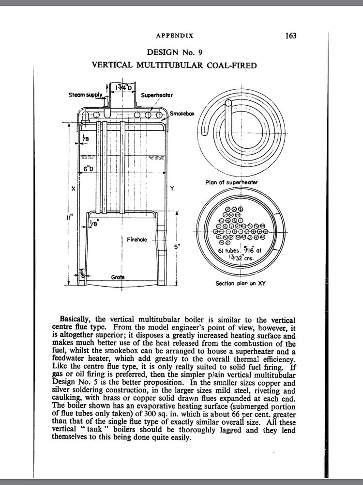

                                                I found a similar design on the internet. A coal fired example but with the fire hole and grate removed much like your drawing. It also shows a super heater coil which is specified in the M.E. boiler material list.
                                                For the M.E. boiler this would probably tubal cain boiler.jpglocate in the space above the tubes in your drawing.
                                                I would say the Tubal cain design may well be my best option as it looks a to be a simpler construction and therefore a better option as my first boiler build.
                                                I'm certainly ready to go, new sievert torch, gas bottle and a second hand brazing hearth with a rotary table. The hearth,table and fire bricks believe it or were being thrown out by my local secondary school. I had rescue it from the schools rubbish skip
                                                Thanks again geoff
                                                #346740
                                                  I would say the ME one if as per my sketch would be far easier as a first build than either of those two. The main reason is that the beginner can get at to all the soldered joints and it is easy to see if the solder has flowed correctly. The other boilers will require several heats and you will be hard pushed to see if a later heat has affected some of the earlier joints
                                                  #346754
                                                  nigel jones 5
                                                    @nigeljones5
                                                    Whoever designed the boiler in the top picture did it for an April fool. You would be hard pressed to design one so ill thought out even if you tried! Why has it got stays down the barrell? (perhaps its square section???) and where did the burner design come from? At least it goes some way to explaining all the holes in the bottom smile p
