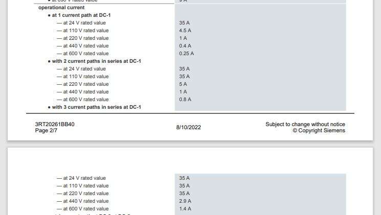

                        Arc formation and extinguishing is a wide an complicated subject. Materials, geometry and polarity all have influences. There are various voltage thresholds for starting an arc without contact, sustaining an arc and extinguishing an arc.
                        To move to practical examples: Automotive systems have used 24V DC for decades with no special consideration given to arcing at the contacts or the design of fuses for arc suppression. Battery powered fork lift trucks and pallet truck typically operated at a maximum of 48 V  which kept them in the ELV category (Extra Low Voltage so no special requirements for avoiding human with the conductors) and did not use any special form of contactor with arc suppression. Large traction systems like tramways operated  at 600 -750V DC and used various arc suppression techniques, arc chutes, magnetic blow out coils etc.
                        For references this white paper notes:
                        “Introduction, In the race to electrify their vehicle designs, engineers may encounter applications having DC voltages higher than they are used to seeing. At these moderately higher voltages (48 to 1800 V), a properly selected contactor electrical relay can mean the difference between catastrophic failure and success. A proper system design will reduce the risk of a relay erupting, starting a fire, or disabling a critical function. Considerations include the relay technology, key specifications, and special problems of high-voltage DC applications.”
                        https://www.littelfuse.com/media?resourcetype=white-papers&itemid=73a198d0-1424-41d3-bee5-285a8d95f219&filename=dc-contactor-relays-white-paper
                        So problems are expected to start above 48V.
                        This Siemens contactor (taken as a random example) is rated 35A at 24V DC which drops to 4.5A at 110V DC for a single contact. If 2 contacts are connected in series, so 55V per contact, 35 A is again possible. With three contacts in series 35A is possible at 220V DC so around 70V per contact.
                        https://docs.rs-online.com/83df/0900766b814bb78c.pdf
                        Siemens Ratings
