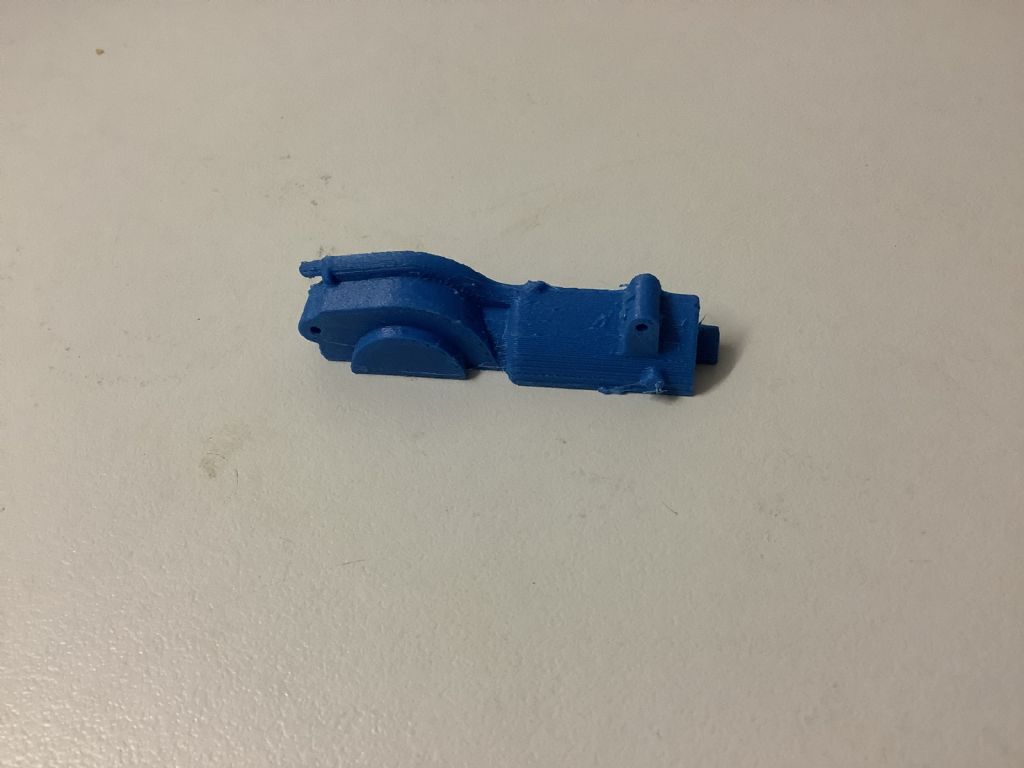

                      #552357
                      Four stroke Fred
                        @fourstrokefred
                        Good idea Jon.

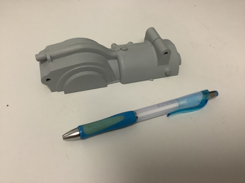

                        A quick quarter scale 3D print of the lower half pattern – should work when made as a full size pattern.
                        Fred
                        #552836
                        Four stroke Fred
                          @fourstrokefred
                          Engine development continues. The photo shows 2 of the half size patterns for the lower half of the engine and are being used to check out any problems before printing the full size patterns thus saving both time and materials. I will test them in the chemically bound sand to see what happens! When I have finished with the full set of this small size of pattern I will glue them together, add more details, paint and mount it on a stand and present it to the farmer in appreciation of the access to the full size tractor. The not such good news is that I have had to return my new 3D printer and have had to resort to my faithful smaller “ Up + 2 “printer and glue parts together. The new printer has a work area x4 the size of the small one but the old one has not missed a beat in all the years I have owned it. In the next few days I will print the top half of the above small patterns and play in the sand!
                          Fred.

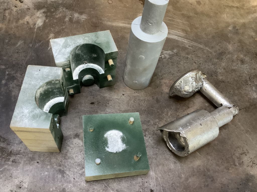

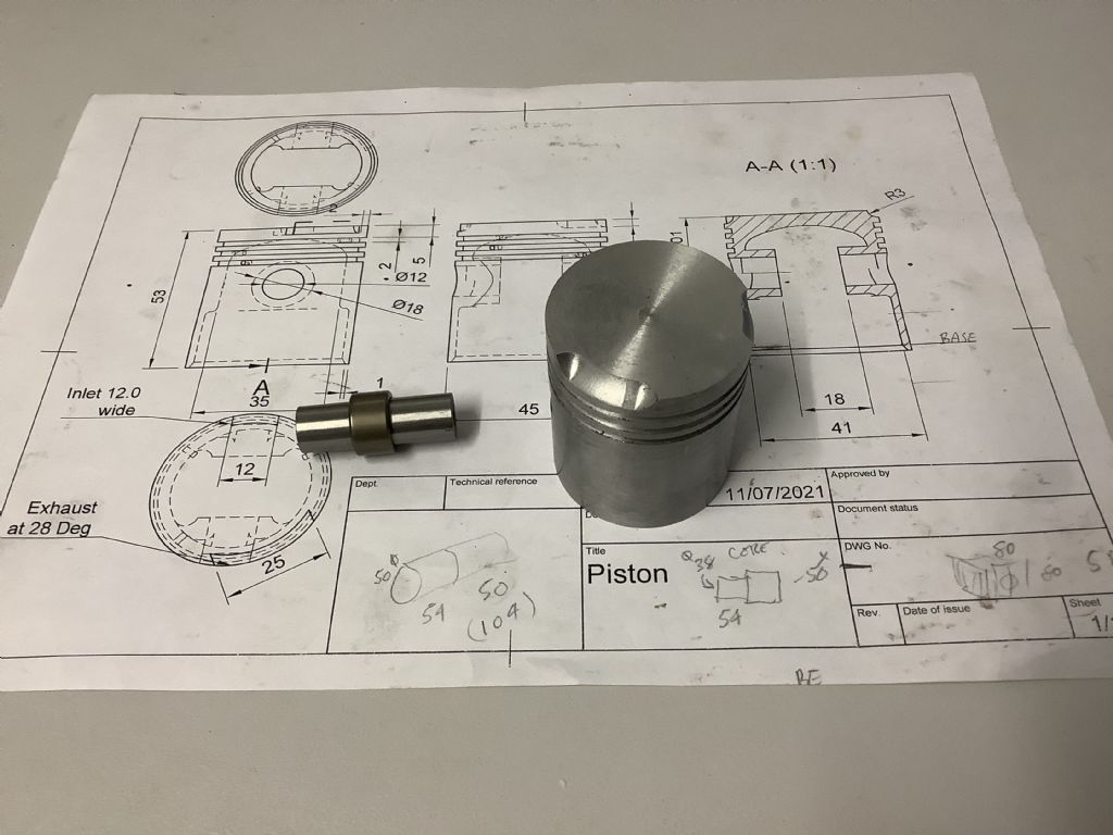

                                Today I cast the piston as shown in the photo using a resin for the core sand and Petrabond sand for the flask. The 3D printer was returned but with out the power lead and instruction book! Tomorrow’s task is to set up the printer and also machine the piston and fit the rings. I can see that casting the cylinder/ crankcase is going to be difficult and expect that not all the attempts will be successful. Each attempt will be part of the continuing learning curve.

                                    I now have a working 3D printer and over the weekend hope to print some of the major patterns for the engine. Today I cast 3 pistons but had to reject one as it had a flaw caused by using too much resin in the mix. This created a gas bubble inside the piston and rendered it u.s. Tomorrow I will machine one of the castings and fit the gudgeon pin and piston rings.

                                          This is engine part number one. The piston is a flat topped deflector ( if there is such a thing) with the two cutouts being the deflectors for the gasses. Although I have the laser cut connecting rod I am going to try casting one in aluminium in order to reduce the weight factor. I am also giving some thought to the reed valve induction set up. I do have a an old Frog 149 cc model diesel engine with what was called “vibramatic” induction and will have a good look at that for ideas.

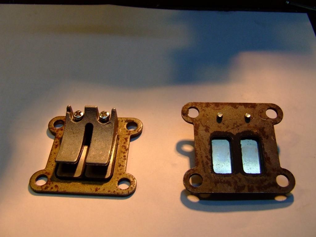

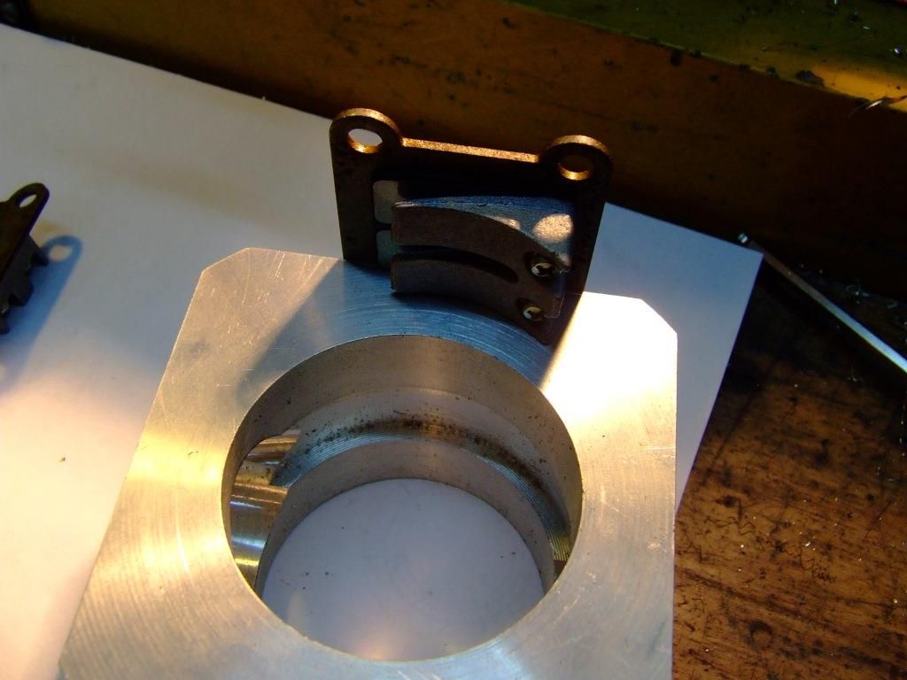

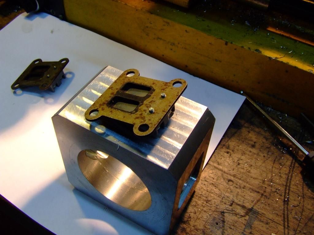

                                            I decided to reduce the doubt for my two stroke diesel by using a commercial reed valve from a moped/scooter. This was not expensive however if you have a dealer/workshop near you you could see the various sizes and shapes available.

                                              Thanks for the email. I did visit my local motorcycle shop and after explaining what I was after and what it would be used for they donated me a set of small Boyesen reed valves. What capacity is your engine? The tractor engine will be 79.5cc and hopefully the revs will be quite low as it has a heavy flywheel to carry the moment through.

                                                My engine is only 20cc so those valves are a bit big but that will hopefully help the volumetric efficiency.

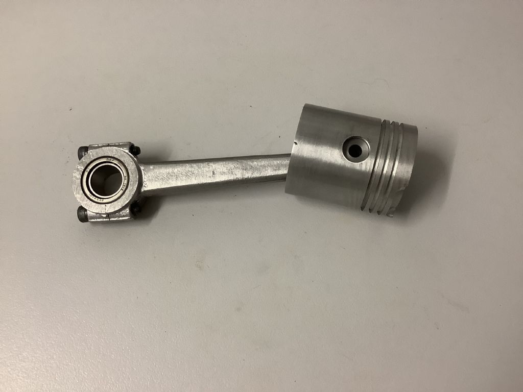

                                                Four stroke Fred
                                                  @fourstrokefred
                                                  This is the cast aluminium connecting rod and the piston. I recycled an old Briggs and Stratton con rod and hopefully by not over heating it in the crucible I may have retained the metals characteristics. The big end bearing is a needle roller running on a hardened and ground sleeve and the small end also uses a needle roller but it runs on a heat treated silver steel gudgeon pin. The pattern for the crankcase /cylinder is in 8 parts and when made will be glued together to form 4 quarters. Each of the 8 parts will take 6+ hours to print on the 3D printer but that’s next weeks project.
                                                  Fred.
