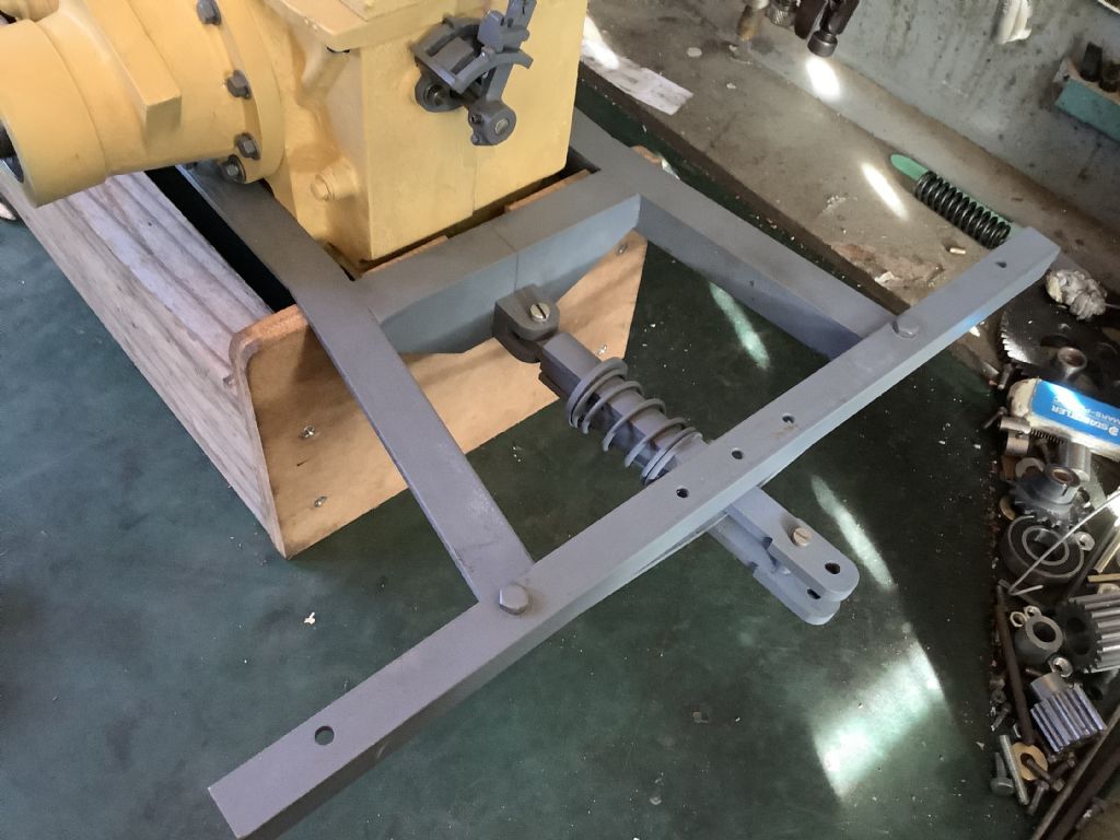

      1858cc48-baa9-4a55-a3b2-3bcad16c11a8.jpeg8f2ca7b5-eebc-45a9-9afa-186f6ffc8870.jpegThe photographs show the shock absorbing tow bar and the structure that supports the platform on which the driver stands. The second photo shows the component parts for the rear wheel hubs. The parts at the front have all be cut by laser having drawn them on Fusion 360. The scalloped grooves on the left hand hub are for short rods that will be silver soldered in place and will be later drilled for wheel retaining bolts. The central hub parts have a taper for a collet but still require shaping externally and after the spoke plates have been bent to the correct angle the total hub can then be assembled. It sounds easy when you rewrite it down and I hope it goes together as planned!
      Fred.

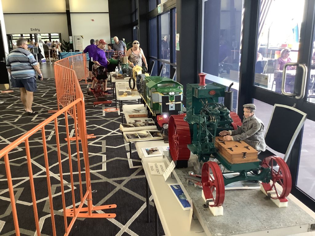

                Over the weekend I had a visitor to the workshop and on seeing the tractors, boats, I.C and steam engines on display asked ” “where do you get the instructions from to make these ?” I had to inform him that they were home designed and made and that I had spent 17 hours so far photographing and measuring up the Mc Donald tractor and as for instruction you make it up as you go along. As you work on one part you are thinking of the next part and how they will relate to each other. The rear wheel hubs have now been turned down to size and will soon be ready for silver soldering. I have now checked the angle that the spokes have to be bent to and will make a jig for this repetitive exercise. Photo shows milling the pockets in the rear hub – as it was not a full circle great care was needed!
                Fred.

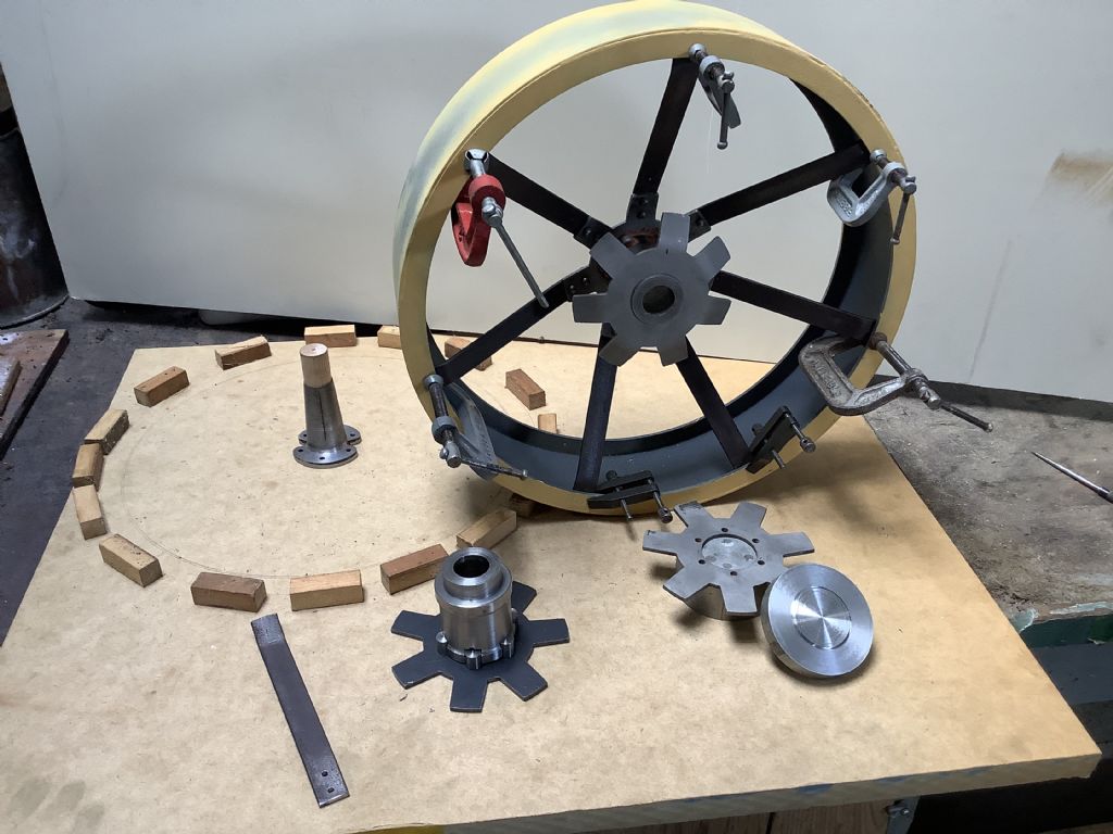

                      The photo shows one of the rear wheels under construction and also the hub parts for the second wheel. I made up a wooden jig on which to build the unit as this enables me to centralise the hub to the rim and also give the correct offset from the outside of the wheel. It’s the sort of job where you need octopus hands and you need to plan out the order of work and assembly. The hub was silver soldered up to hold the six pins and one of the spoke plates in place with the second spoke plate being added later. The collet was more difficult to make than expected and again it was planning the order of the processes that was important ( holding the work for slitting and making sure both the taper and parallel bores were accurate). I will drill all the rivet holes before the final assembly and hope that it will all line up and be concentric – may even have to call in my wife to give me a hand and I know she will be thrilled with that!
                      Fred

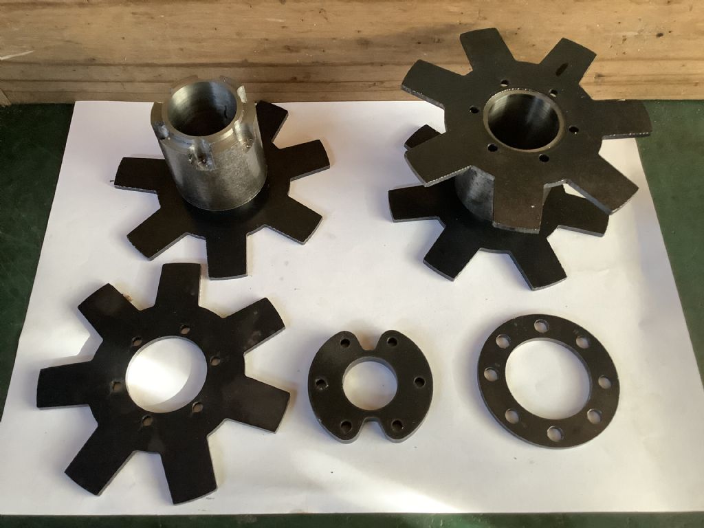

                            One down and one to go – rear wheels that is. The job proved to be more difficult than I anticipated as trying to keep every thing concentric and to size was not easy. The second wheel should not take as long as I have now work out the order of work and made the various jigs and tools. The tractor on which the model is based does not have any form of tread but could be fitted with “ spade lugs” but I am contemplating fitting rubber blocks to offer some form of grip. As autumn is here I have to spend some time preparing the veg garden ready for sowing and as a consequence the second wheel will have to be put on hold for a couple of days. Plenty to think about.
                            Fred.

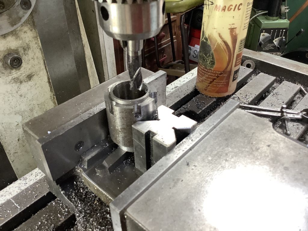

                                      #535952
                                      Four stroke Fred
                                        @fourstrokefred
                                        #535955
                                        Four stroke Fred
                                          @fourstrokefred

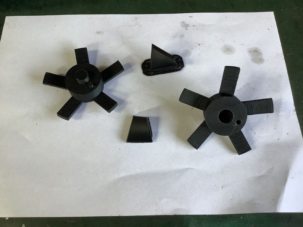

                                          It’s good to be back in the workshop and making bits for the Mc Donald. The show was very good but tiring on the legs and voice. The photographs show progress on the seat and the conical spring that is fitted underneath to give the driver some degree of comfort! The seat was beaten out of 1.0mm steel. The shape was photocopied to scale from a photo and then the slots were cut out with a piercing saw. The shape was beaten down into the wooden block and the raised centre section on the aluminium block with the groove machined into it. The red jig at the front was used to bend down the outer edges before planishing on a stake.The conical spring is made from 2.0mm fence wire (that gives just the right amount of spring) and wound on the tapered mandrel shown. 3.0 mm copper wire is used as a spacer and later peeled off. I had intended to make the second rear wheel but the laser cut parts have not yet arrived. There is still plenty to think about and do.
                                          Fred.

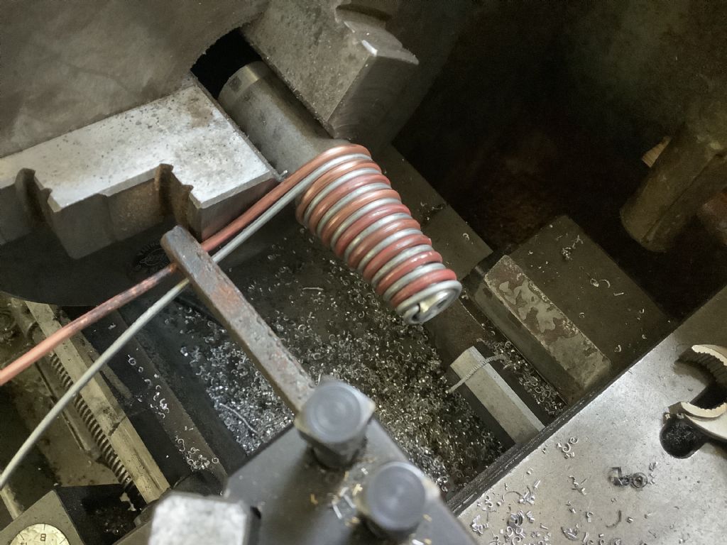

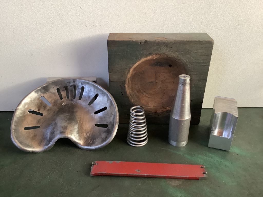

                                          #537196
                                          Four stroke Fred
                                            @fourstrokefred

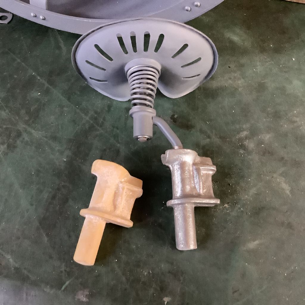

                                            It doesn’t look much for the days of effort that went into making it! The photo shows the small casting and pattern that was used to make it. The finished casting is bolted to the right hand mudguard to hold the seat in position. The seat can be swung through 90 deg to give easier access to the rear of the tractor. There were many “ funny” angles and curves in the shape and I had to make another visit to the tractor to check that the details were correct. At least at the end of the day I achieved what I had set out to do but just as well it wasn’t being costed by the hour! I still haven’t received the laser cut parts for the mudguards but the type of jobs we ask the laser cutter to do are probably more of a nuisance so I do appreciate that fact that he will actually do the work. If any of the readers of this project have any question I will do my best to answer them.
                                            Fred

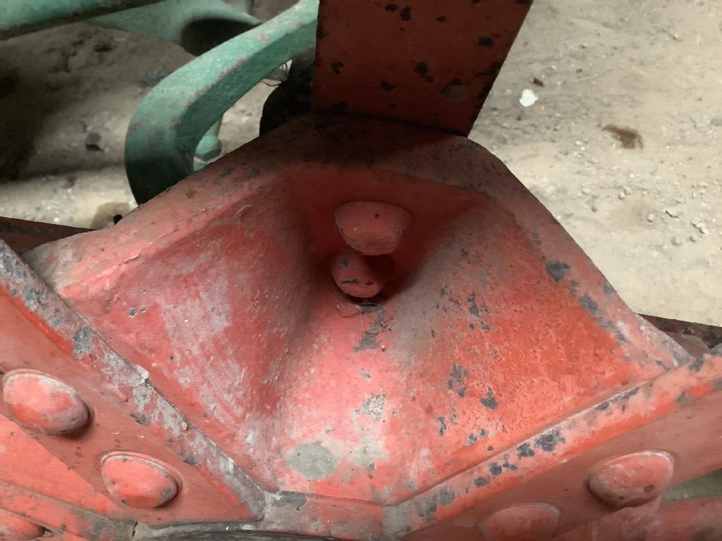

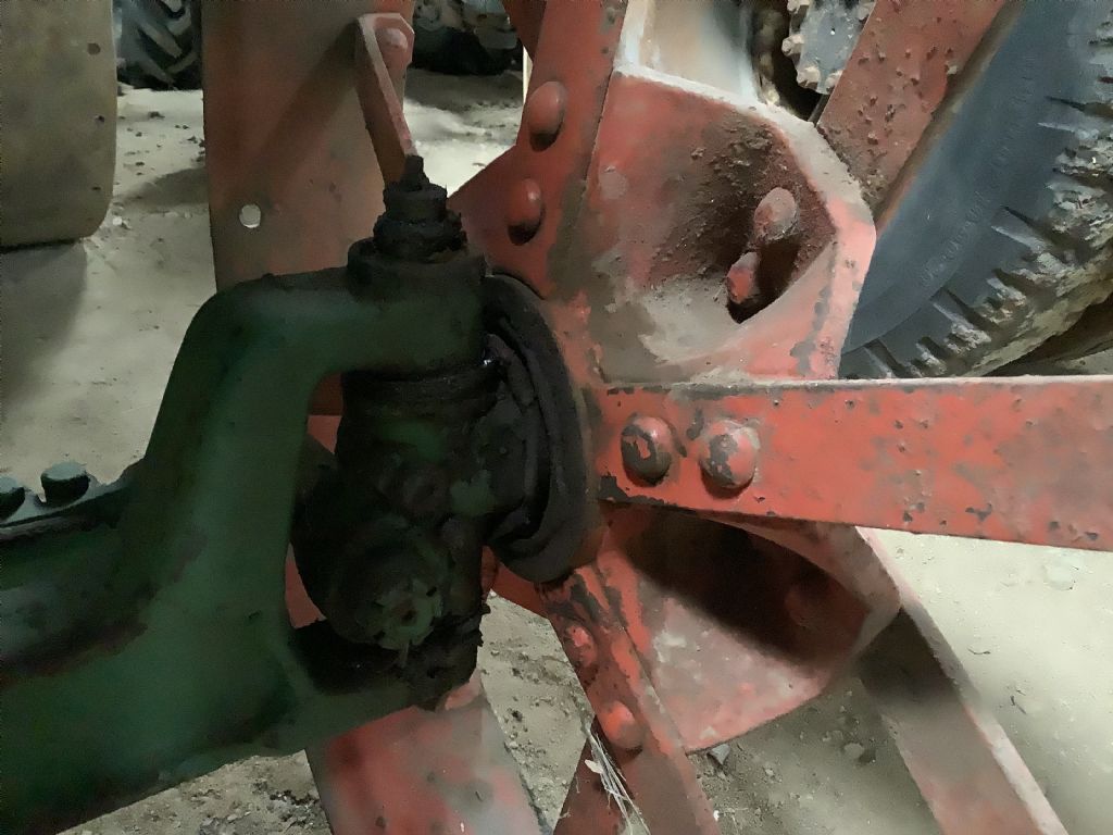

                                                #537757
                                                Four stroke Fred
                                                  @fourstrokefred

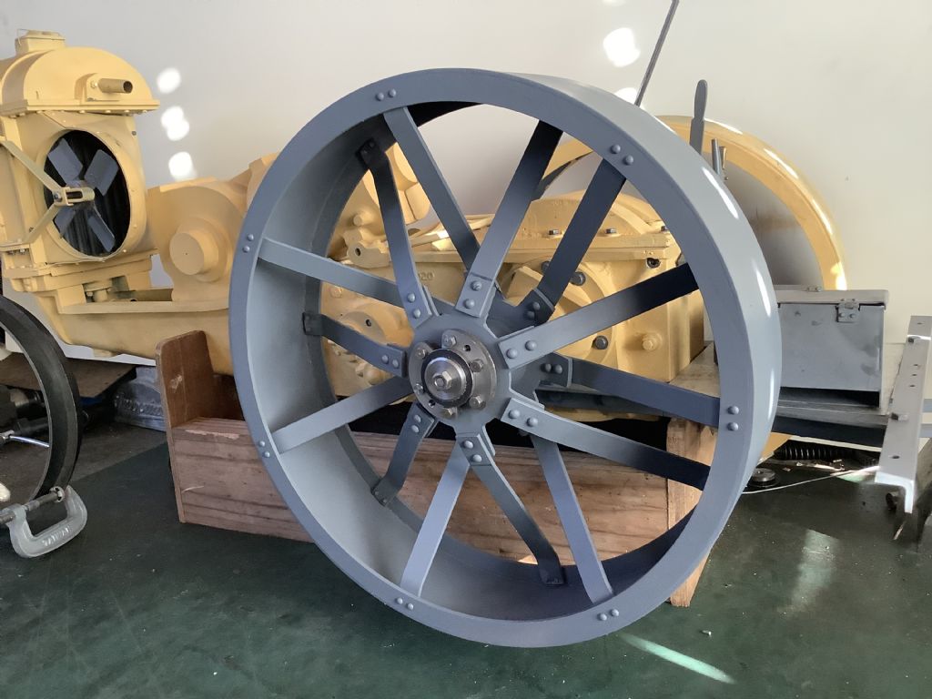

                                                  aba1eee2-861e-4e6b-a573-f593c409fe66.jpegThese photographs show the front wheel full size.3c02dcc5-9058-431c-aa9b-b3a0bfb531ad.jpeg
