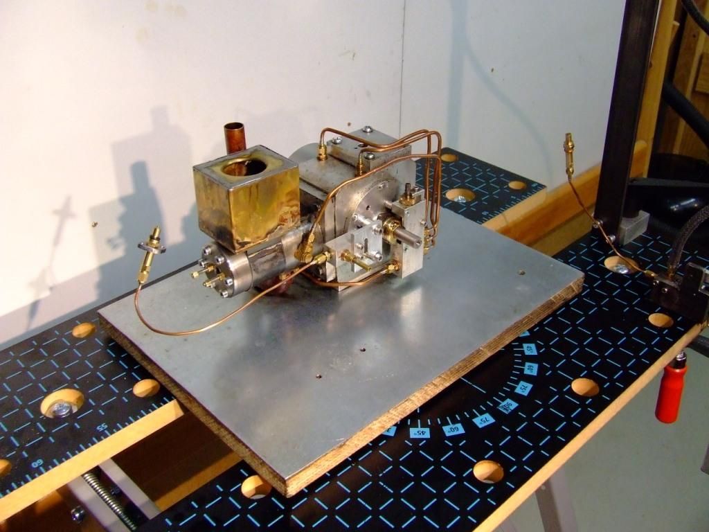

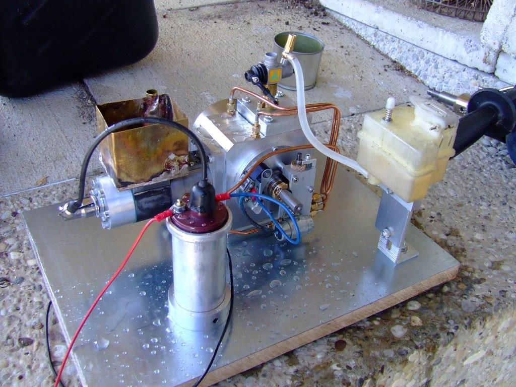

      I am working (very slowly) on a couple of models. One will be powered by a 12cc four stroke twin. I have almost got the engine running to my satisfaction with a constatnt depression carb. The simple carbs tended to struggle when a load was applied. This will be a freelance design.
      The engine on it's test bed
      The second one is based on the Field Marshall horizontal single cylinder two stroke diesel. I am slill learning/experimenting with the injection system. I have acheived some firing but not sustained running.

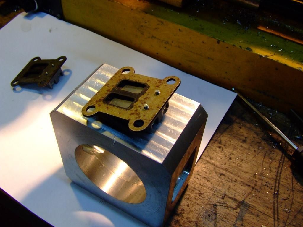

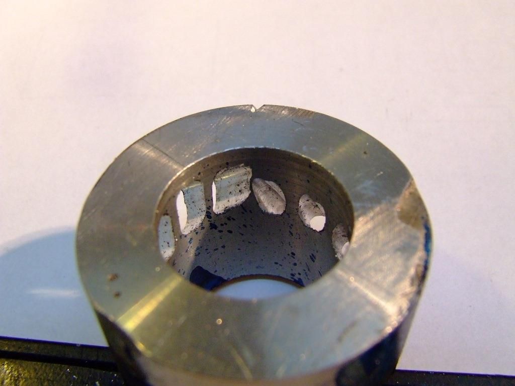

          Thank you smiley This is my first go at a two stroke and bought a number of challenges. The prototype has angled ports, drawing these and the susequent maching was interesting. I strarted with an aluminium piece with the same dimensions as the cylinder but much shorter. This gave me a chance to see what was going on and reduced the amount of scrap. Using small long series milling cutters results in some deflection.
          I cheated with the reed valves and bought a comercial set (spare part for a scooter, less than £2) which fitted in the space that I had.
          I initially ran the engine as a spark ignition petrol engine to confirm that the red valves and ports actually worked.

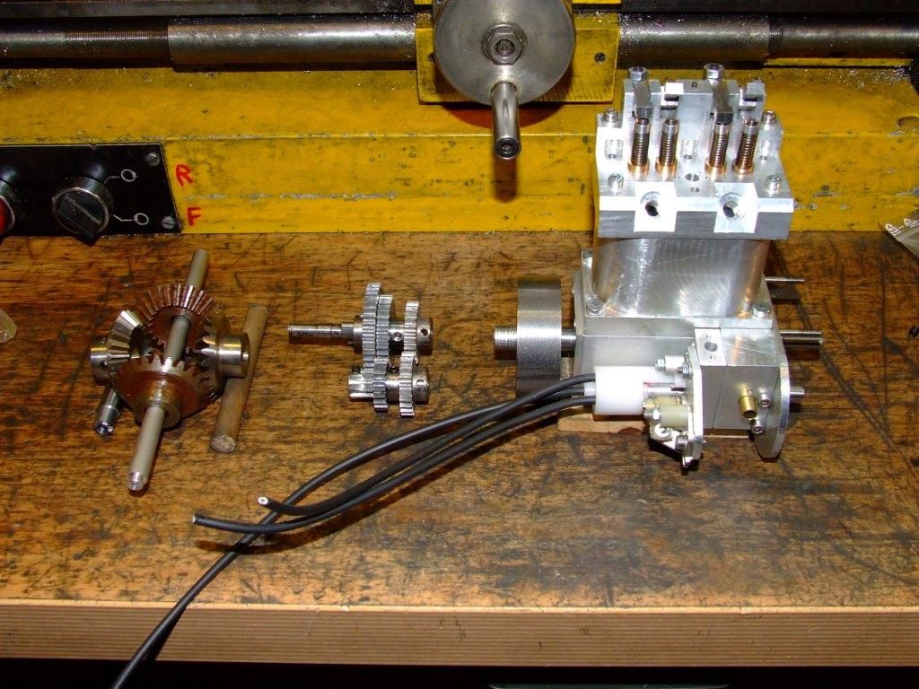

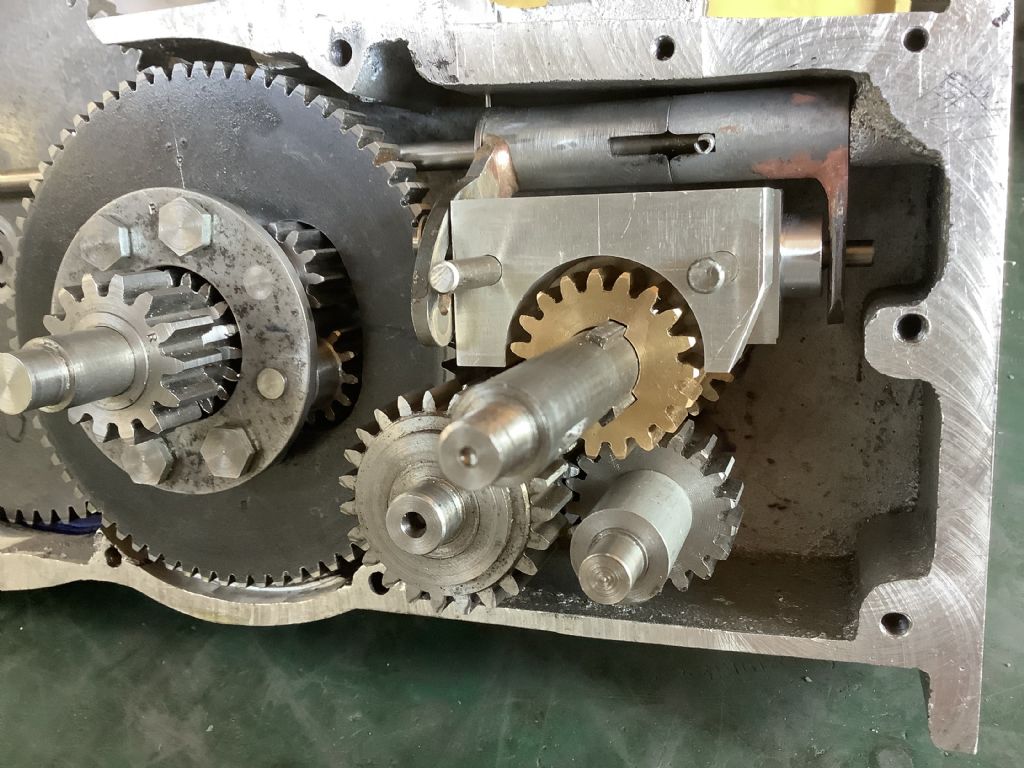

            The last couple of weeks has been spent making the gearbox internals and now the white 3D printed parts have been replaced by metal items. I did change the selector mechanism as it was becoming over crowded at the front end. Working out all the movements of the selectors and mating them to both the gears and the “gate” at the rear was quite a fiddle. As designed the gears would not match the “gate” on the full sized tractor and that would never do!
            Fred.

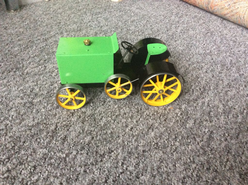

                7f857c8d-f6a1-46ce-8b23-ee911ea3e571.jpegMy version !😃 well almost .Steam Powered similar size to a Mamod tractor.
                #522297
                Jeff Dayman
                  @jeffdayman43397
                  they look great Tony, good fun!

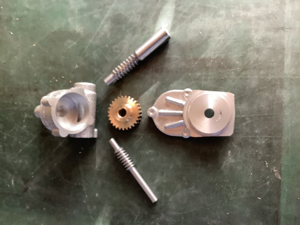

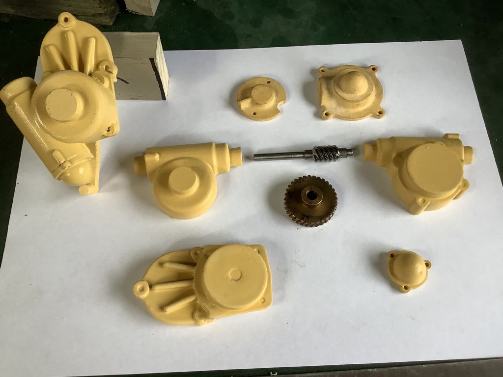

                        This week I have designed and made the patterns for the steering gearbox and also the two small side covers for the left hand side of the gearbox. The photo shows the complete 3D printed steering box in the top left, the four start worm and worm wheel and the other small patterns ready for casting.I have been using the metal from hard drive cases as these have been die cast and when melted down seem to flow well. The next stage will be machining up and then fitting the parts.

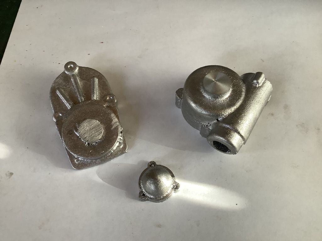

                            ed73594e-4932-4e98-ba72-e1030a5adbe3.jpegYesterday they were patterns and today they are castings and tomorrow I hope to machine them up and fit them to the gearbox. These castings still need some cleaning up but appear to be ok. With the air temperature in the 30Cs and the furnace going full blast it was a hot job.

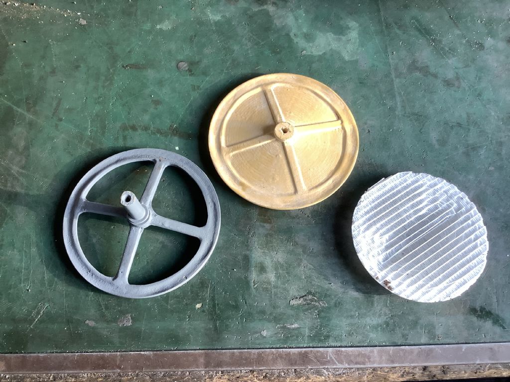

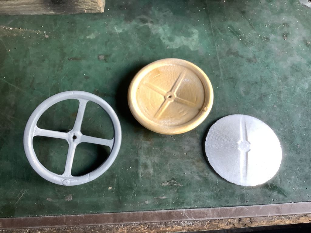

                                b191e157-1d85-40ea-93d2-b4e23f52ff5f.jpegThis week I cast the steering wheel in aluminium having made the pattern on the 3D printer. As the wheel is dished this caused some head scratching when casting. When the print was made I included a thin membrane to separate the two sand layers – this would also allow the metal to flow over the whole wheel and was cut out when the casting was made. The photo shows the steering wheel on the left, the pattern in the centre and a support cone that the 3D printer makes to support the print – this being used in the casting process.3ac6d528-d529-49f3-9c6b-9fa09bca1ecc.jpeg

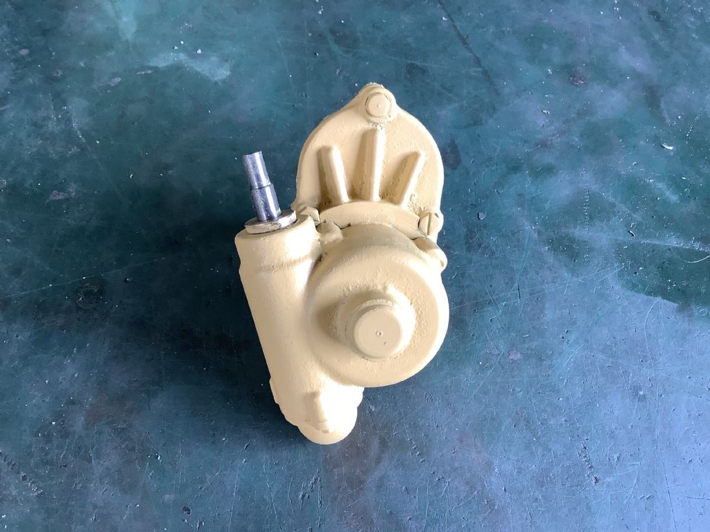

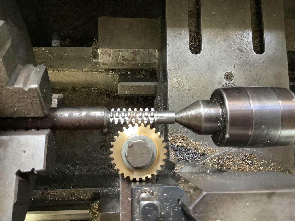

                                              5cf8c32b-2909-463e-ac3f-91f431f29c4b.jpegToday I worked on the steering box gears including making the hob and hobbling the worm wheel. Photographs show progress. It was a steep learning curve but satisfying to think that I didn’t have to buy them after all. I may have to hob the gear wheel a little more but that’s for tomorrow

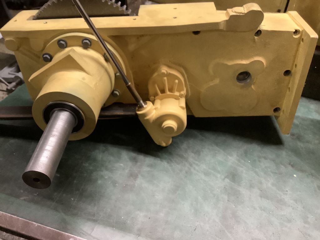

                                                As you can see the steering box is now finished and now has its position on the side of the gearbox. I had to make the steering wheel shaft and temporarily fit it to the box as it I had to set the shaft at 66 degrees to the horizontal top of the main gearbox. The steering arm that fits onto the worm wheel shaft has been shaped but has yet to have the square hole made at its pivot point.

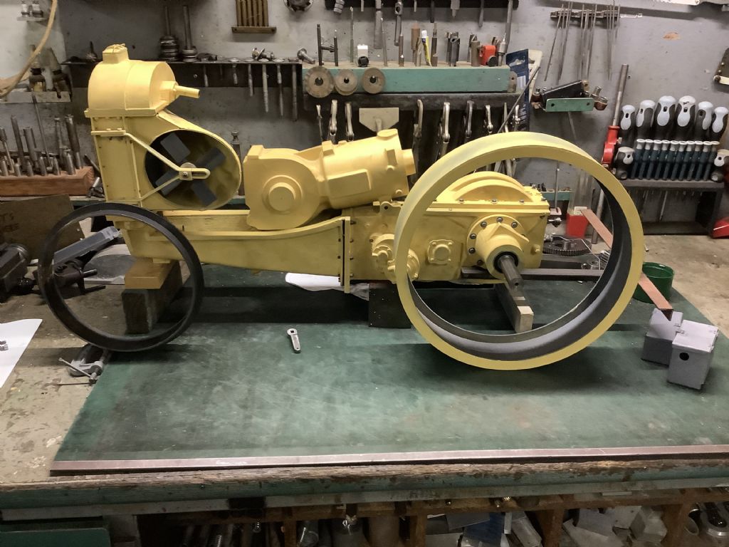

                                                  aeba204a-2826-4573-8dad-e6f676eb3098.jpegJust to wet the appetite the photographs show progress so far ( but still a long way to go). The small part between the wheels is the steering arm that attaches to the steering gearbox. This part has a 6mm square hole in one end and it took most of a day to make as I made and used square broach but the end result was that the hole is a good fit on the square shaft and that was the aim of the day.
                                                  Fred.

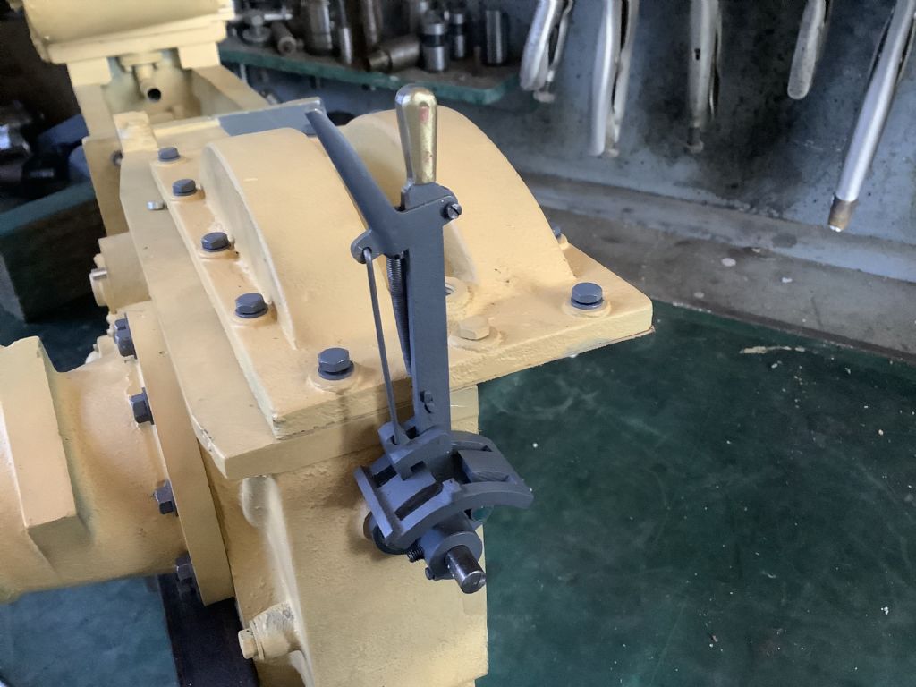

                                                      This is this weeks”model”. It’s the gear change lever and as small as it is it’s fiddle and takes time. It’s a case of fingers too big and parts too 4669dca4-37ff-43fa-8212-f6bedd4d0174.jpegsmall! The next part to be made is the clutch lever and as I didn’t have all the dimensions I had to make a visit to the farm armed with camera, rule and sketch pad. I am lucky in that the property is only 15 km away.
