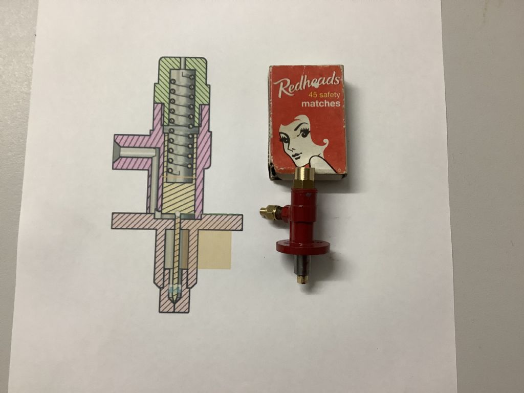

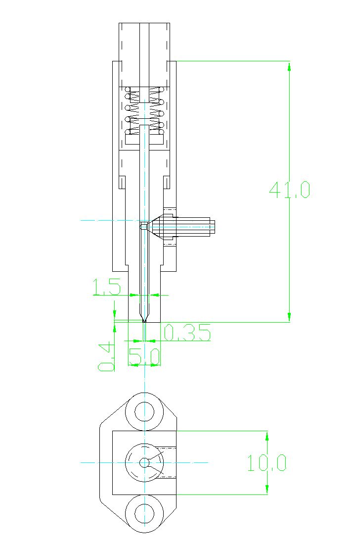

      What injector pressure are you looking for? I am using 90-100 bar (estimated) but you shouldn’t need anything like that.
      I think that you need to reduce the length of your 0.35mm nozzle hole on two counts. Firstly the relatively long thin passage will tend to cause the atomised fuel to coalesce and secondly drilling a 0.35mm hole several millimetres long is a significant challenge. I would suggest the nozzle hole should not be much more than 0.7mm long (2 x d).
      The long 1mm fuel passage will also be somewhat of a challenge to drill. I avoided this by having a long reduced diameter section on the needle but that makes whole thing longer and the fuel inlet somewhat clumsy.
      Finally I moved on to the mushroom/poppet design which removes a number of the manufacturing challenges and avoids the fuel drain.

      Howard Lewis
        @howardlewis46836
        As an aside, the length of the hole (s ) in the nozzle will affect the spray angle.
        Since a model will probably not be expected to run at Full Load Rated Speed for long periods, if at all, one can probably be a little more lax over needle lift and sac volumes,
        For the prototype machine, i would have expected Injector breaking pressure to be of the order of 65 – 70 bar
        It was only in the late 30s that pressures reached the 120 – 130 bar level (Atmospheres actually, at the time)
        Eventually pressures crept up through 180 Ats to 210 as Injection pumps and injector manufacturing techniques improved. (We expected a Leyland 0600 to be marginally better with CAV injectors.than with Leyland ones, probably based on slightly better lapped fits, leakage rates and tighter tolerances.
        Since leakage is subject to pressure and time, higher pressures will increase leakage, both in the pump and the injector nozzle (Leakage is one of the features which checked in full size products ) In a model it will be difficult to better the lapped fits of the conventional products, But with 90 years of manufacturing experience and development. modern materials and technique. may allow that.
        To produce scale models of F I E which function is no mean feat anyway.

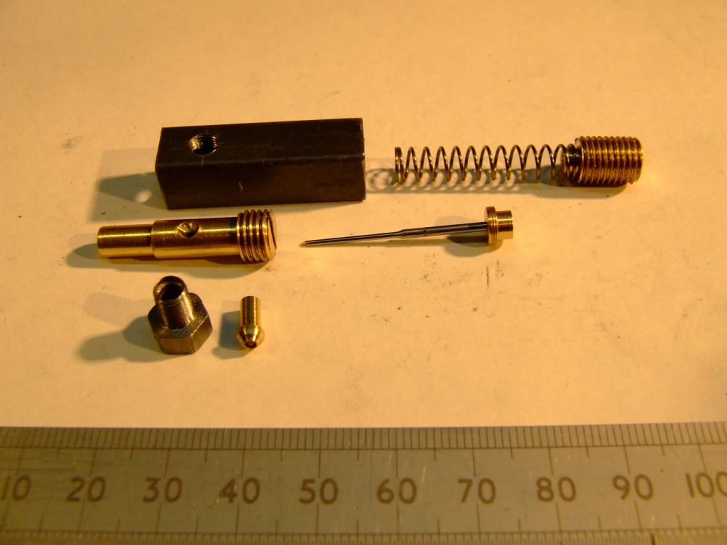

          Four stroke Fred
            @fourstrokefred

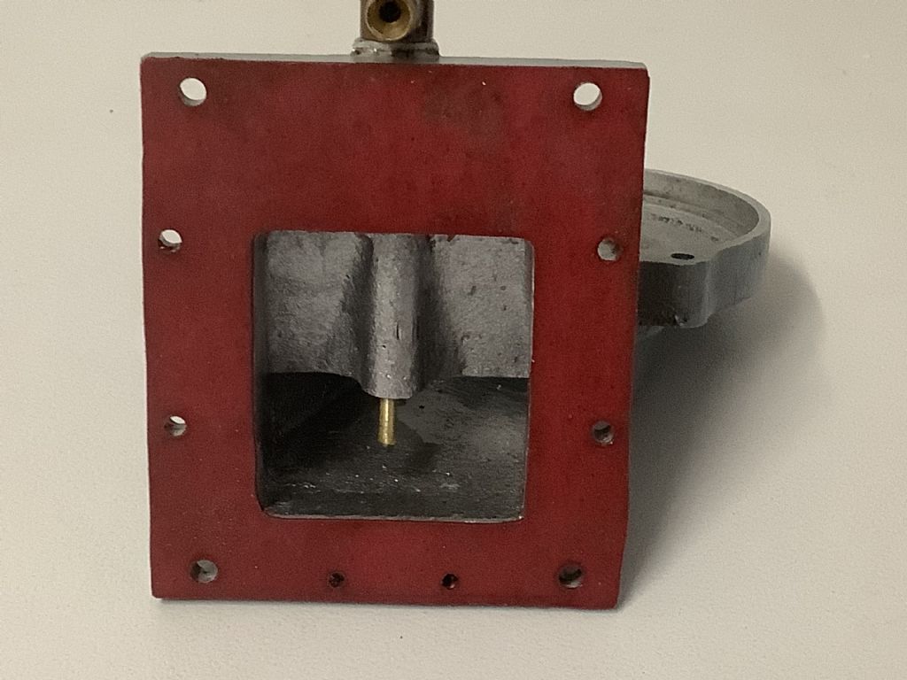

            This is the Mk5 injector! I designed 5 but only made 3 of which this is the latest and I am pleased to say that it works and gives a good fine spray. I always realised that this part of the model would be a real challenge and take time. The piston is made from bronze and the body from steel and both are lapped to give a good fit. The lapping part of the process took far longer than expected and with the hope that as the injector heats up in use the fit should tighten up and help retain the pressure. I will carry out further experiments to determine the final spring pressure and try different size gas jets to see what effect these have. It’s scale is with in that of the model and is not to overpowering. I have had plenty of practice at drilling small holes (1.0mm dia) and pleased to report that no drills were broken in the process ( although one did disappear out of the chuck and out of the window due to centrifugal forces). The two main parts are sparingly silver soldered together to avoid blocking the fine holes and passages. Although it is difficult to see on the drawing there is a fuel hole near where the needle pass through the support to allow the fuel into the lower chamber.
            Fred.

              That looks good smiley Are the gas jets screwed in so you can easily change them?
              #622428
              Four stroke Fred
                @fourstrokefred
                Yes the gas jets are screwed into the lower body ( 4.5 metric) and I have a range of four different sizes to choose from. This makes it easier to clean and change sizes. The number 5 design allowed me to ream the bore through and lap before assembly but did involve some tricky silver soldering.

                      #630418

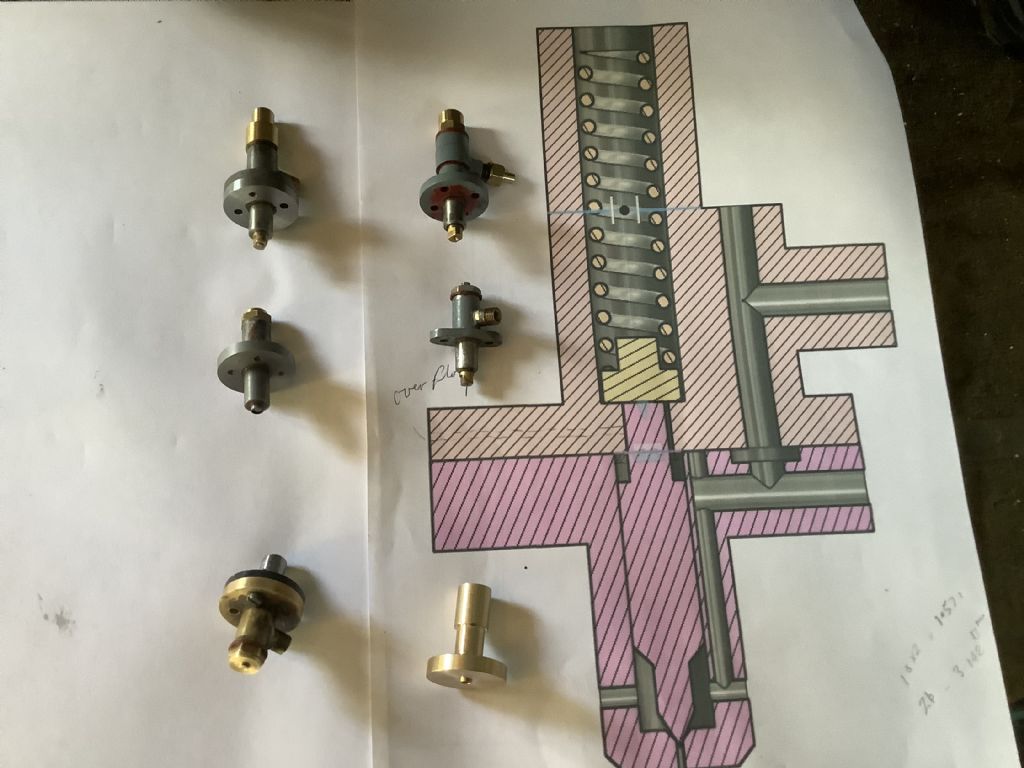

                      Four stroke Fred
                        @fourstrokefred
                        With Christmas and New Year over its good to be back in the shed. I am not sure what the plural for a group of injectors but this is the sum total made so far. The drawing shows the next stage of the development and next weeks work in the shed. Some of the above have worked but I need to have a consistent performance. I have tested them to 1,600 psi and feel that should be sufficient for the low compression engine. One problem that I did encounter was blockage in the small passages and jets and to overcome this I have now fitted a three stage filter system in the fuel line. The first stage is a gauze filter inside the fuse tank, the second stage is the fuel filter on the side of the cylinder and the third stage is a micro filter in the fuel line to the pump. I did have to remake the original fuel filter slightly larger as I wanted to incorporate a filter from a lawn mower. The plumbing is now complete. From what I have read on other forums I am not alone in trying to solve the problems of injectors and pumps. Painting has been put on hold as the weather is very humid at this time of the year and it’s not a process I enjoy! I feel that the development stage will take longer than I anticipated. The drawing does not show the blocking off of the passage ways necessary to make it work.

                        Roger B
                          @rogerb61624
                          That sounds about right smiley A quick check suggests I have at least 9 injector designs plus five injection pumps. You will get there and it's great when you do thumbs up

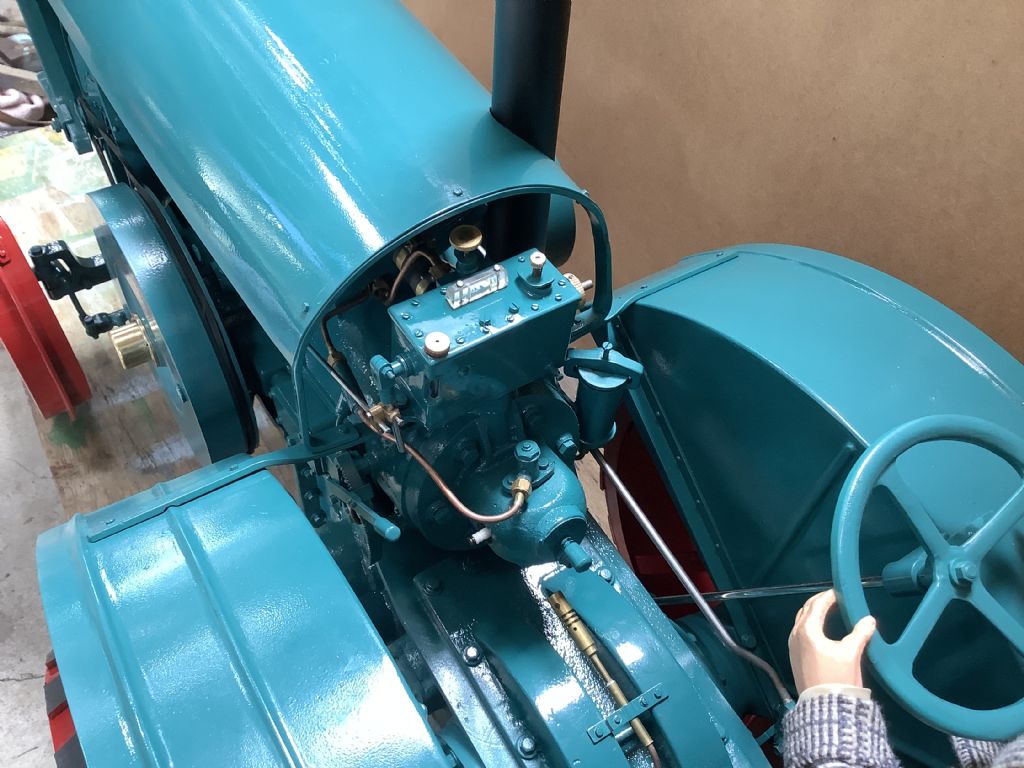

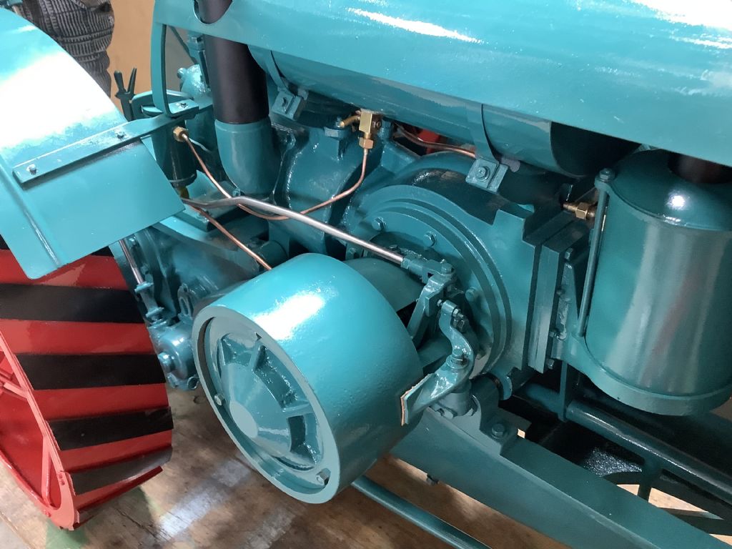

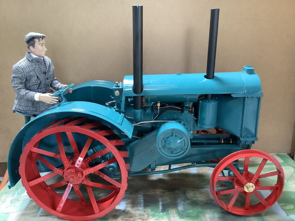

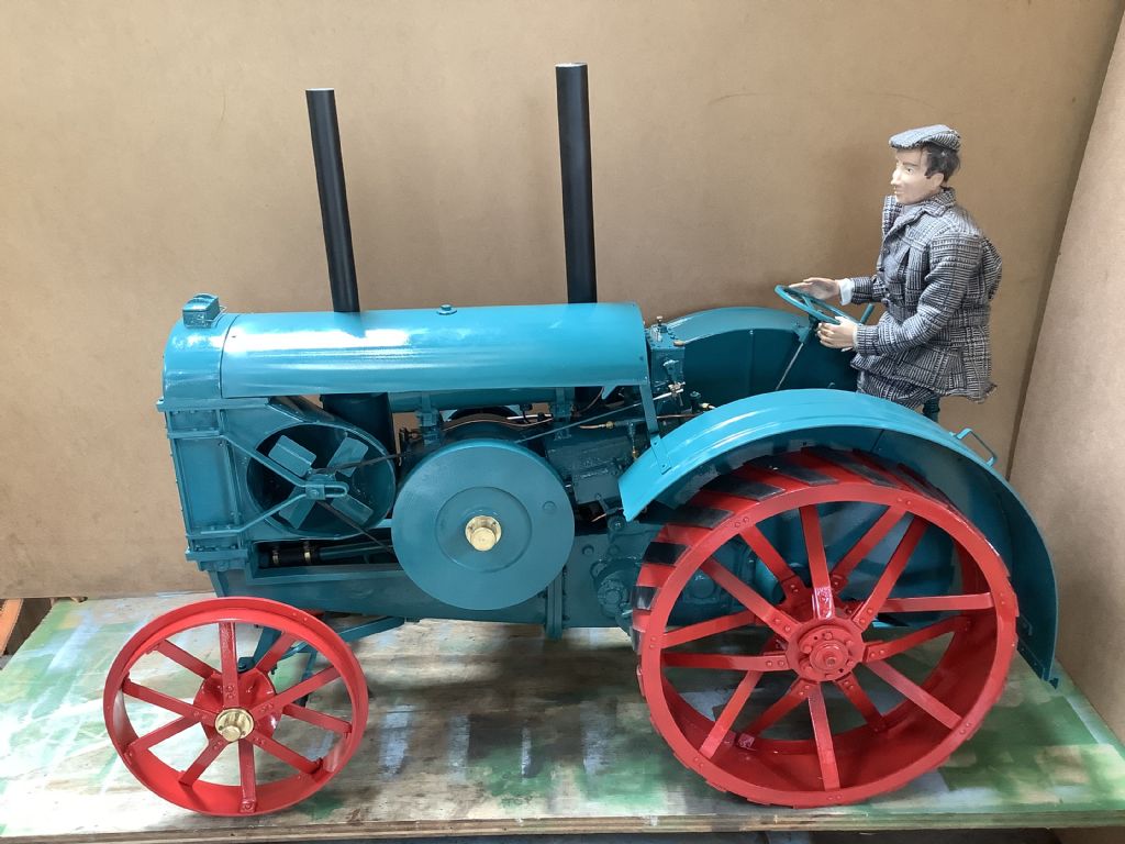

                                                #636801
                                                Four stroke Fred
                                                  @fourstrokefred
                                                  The photographs show the end of four years work ( pleasure and pain!). Having chosen the colour from a paint card in the paint shop I had a bit of a shock when I opened the tin as it was more of a duck egg blue when viewed in the day light. I did start the painting process thinking that the colour would grow on me but that was not to be. A sleepless night followed and no it wouldn’t grow on me. Next morning a return to the paint shop and a meeting with a very helpful lady assistant produced a more acceptable colour. Painting to me is not a very enjoyable part of the process and all that cleaning up! After leaving the paint to harden up ( two pack) the process of reassembling began only this time all the cheese head screws were changed for hex head and bolts cut to the correct length. Fortunately all the parts went back in the correct order except for two of the radiator rubber connections – these are of different lengths and I had fitted a longer one where a short one was supposed to fit with the result that the fuel tank did not end up in the correct position. What have I managed to learn over the last four years and about four thousand hours. This model was a real challenge and pushed me to the limits but it made me explore areas of our hobby that I would not have taken if I had not made this tractor. I can now use CAD ( Fusion 360) and a 3D printer and can accept that challenges keep me thinking and give me some thing to look forward to each morning. There are just not enough hours in the day and best use must be made if every hour. This weekend I will be thinking of all those attending the Model Engineering Exhibition in Harrogate and wishing I was there to enjoy the experience – hope the weather improves. Perhaps next year I may bring the Mc Donald over and have a chance to meet fellow like minded model engineers. “Fred” is sitting on the tractor model and he will be pleased to meet you all. Thanks to all those who have offered help and followed this experience and I hope you enjoy your hobby as much as I do.
                                                  Regards,
                                                  Fred
