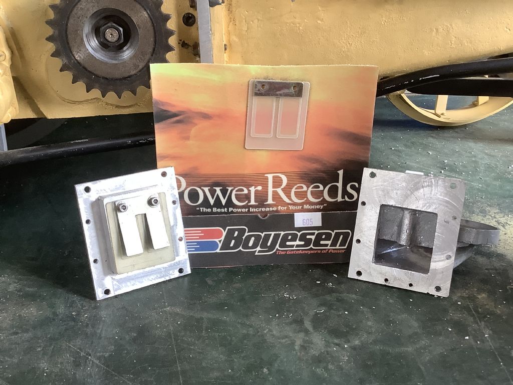

            I never thought I would be able to say that there are only two more parts to make plus any I have to remake. The photo above shows the two stage reed valve induction unit. These reeds were originally designed for small motorbikes where at low speed only the the two small petals open but as revs rise the secondary kick in ( the larger part). The steel protruding plate prevents the reeds from contacting the flywheels. The second photo shows the chain drive from the engine to the gearbox. Commercial chain is used and it does not require a tensioner – more by luck than calculation. I did have to remove a link and make use of a half link as a joiner. Having careful separated the link that had to be taken out I was ready for the next step but no I accidentally picked up the link I had just taken out and fitted it to the chain. That’s how to waste time with out really trying! I still have to make and fit a chain guard and also connect the clutch lever to the clutch.
            Fred.

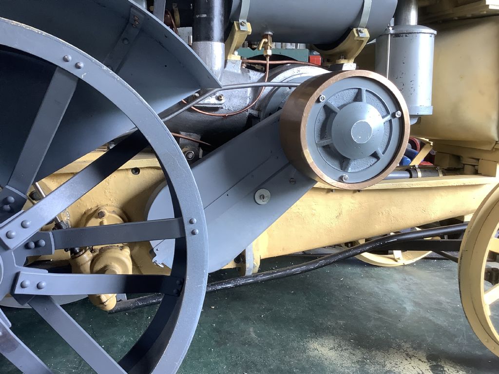

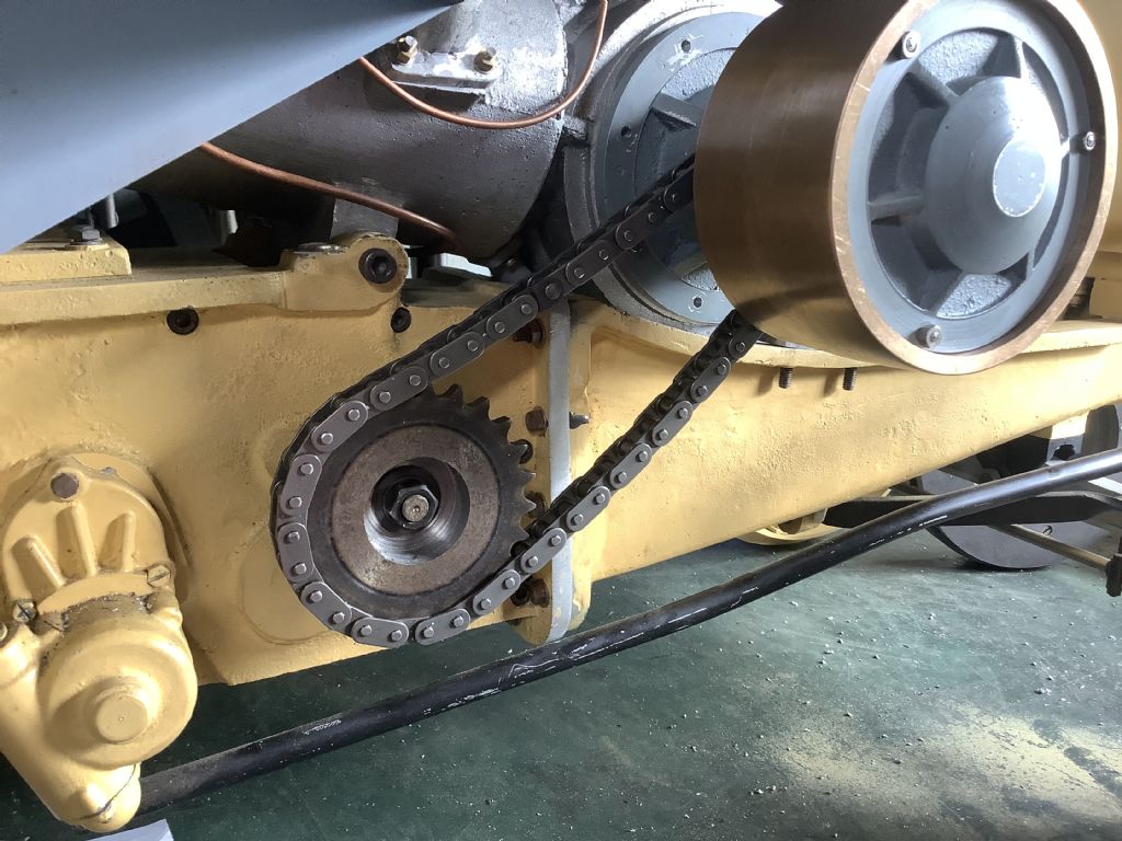

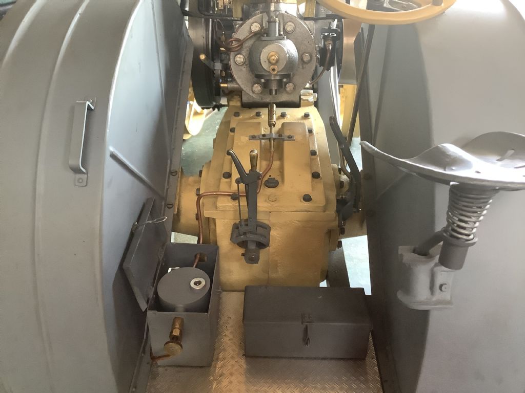

                93d63ae2-df42-4315-807a-bd09d411ac39.jpegThe above photo shows the finished and fitted chain case and that in theory is the last part to be made as I have also made and fitted the push rod for the clutch/ brake. The next stage is to have a working engine but I expect that will take quite some time as there will be some problems to over come. I do have a small pencil type gas blow torch for heating the bulb and will adapt that to fit and hopefully it will produce combustion inside the engine! Trying to make this engine work is a bit like stepping into the unknown as there are so many variables that have to be solved and no instruction book to follow but that is why we take on projects like this, it’s the challenge. The one aspect that I am not looking forward to is having to completely strip, detail and paint the model and when that task is done the model will be finished. If and when the engine bursts into life I will record the occasion for posterity and I will then be walking on air for the t week or so – fingers crossed. Thanks to all of those who have added comments and given me the incentive to keep working on this project.
                Fred.

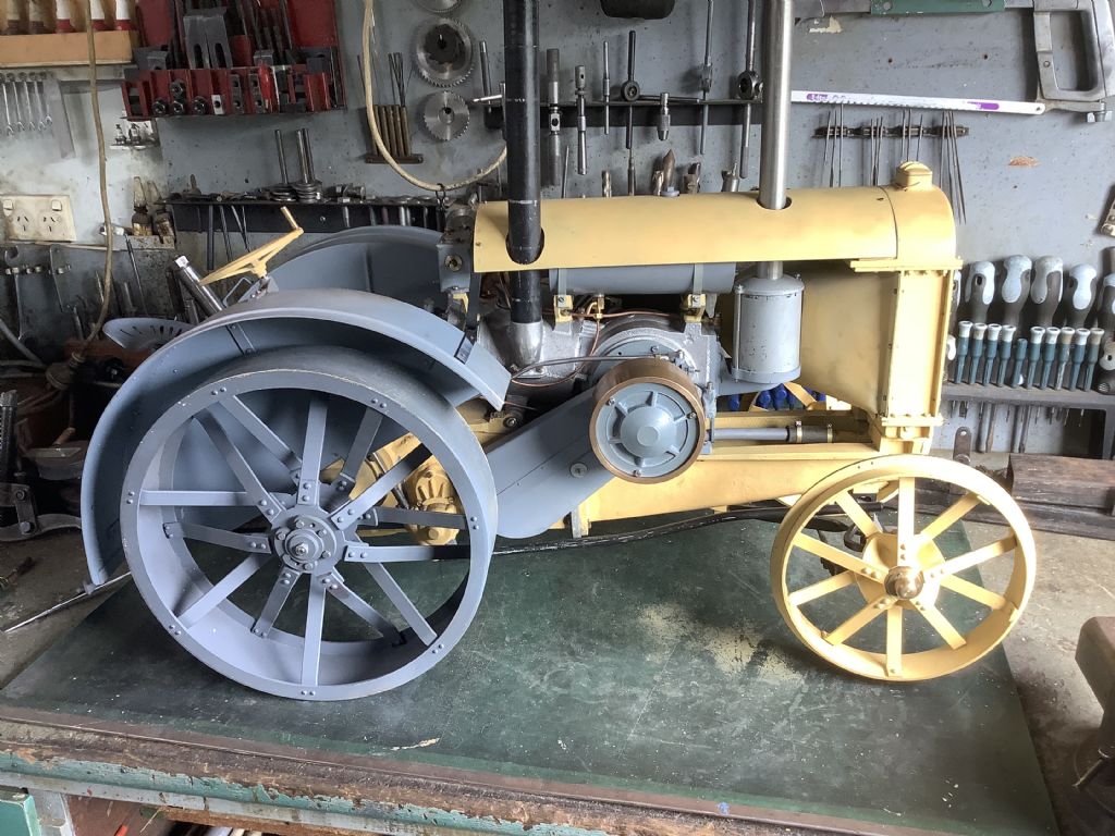

                        The photo shows the gas tank and burner in position. The head of the burner and the filler in the tank came from a small pencil type gas torch with the tank being made from brass and copper. I do have to set the length of the flame but have made the stand so the this can be adjusted to suit. All the cheese head screws on the model have now been replaced with hex heads ( as near to scale as possible). The oil pump has had its stroke reduced by 30% and the injector set at 20degrees before top dead centre. All gaskets have now been made and fitted but I do still have to check and test the cooling system. I read in a motorcycle magazine about a fellow who had just restored a bike and was not sure if he should kick into life or sit, admire and enjoy the product of all that labour for a while! That’s how I feel about the Mc Donald but as I do need to see and hear it run ( if it will) before I start the painting process I will try giving it a whirl in the not to distant future!
                        Fred.

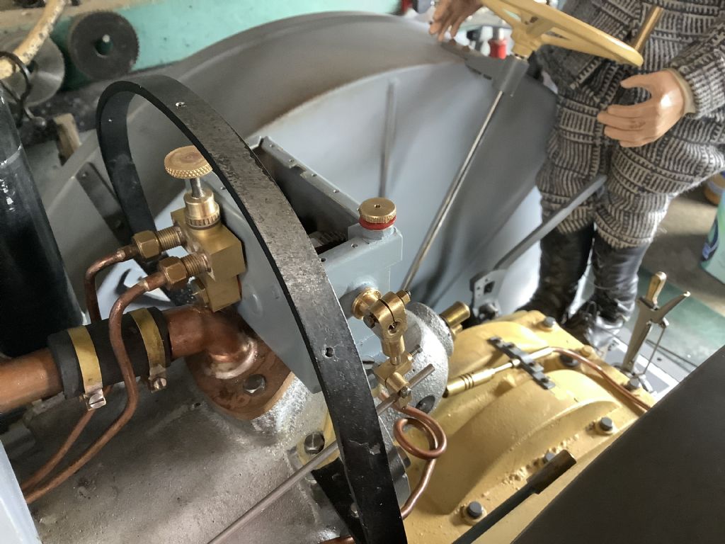

                              This weeks efforts saw the gas cylinder in place and the gas jet set and working as it should do. Two problems did raise their heads and need to be addressed. The first was the oil in the the oil box siphons down to the engine when left over night. I think this can be resolved by the addition of two small springs to hold down the ball check valves in the pump body and not rely on gravity or the weight of the steel balls to form a seal. I have discovered that my electric razor has springs of just the right size and shape. Just call it recycling! I will need to drill and tap a drain hole in the engine crankcase to allow excess oil to be drained out.
                              The second problem is trying to start the engine by holding on to the scale starting handle. On the full size tractor the flywheel is rocked back and forth until enough momentum is generated to overcome the compression. Holding onto the small retractable handle on the model is not the easiest of processes and the fingers soon tell you so ! To overcome this I will have to make a starting dog that will attached to the flywheel side of the engine and allow an electric drill to be used. These are just some of the small problems to be overcome and there may be more to follow.
                              Fred.

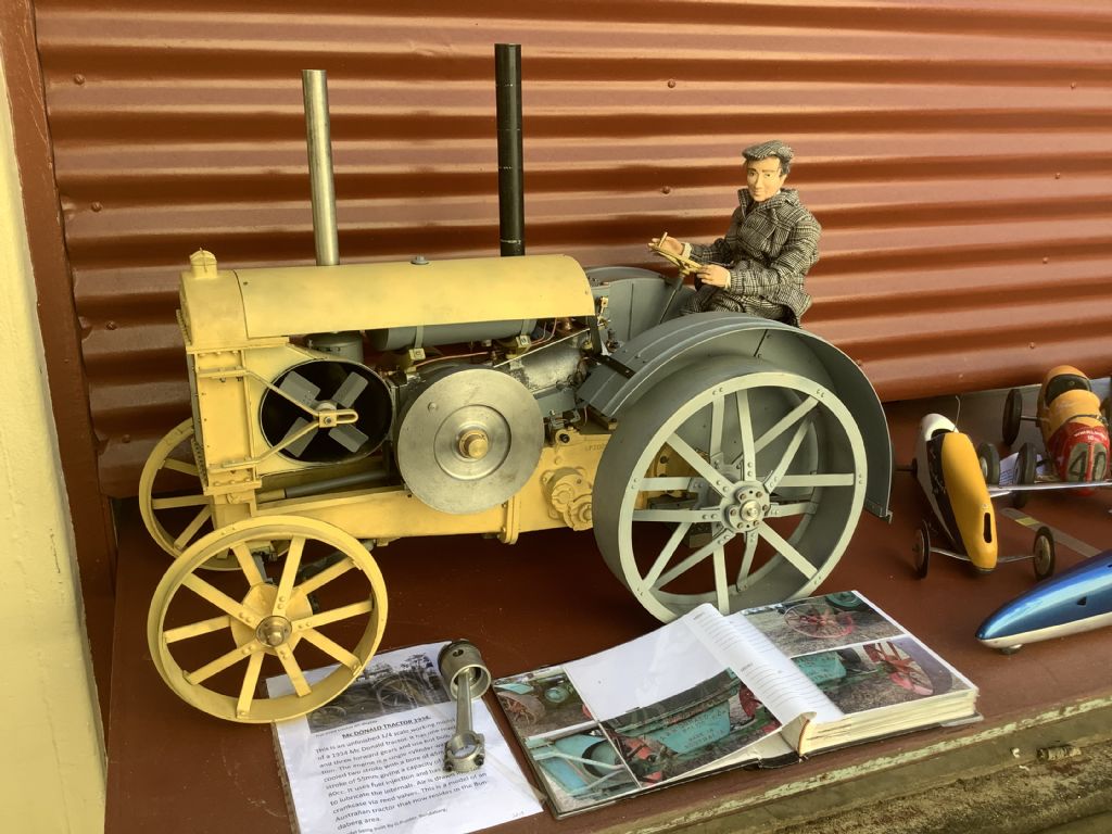

                                        #618198
                                        Four stroke Fred
                                          @fourstrokefred
                                          The development continues. As a test of the porting I set up a Hall effect ignition system with a small magnet embedded in a brass case in the back of the flywheel. The engine already has a spark plug positioned in the head as on the full size tractor this is used for starting in cool climates. I used a commercial engine starting spray in the air intake and cranked the engine over with an electric drill. To my surprise and pleasure it fired up which proved the porting and reed valve were working. The exhaust noise was very load – I had almost forgotten how noisy two stroke engines can be on an open pipe! I made and fitted some baffles and lightly pressed them into the exhaust pipe but on restarting the engine these were to be seen heading to the sky at a rapid rate of knots . After fitting a small bolt to hold them in place the noise level was reduced to a more acceptable level and gave some back pressure to the exhaust pulse.The current injection system uses a small gas jet but this size of hole was still to large and an excessive amount of fuel squirts into the pre combustion chamber – another problem to solve. Having spent a night thinking how to make a very small hole I came to the conclusion that a small hypodermic needle may be the answer as these are available down to .003 inside diameter. A needle could be silver soldered into the gas jet but only experimenting will see if this improves the situation and that’s todays task.
                                          Fred.

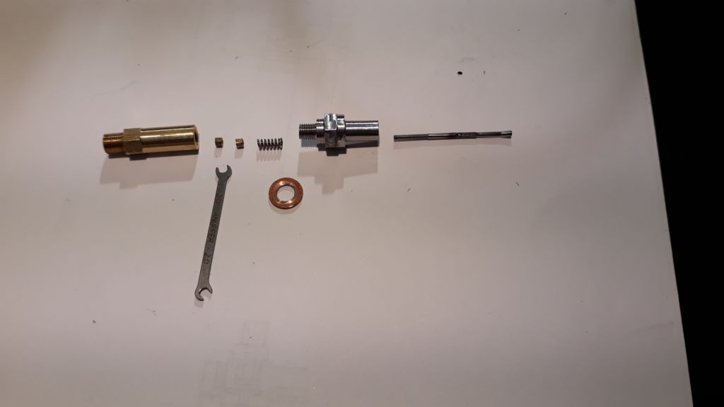

                                                @rogerb61624

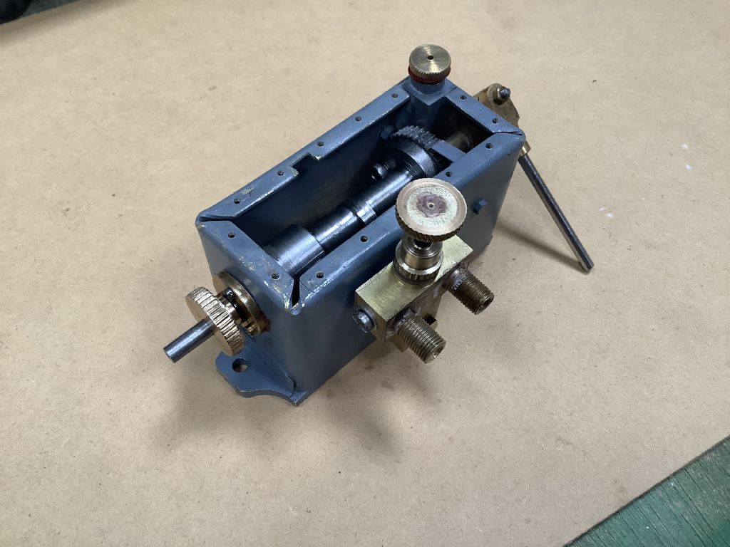

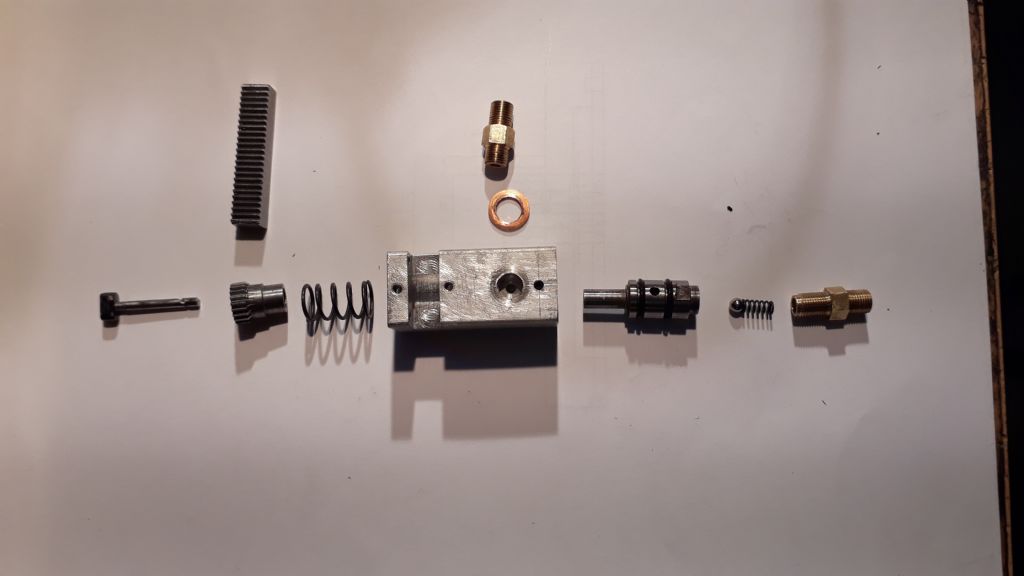

                                                I have been playing with fuel injection systems for many years. My current system seems to work and seems to be reproducible. This is based on 20 – 25 cc engines and uses a 2mm diameter injection plunger with a helix metering groove. I initially tried a needle type injector but the leakage by the needle was too much. I am now using a mushroom/pintle injector which seems to work well on petrol, as manifold injection, and diesel. I have built a test pump which I can operate with a spring balance which implies an injection pressure of around 90 bar. Be careful with fuel at these pressures and keep it away from your skin. I usually check the results against a piece of paper.
                                                Here is an exploded view of my injection system. The injector needle is 1.4 mm diameter. There are more pictures on here:
                                                https://www.flickr.com/photos/153503473@N05/
                                                And a spray patten is here:
                                                **LINK**
                                                #620699
                                                Four stroke Fred
                                                  @fourstrokefred

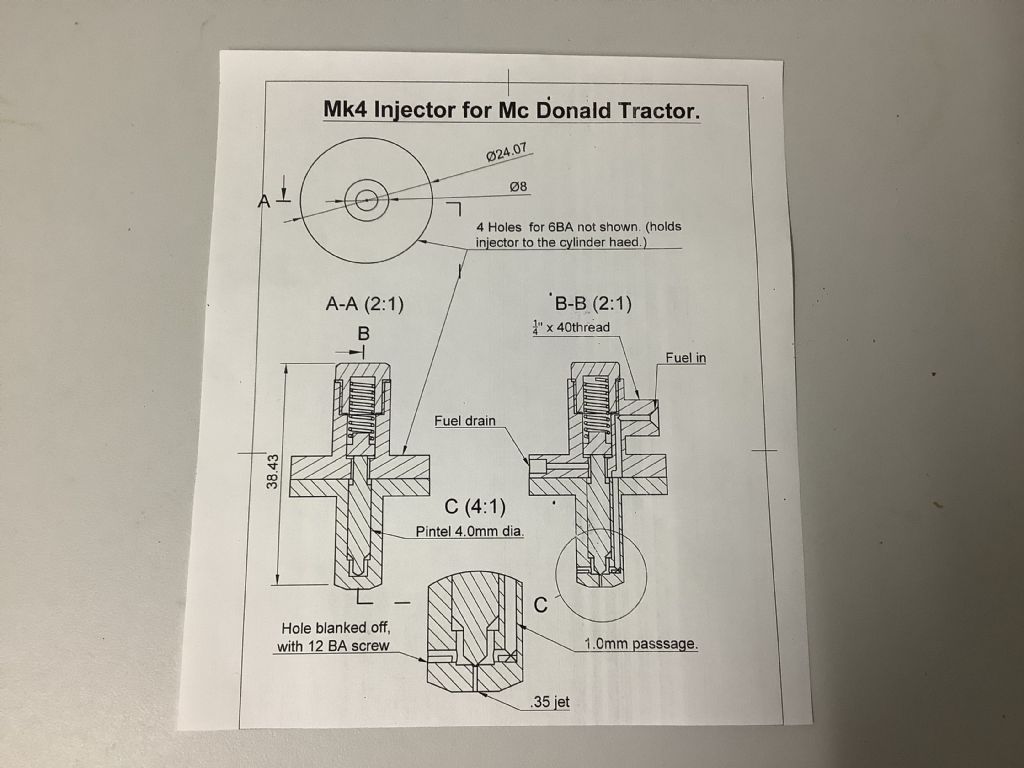

                                                  Roger thank you for the information on your injector system. I have redesigned my injector for the tractor and am now in the process of making it. I have managed to borrow an injector test pump for testing when I reach that stage. What is the bore and stroke of the pump on your engine ? As the pump and injector are both detachable I have decided to now paint the model and work on the injection system while the paint is drying.
                                                  Fred.
                                                  #620720
                                                  Roger B
                                                    @rogerb61624

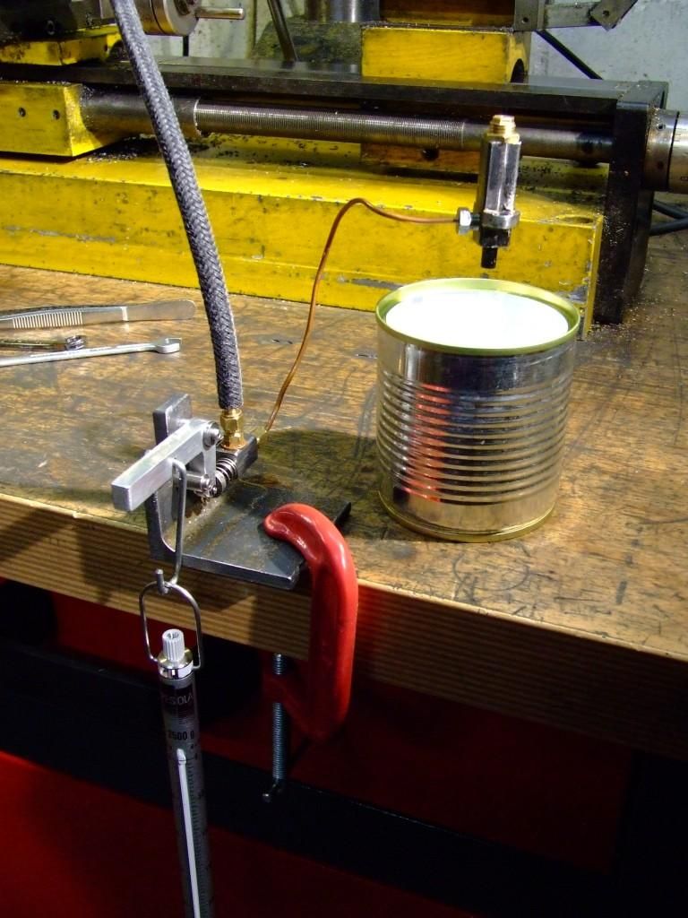

                                                    I designed my pump based on a 20 cc cylinder and a 14-1 Air Fuel ratio. This gave a fuel requirement of 2mm3. With a 2mm diameter plunger the calculated stroke for full power is 1.5mm.
                                                    The finished pumps have a bore of 2mm and a maximum working stroke of 2mm. The actual stroke is reduced either with a wedge or a helix spill to around 0.6mm for a light load.
                                                    If I remember correctly your engine is 80 cc so you would need to consider a maximum fuel delivery of 8mm3, so maybe a 3mm / 1/8” plunger.
                                                    I made my own simple test pump and use a spring balance to determine the approximate opening pressure of the injectors. It is also good practice at getting the required plunger fit to achieve the injection pressures.

                                                      86679e52-4b5e-44c4-9d13-bac5916c2913.jpegNo dramatic news to report as I have been working on the injector, now up to Mk4. The photo shows a drawing of the latest injector. I have made all of the body but have yet to make the internal part that controls the point of injection and hopefully produce a fine spray. I do have the loan of an injector test kit and will use this to set the spring pressure. Being a scale model I have attempted to make this part to match the rest of the model but it does mean drilling very small holes! I am going to remake the pump only this time with a 3.2mm but that is for next week. Thanks for the information RogerB and I hope my effort produces similar results to yours.
                                                      Fred.
