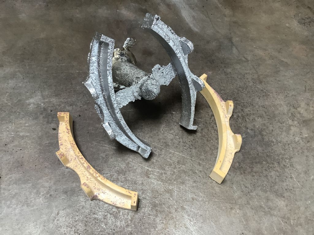

      Lee that sounds to be very similar to our Liquid Nails. It has a rubbery texture with plenty of body and sticks to your fingers very well! Accept the A 7 engine as a self inflicted challenge! The use of a 3D printer to prototype parts is very useful and tactile as they can high light problems with the design that you may not at first see. I have been working on this casting for about the last ten months and the 3D prints were used as both patterns and core boxes. Having the use of this type of technology (CAD and 3D printing) does make life easier.
      Fred.

        I am surprised that the liquid nails withstands the heat of the pour. Do you use water based or spirit based?
        If I can't make a greensand mould, the pattern has some small details that might not survive the extraction of the pettern from the mould, I have some epoxy resin bought from a local boat chandler.
        A new resin 3D printer is on it's way. I hope to get prints from it that need less preparation than those from my Ender3. A good printer, but it has its limitations.
        Lee

              Lee, Liquid Nails must be a spirit based glue as washing the hands in water does not remove it. When using it to glue the blocks together I keep it away from the edges of the joint that are exposed to the molten metal. This leaves a small flashing on the casting but that is easily removed later. I do seal the outside of the joints just in case there is any small leaks. I also use an Ender printer with a working volume of 250x250x250 and work in both PLA and ABS.
              Fred.

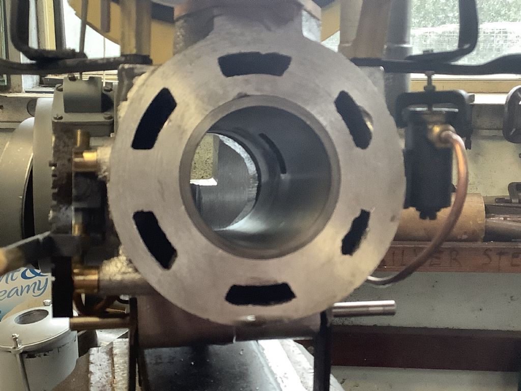

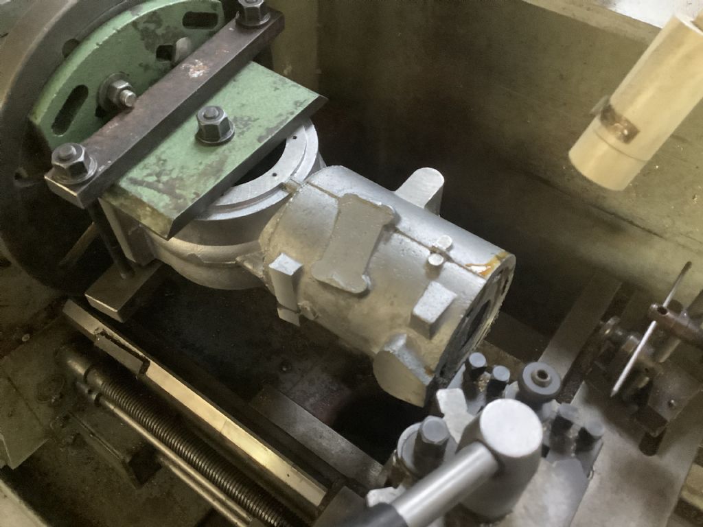

                        1b50a9c6-76d3-46cc-8764-daa92b644958.jpegNo this is not a repeat of a previous photo but the new casting set up and having the end of the bore faced off. The lower part of the crankcase has already been machined and has had the bearing plate and injector fitted (not shown in the photo.)The process is slow due to the fact that setting up an article of this shape and size just takes time. Drilling four holes took half an hour ( 25 minute setting up and 5 minute drilling). Due to the set up in the lathe the process of facing the end of the cylinder is slow and it takes 10 minutes for every pass, any faster and centrifugal forces come in to play with disastrous consequences! I hope by the end of the week to have the bore machined to the 50mm diameter ready for the cast iron liner. I will probably make a dummy aluminium liner that is a sliding fit so the I can mark out the ports before making the working liner in cast iron.The photographs that I have taken with the previous two efforts have been very useful for reference when setting up this casting for machining. Last weekend I went to the local car, truck and motorcycle show and took my 125cc OHC twin Benelli (1982) – a great day out.
                        Fred.

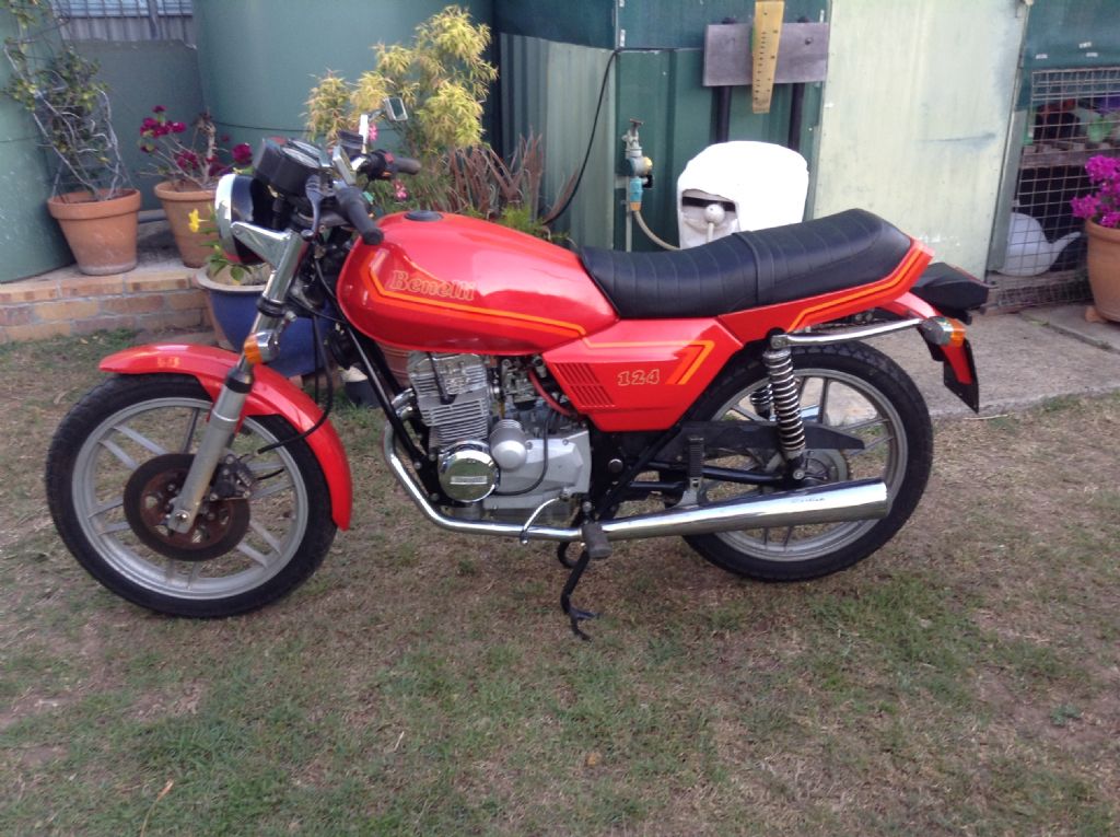

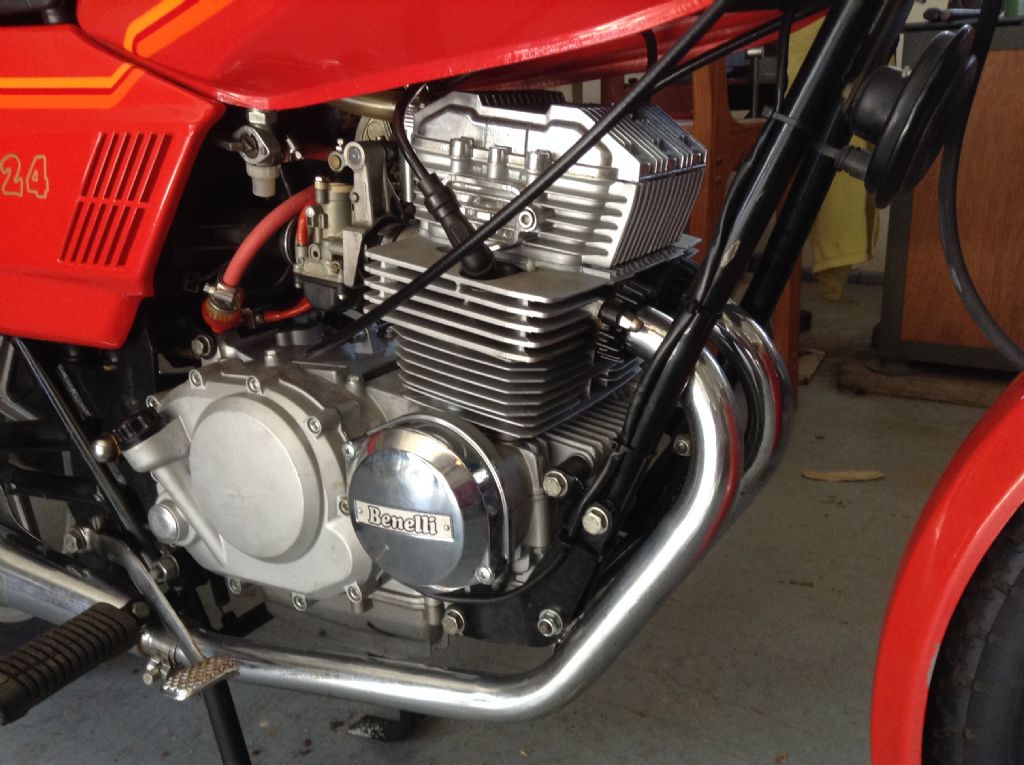

                          d2086397-a6e7-4e0b-bb0b-3e83bde96bf1.jpeg1368084b-7e6e-41b5-8446-135a2b22be8f.jpegA “ model” motorcycle – makes a change from tractors!
                          Fred

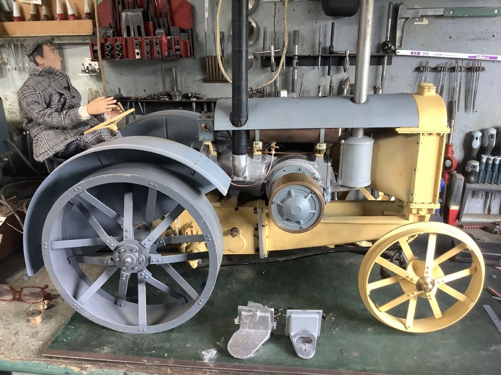

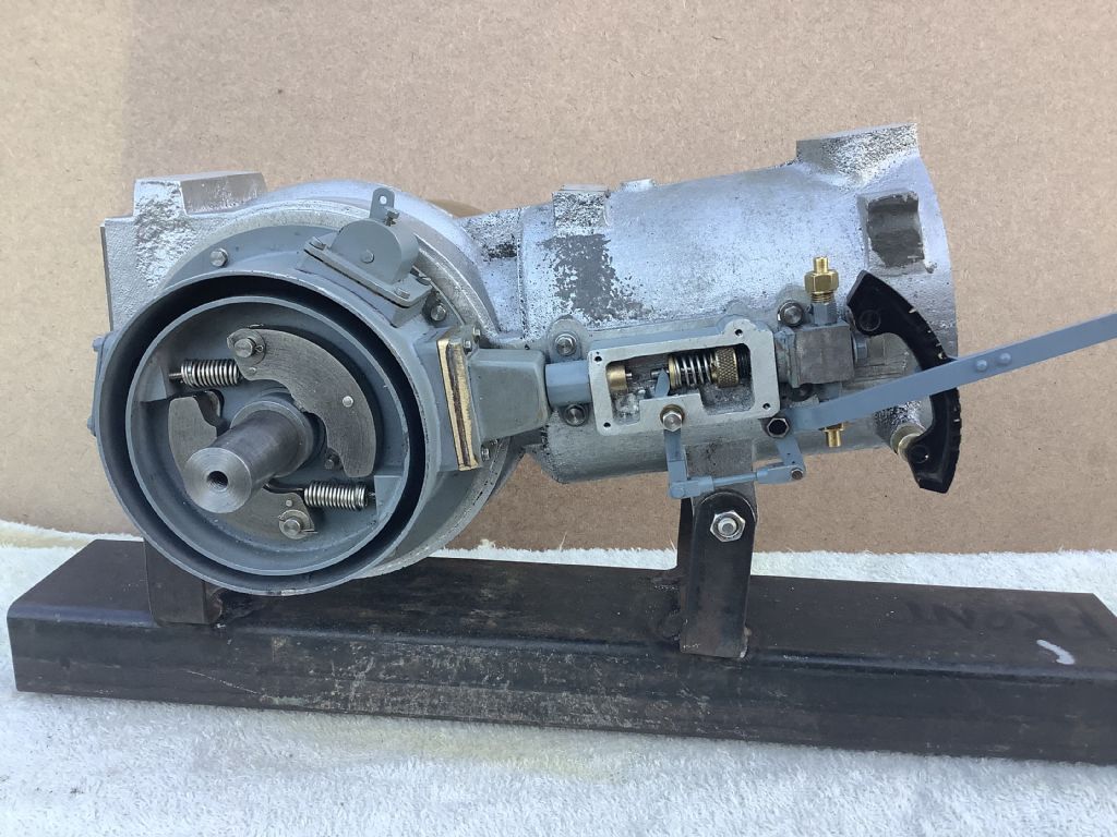

                            d0a7d505-140e-4e09-981f-f0b499932266.jpeg64d5cbe7-ccd7-4d90-8bdb-19329083ba71.jpeg80eba4d3-f323-4f5d-bad8-4925a246a1d2.jpegThe casting proved to be satisfactory and has been machined as can be seen in the photographs. This week I started the process of assembling some of the parts of the engine to make sure they all line up with where they are supposed to go and made a stand to hold the unit making life a little easier.The assembly includes the crankshaft /piston as I have now made a temporary liner which will later be used to check the port positions before making the real one from cast iron. The top photo shows the method used to machine the exhaust manifold – tricky but satisfying when finished. I have made the exhaust pipe a sliding fit and it will be held in place by a small grub screw as this will enable the pipe to be removed for ease of transportation and a reduction of volume should I every go the UK (MEX). I now have to make the fuel tank supports, fit the lubrication system ( the arms shown are 3D prints but will later be cast in aluminium) and add the water inlet and outlet holes. This tractor has a chain drive from engine to gearbox and is tensioned ( on the full size machine) by raising the front engine mount but as this is carried out the air and exhaust pipes are no longer vertical! I may tension the chain on the model by using a slipper tensioner but have to wait until the chain is fitted before I come to a decision. There are still problems to solve but life in the workshop is never dull.
                            Fred.

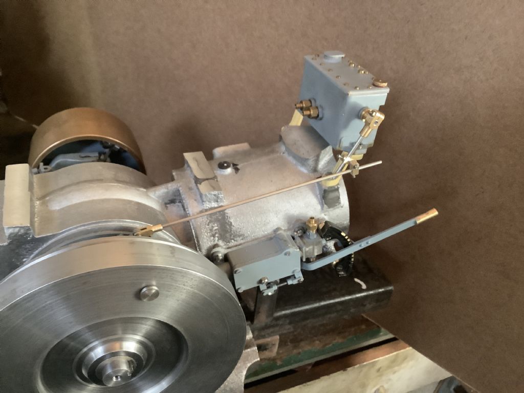

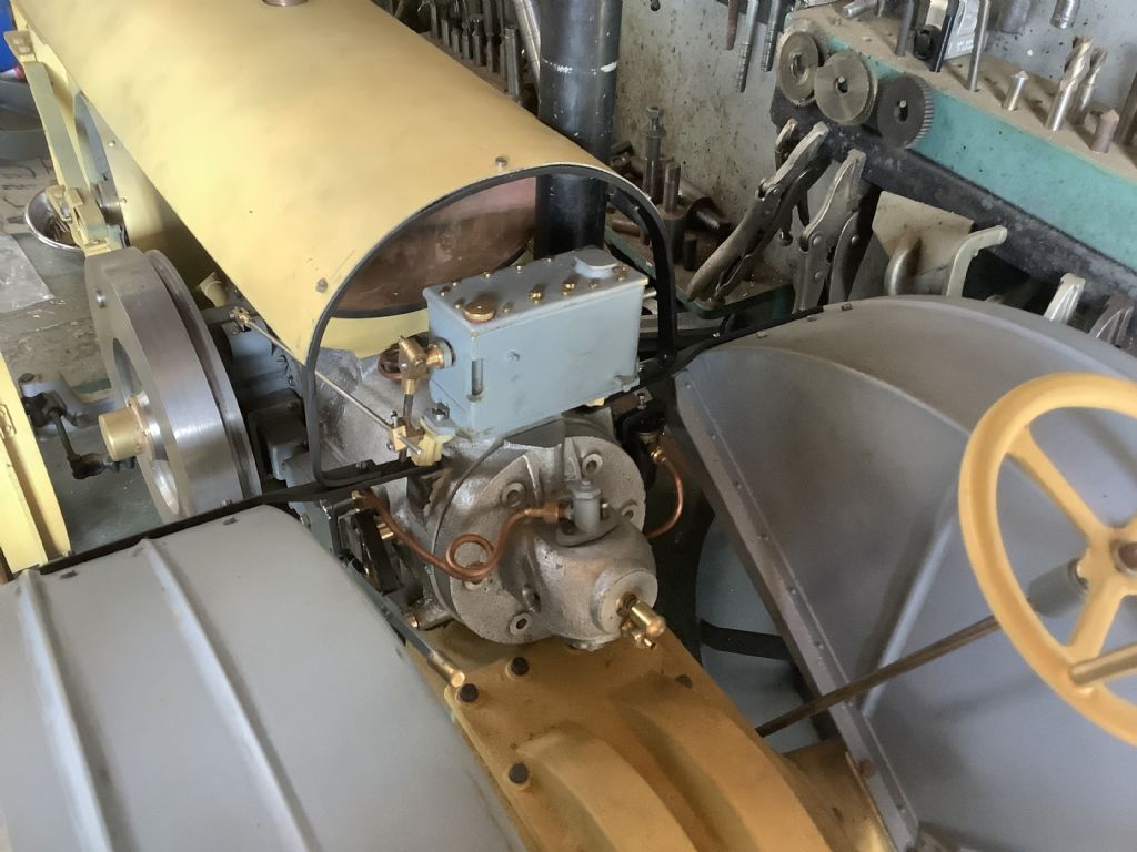

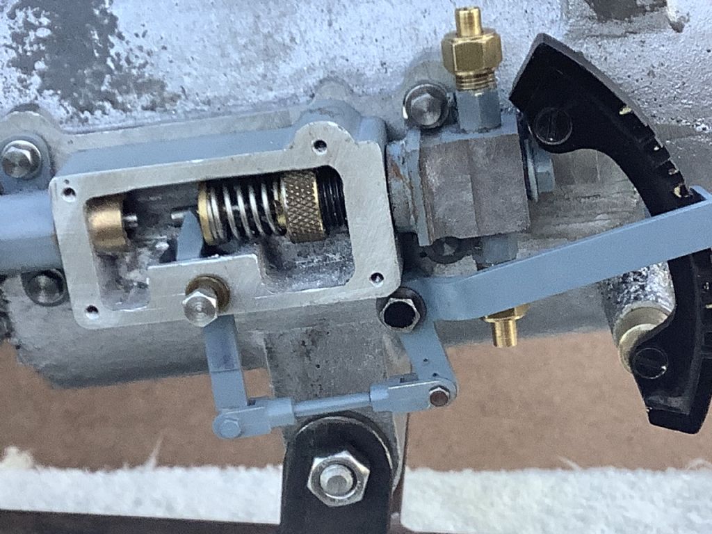

                              This weekends workshop time was spent on the injector set up ( but not the timing). These small parts take longer than expected to both make and then set up and there seems very little to show for the hours it has taken, but it’s all to do with the vision of the end product. Each division on the throttle “gate” is 5 degrees and equates to half a mm of movement on the injector plunger via all the levers. If this amount of movement is excessive there is provision for the leverage to be changed but experimenting will determine if that is required.The crankshaft has yet to have the flywheel keyway cut but as this keyway may also drive the eccentric for the injector I have held off the process.
                              Fred.

                                        Today more 3D printing and casting. These are the saddle’s for the fuel tank and when cleaned up will be bolted to the top of the engine.

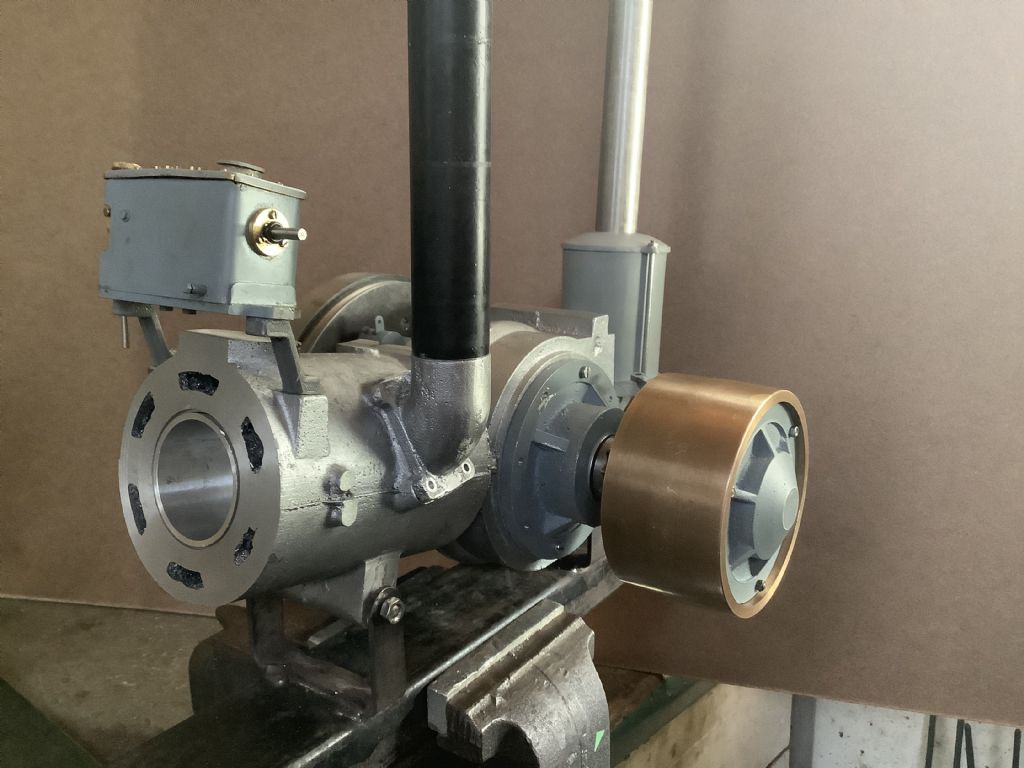

                                        #609133
                                        Four stroke Fred
                                          @fourstrokefred
                                          b29d5fd8-d92b-43ca-ba18-cc02077eddff.jpegThis week it was a case of one step back and two steps forward. On assembling the air intake I discovered that the air pipe was obstructing the water pipe on the header tank of the radiator. The cause of the problem was the casting that joins the air box to the back of the engine. I had made the casting on the centre line when actually a part of it was offset from the centre line – this can be seen with the two castings in front of the tractor. The one on the right was the first attempt and the one on the left shows the amount of offset require. This was not easily seen on the full size tractor and only another visit and more photographs resolved the problem. After making a new pattern and core box it took me 4 attempts to make the new casting with the cause of the problem being the placement of the in gate. As they say if at first you don’t succeed try ,try and try again! The fuel line and filter have been fitted and the holes in the bonnet cut. There are still plenty of small jobs to do and that includes machining the cast iron liner from a 60mm diameter bar – boring.
                                          Fred.

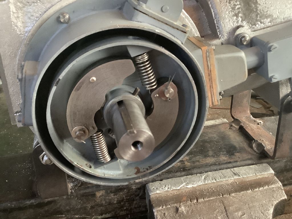

                                            #609511
                                            Four stroke Fred
                                              @fourstrokefred

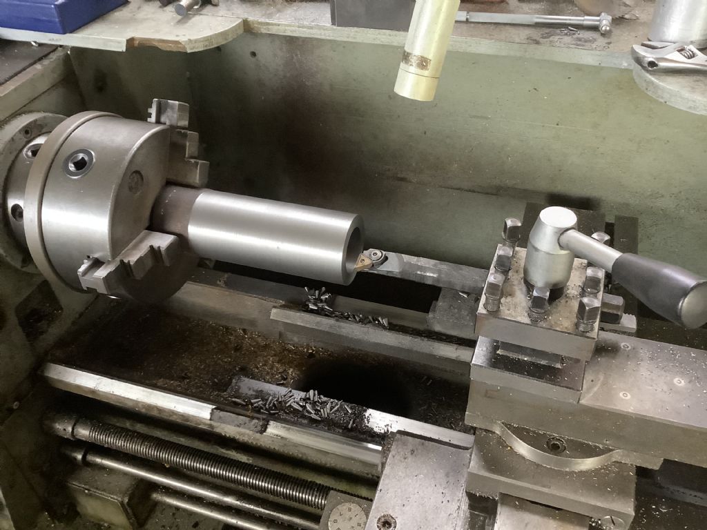

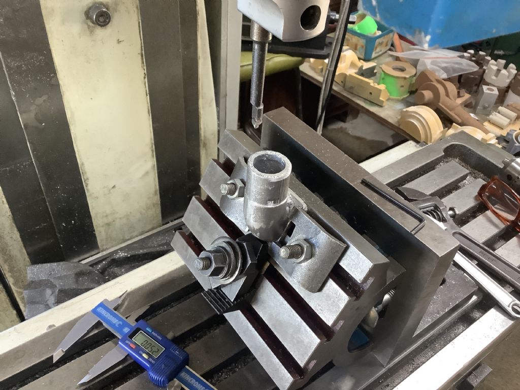

                                              67889d81-a9b4-4743-aea4-8c38e6ef18cd.jpeg541b9fe9-ccee-4411-bb00-fef901766cee.jpegBoring, that was the order of the day – boring the cylinder liner that is. The bar of iron was 60mm diameter and had to reduced to 55 mm and bored out to 45mm diameter. Waste was high but that was the only material I had in stock. I still have to finish the bore, outside diameter and then machine the ports.The fuel tank is now in its final position and has now been fitted with a filler and cap. The bonnet has had the holes cut for the exhaust ,inlet and fuel filler and the support stays added. The fuel lines and lubrication pipes have also been added. The list of jobs that still require attention is now shorter but it’s all the small jobs that seem to consume vast quantities of time. Beware this hobby of model engineering is addictive!
                                              Fred.

                                              Four stroke Fred
                                                @fourstrokefred
                                                The list of jobs continues to reduce. This weeks work included the connecting up of all the water inlets and outlet pipes but the main effort went into machining and fitting the cast iron liner. Machining the bore was a long task as the final cuts were very small and lathe speed very slow ( about 20 minutes per pass )Having machined it to the required size both inside and out I was ready to press the liner into the cylinder. Guide lines were marked to line up the ports with the port holes in the liner. All went well with the fit being just right and in line with the top of the cylinder but a check revealed that the liner had rotated slightly as it went down the bore – oh bother! Next job was to make an extractor jig to remove the said liner. Double checks we’re made and this time all was well with all ports in the liner matching up with the ports in the casting. The piston complete with rings can now move up and down the cylinder. The next major job is working on the cylinder head. I also have to make and fit the rod that connects the clutch lever to the clutch and make and fit the chain drive to the gearbox. Photo to follow.
                                                Fred.
