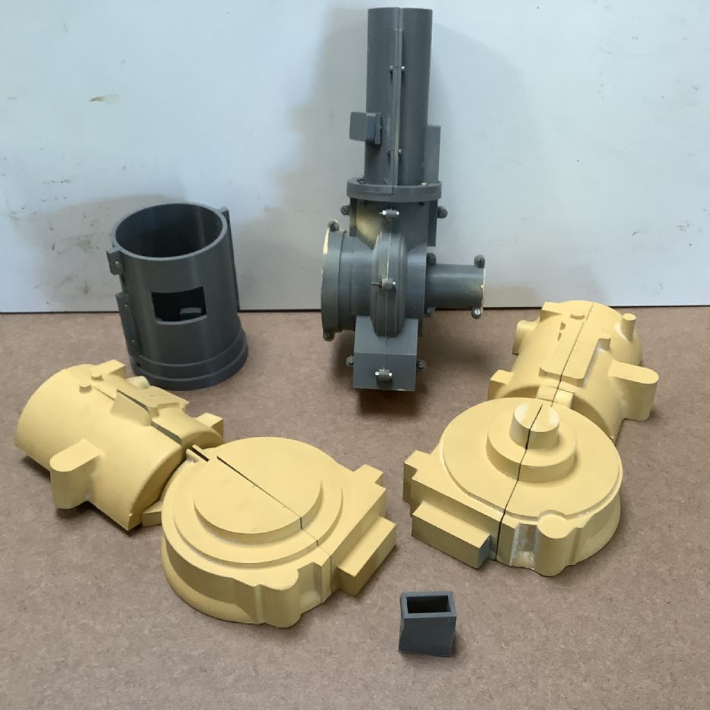

                          #601199
                          Four stroke Fred
                            @fourstrokefred
                            Sometimes progress and success arrive in small steps. The photo shows a small step that was made this week as I now have made the sand core for the water passage. It has taken quite some time but the development and 3D printing is a lengthy process. The castellated sand shape in the centre of the photo is the water passage and around it are the parts of the mould. The grey part, front right, is the capping part and was designed to act as a funnel and a cap for the centre tube. Packing the sand has to be carried out quickly and the funnel definitely helps out here, plus some manual dexterity! This was the first attempt and it worked, even if it took quite some time to extract the end product. I have been studying runners, risers, gates and the whole process of pouring the molten metal into the mould and I am now ready to make this part of the system work. I have read conflicting information where the theory and practice do not match up and that’s in the same document. More study and reading required. Our small group are still chasing up a supplier of small quantities and of both resin and hardener but progress is being made (transportation is expensive).
                            Fred.

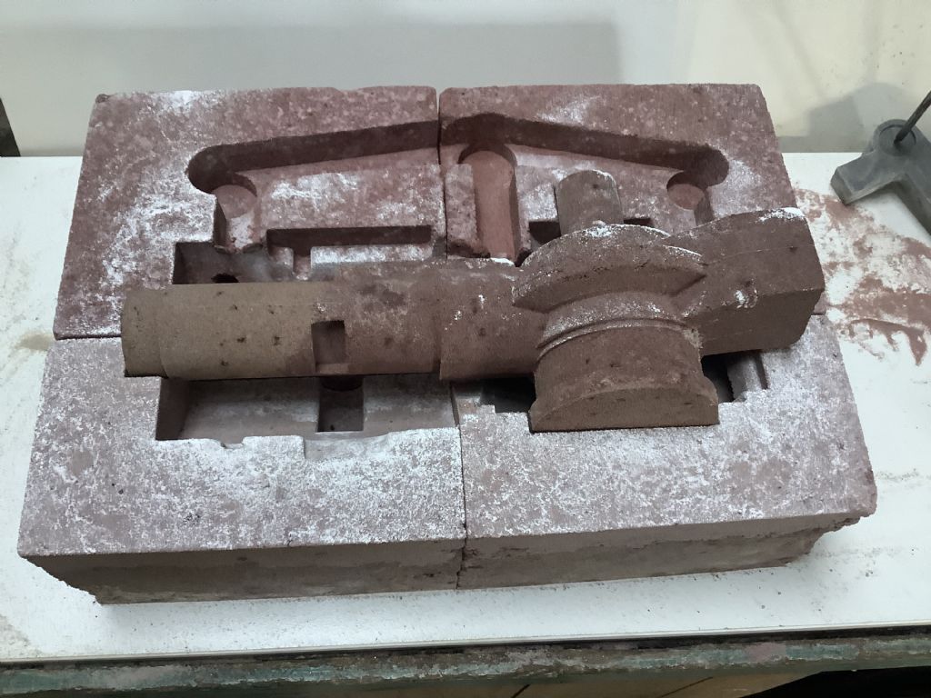

                                  I have just checked back on this forum and discovered that I have been working on this casting for the engine for about ten months ! The last few weeks have seen a repeat of the processes that I carried out except this time I am using new patterns and core boxes. There is no substitute for experience as long as it it a learning process. The photographs show the latest attempt with modified runners and risers. Tomorrow I hope to pack the top half and next week attempt pour number three! This time I am using a finer facing sand and this leaves a crisper finish to the mould. Photo to follow.
                                  Fred.

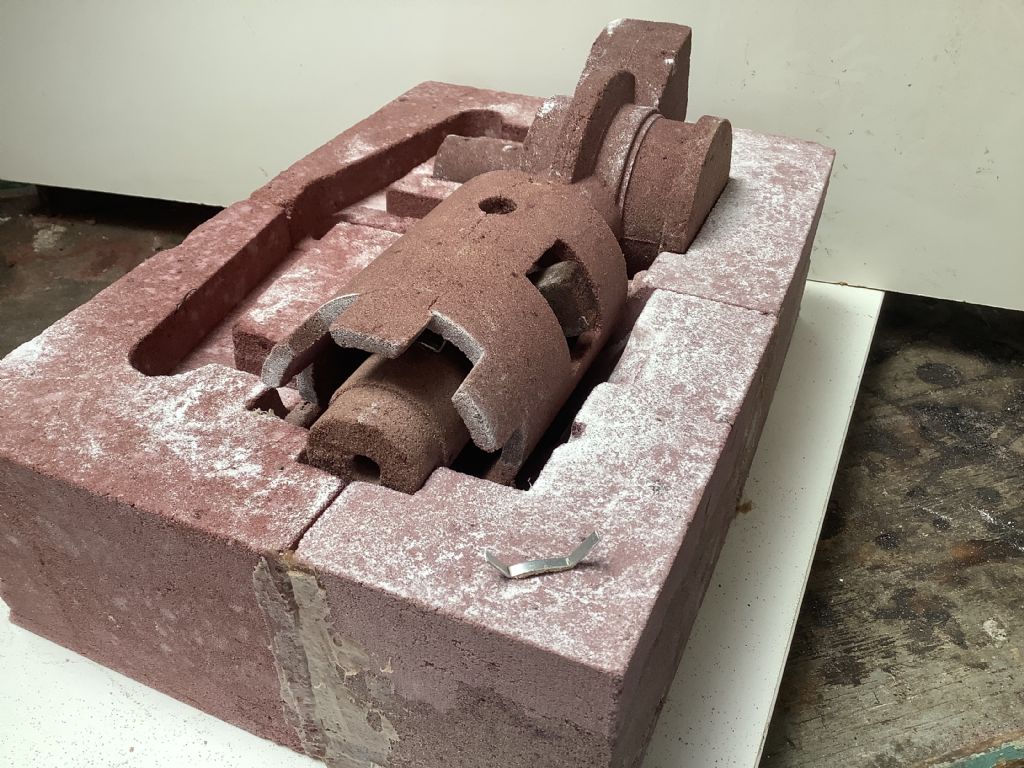

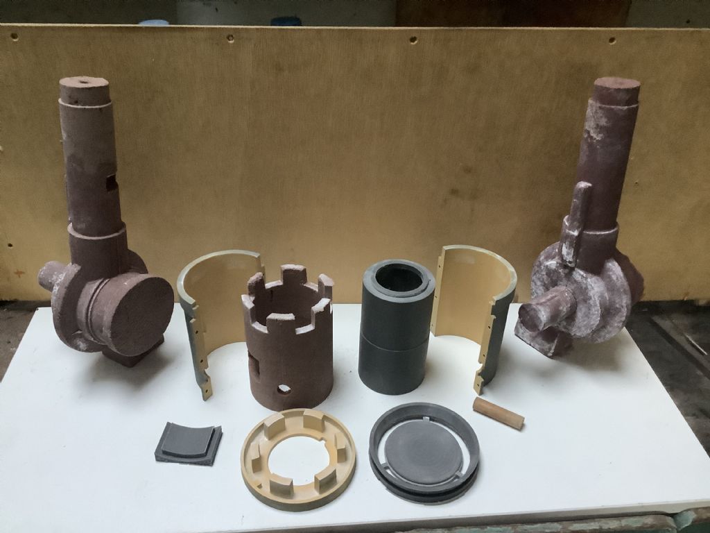

                                      Four stroke Fred
                                        @fourstrokefred
                                        58804087-dfa4-4a52-be2a-379edec120fd.jpegIToday I assembled the blocks ready for casting next week, weather permitting. The top photo shows the three cores in position with the water passage core held in place by the chaplets – sample shown in front right hand corner. This was a real fiddle and a test of will power! All the blocks have been glued together and vents cut into the top blocks to release any gas build up from inside. It seems almost a pity to pour metal in but the aim is to produce a good casting and hope that this is the last time. With this part of the project it makes me feel almost like a child who leaves his home work to the last minute ( having completed most of the other parts already) but you know it has to be done!
                                        Fred

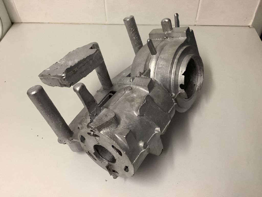

                                        Four stroke Fred
                                          @fourstrokefred
                                          After many months of trying to produce a good casting, today was the day. The photographs show the cleaned up engine casting with all the runners, risers etc. The quality of the casting ,particularly the surface finish both inside and out has improved over the other two attempts and pouring method worked very well. The rectangular block is the pouring basin and it was a pleasure the see the molten metal being drawn into the mould and the rise up the vents. Fortunately the sand core for the water passage did stay in place and with the sand now removed it looks good. One could say the cloud has been lifted! The next stage is to trim off the parts not required and prepare the casting for machining.
                                          A very happy,
                                          Fred.

                                            #603456
                                            Four stroke Fred
                                              @fourstrokefred
                                              I it took me a while to find the second photo but here it is. Thanks for your comments Lee and to answer your questions. I use a resin bonded sand ( with hardener) for both the cores and the “blocks” and use “ Liquid Nails” to join them all together. The sand used on the surface of the casting is quite fine but I back it with a courser mixture. The ratio I use is 1kg of sand ,25cc of resin and 2.5cc of hardener. The resin needs to be well mixed into the sand and contrary to information that I have read I then add the hardener. You do not have a long time to play with it ! I make sure the mould is well vented and as you can see I use a reservoir to pour into. The casting is in aluminium – melted down Lister diesel pistons and degassed. I was interested in your new project of the Austin 7 engine. This brought back many memories as that was my dads first car when we lived in North Wiltshire – ah those were the days! I hope all goes well and would be interested in the outcome.
                                              Fred.
