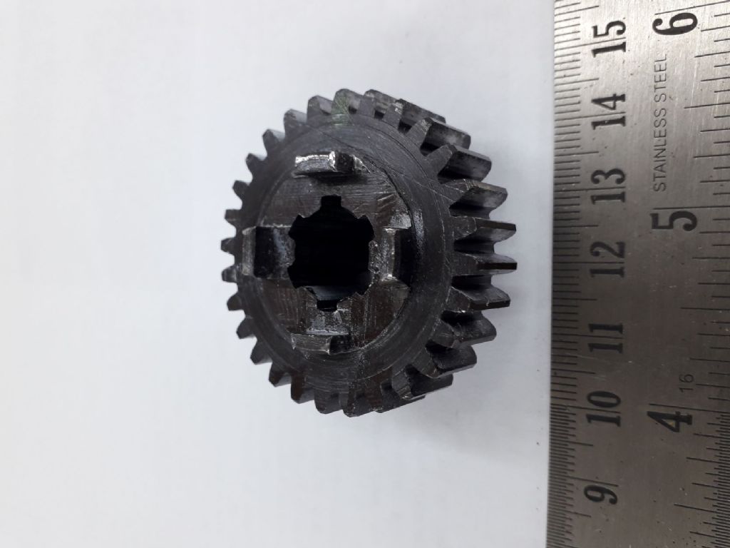

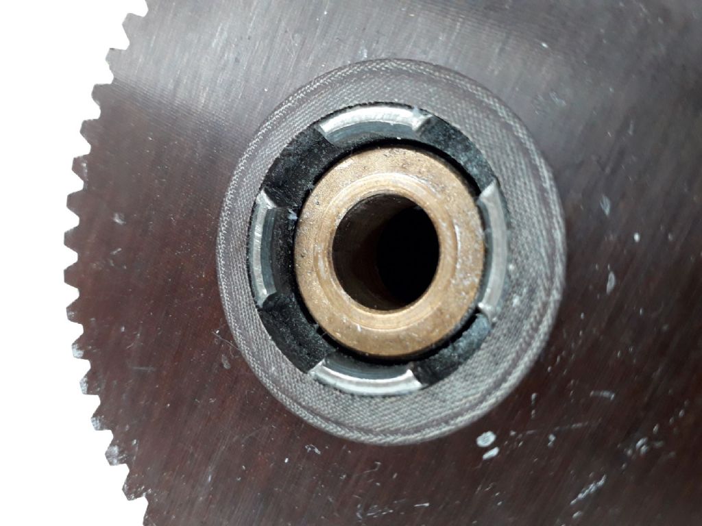

                      The issue I am having is with the connection between the gears as the drive teeth have worn. Both of these gears are on the same shaft with the splined gear driving the other gear. This is causing chattering when I start the lathe in the two highest speeds which is the only time these gears are engaged with each other. I have created an album called "Gears and Stuff" that has more images in it but the two attached images show the worn teeth on both gears. I will make sketches the gears and add these to the album. The teeth are about 0.030" smaller than the slot they engage with.

                          Never a good idea to have drive dogs with parallel faces, any drive gear dog worth its salt will have a subtle back taper on the drive faces (look at a motorcycle dog box for an example ). Stops the gears jumping out under load as well! Interestingly M/c dog gears have way more than 0.030" backlash between 'on drive' and 'off drive'. This primarily helps with under power gear changes, not something you will be interested in though I suspect!!
