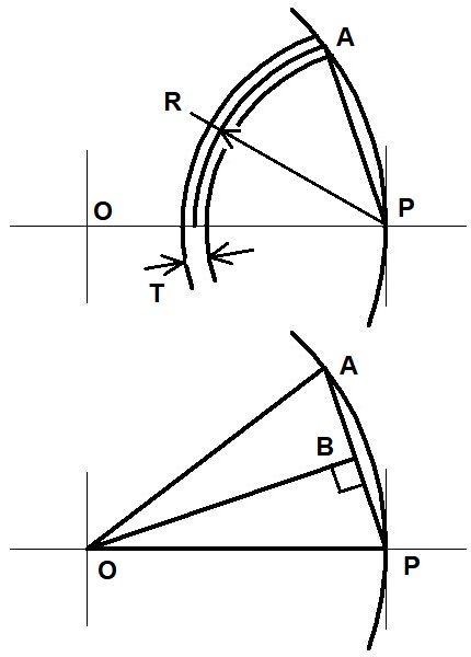

      Goat in field – my method:
      O is centre of paddock
      AP is the fence with P as the tether point.
      I halfed the "model".
      The area of a ribbon of grass is R x T x OPA (angle in radians). The first ribbon starts when R = T/2 (very close to P) and its area is the start of the total area. The next ribbon has R = R (previous) + T and the resulting area is added to the previous total area. And so on.
      Obviously there is an error because the end of the ribbon does not match the fence. However if T is small this is small. Some will recognise this as integral calculus.
      This only calculates a general area, it does not know when to stop. However if a spreadsheet is used (the obvious way of doing the above) you just run the sheet until the required area is reached.
      The angle OPA can be easily obtained from trigonometry, the triangle OPA is isosceles and can be split in two to give right angled triangles. Therefore Cos(OPA) = AP / (2 x OP) = length of tether / diameter of paddock. This is very easily incorporated in to the spreadsheet.

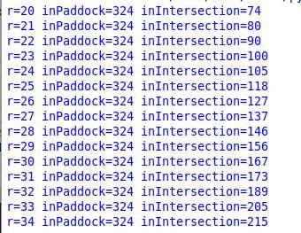

        Far too busy to be messing with maths problems, but here's a way of solving it without complicated maths. Needs a computer though!
        I used a Monte Carlo method. The idea is to generate a random list of points inside a rectangle that contains a circle representing the paddock. The count of points falling inside the paddock circle is proportional to its area.
        Then a second circle is drawn with its centre somewhere on the paddock circle's boundary. The point count inside it is proportional to the circular area a tethered goat can roam.
        Here's the fiendish bit: the number of points inside both circles is proportional to area the tethered goat can reach inside the paddock, i.e. the intersection.
        My simple program generated a thousand random points inside the rectangle, of which 324 fell inside the paddock. The length of the goat's tether (r) was increased a yard at a time producing the following table of intersection counts:
        The result is In broad agreement with Martin's calculation. r=30 produces an intersection count of about half the paddock count.
        The accuracy of a Monte Carlo method depends mainly on the number of random points generated. I used a thousand, which could be done manually by dropping Smarties inside a big frame, but millions would be better. Computers are good at counting big numbers quickly.
        My implementation is flawed. To keep it simple, the program steps in whole yards across the target, which is crude. To do better the algorithm should home in on a decimal value by progressively reducing the increment as it approaches the correct number.
        The data collected by Monte Carlo for 'r' could be used to establish the underlying goat formula by applying an automated regression analysis. So much is easy when you know how, which I usually don't!!!

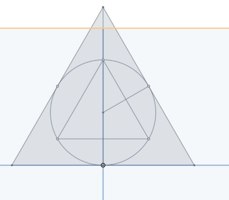

                    Maybe you find this one interesting too, I found it in a magazine some days ago, and to be honest I could not find the answer, except perhaps if I would unearth some long gone geometry formulas. But from the type of mag I suspect one should find the answer 'just by thinking hard' – if you know what I mean.
                    The question is: how much larger is the area of the outer triangle than the area of the small one.
                    The triangles are equilateral, should that not be clear
                    Ignore the yellow line, that's an artefact of my CAD drawing.

                      The small triangle is 1/4 the area of the large one I believe.
                      The circle contacts the large triangle at the midpoints of the lines, so the triangle formed by the contact points has sides half as long as the large triangle. The small triangle must be identical to the contact point triangle being formed in the same circle. Half the linear dimension gives 1/4 the area.

                        Hi, I could see how four of the small triangles would fit inside the large triangle, the give away is the four small circles and the line from the centre to the right hand side of the large triangle, therefore if you move the small one up to the top of the large one, you could flip it vertically and the top would touch the bottom of the large one, you can then get a small triangle in each of the bottom two corners of the large one, thus 1 / 4.
                        Regards Nick.

                          four
                          edit Beaten to it I see
