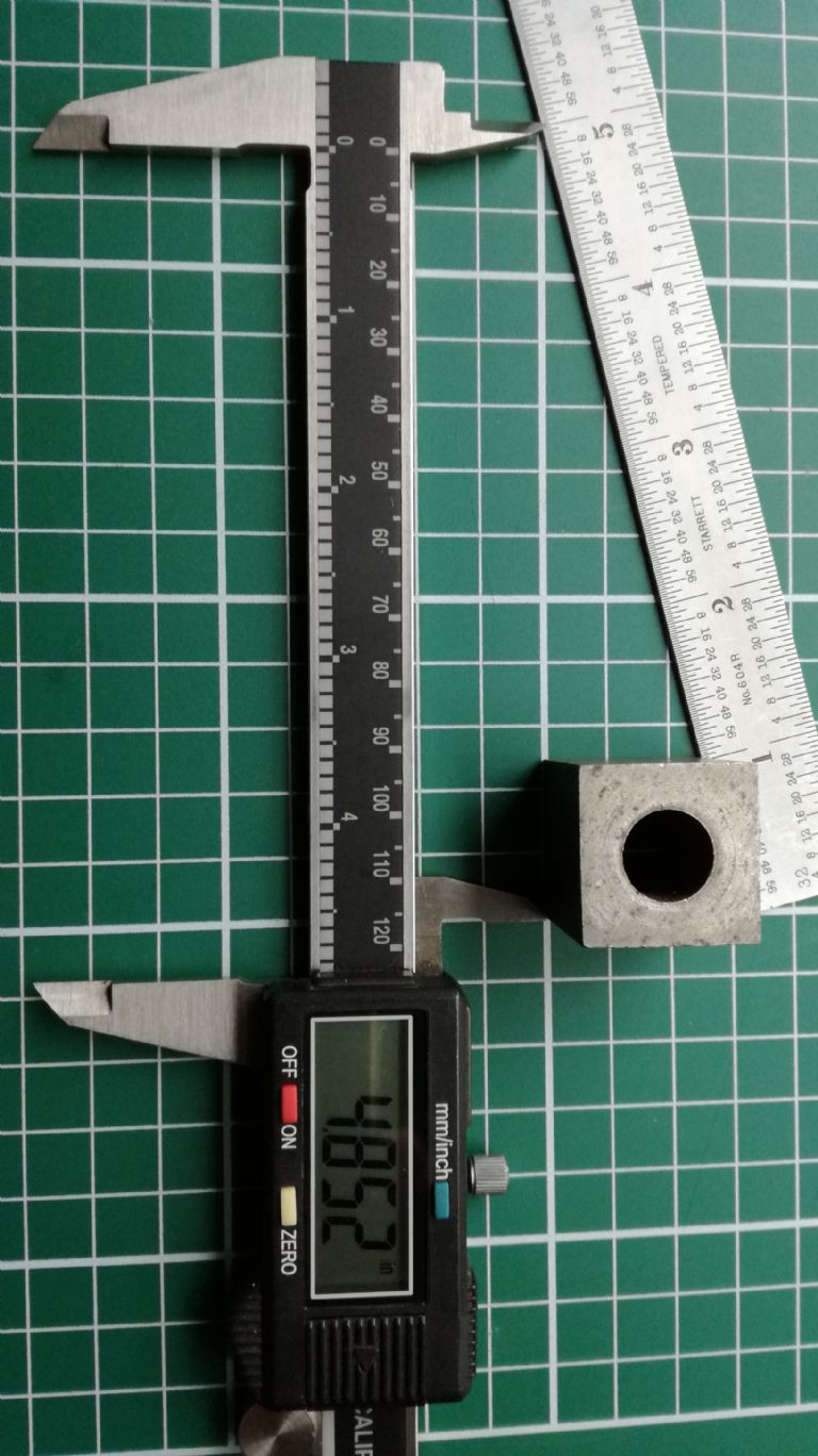

      Nicholas Farr
        @nicholasfarr14254
        Hi, while having a cuppa, I resolved the ladder problem by a different solution, and you could say being Model Engineering, I did to scale. devil The ratio of 10' and 2' is five, therefore 5" is equal to 10' and 1" is equal to 2'. Put that together and I came up with this.
        So being this is a scale of 1 / 24th, 24 x 4.852 = 116.448" then divide that by 12 and I get 9.704 Feet, now being that the wall is probably not square to the floor, I reckon I'm not Farr out. devildevil
        Regards Nick. smiley

        DMB
          @dmb
          Nick,
          I don't think so unless I'm missing something.
          The rule appears to touch the corner of the cube at the 1" mark, and the 5" mark touches the caliper point. 5 – 1 = 4. ??????

            Nicholas Farr
              @nicholasfarr14254
              Posted by DMB on 17/12/2021 15:07:42:
              Nick,
              Hi John, the corner of the cube was at 1 – 3/128" the best as I could tell, when I made the measurement, however I had to rotate the mat a quarter of a turn because the display was in the shadow and didn't show on the first photo I took, so the cube or the rule may have moved slightly. My attempt was a light hearted example, as the thread had "just for fun" in the title and my answer wasn't meant to be taken as the correct answer, but I don't think it is very far off.
              Regards Nick.

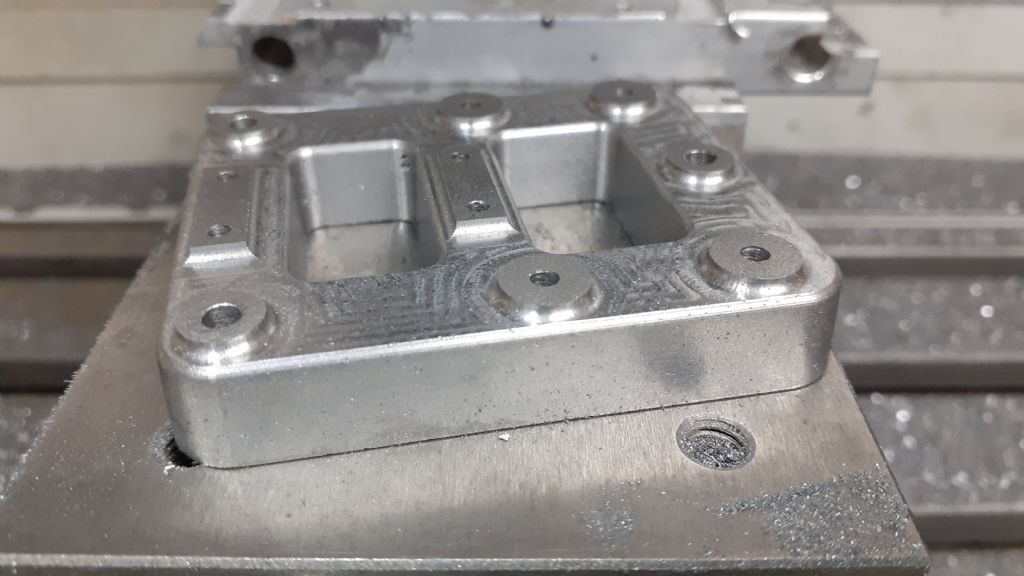

                                              Sorry, I've given up on the maths questions in favour of actually removing iron from a block Anyone want to calculate what's left here?
                                              #575901
                                              Nicholas Farr
                                                @nicholasfarr14254
                                                Hi JasonB, a lighter piece of iron. wink 2
                                                Regards Nick.
