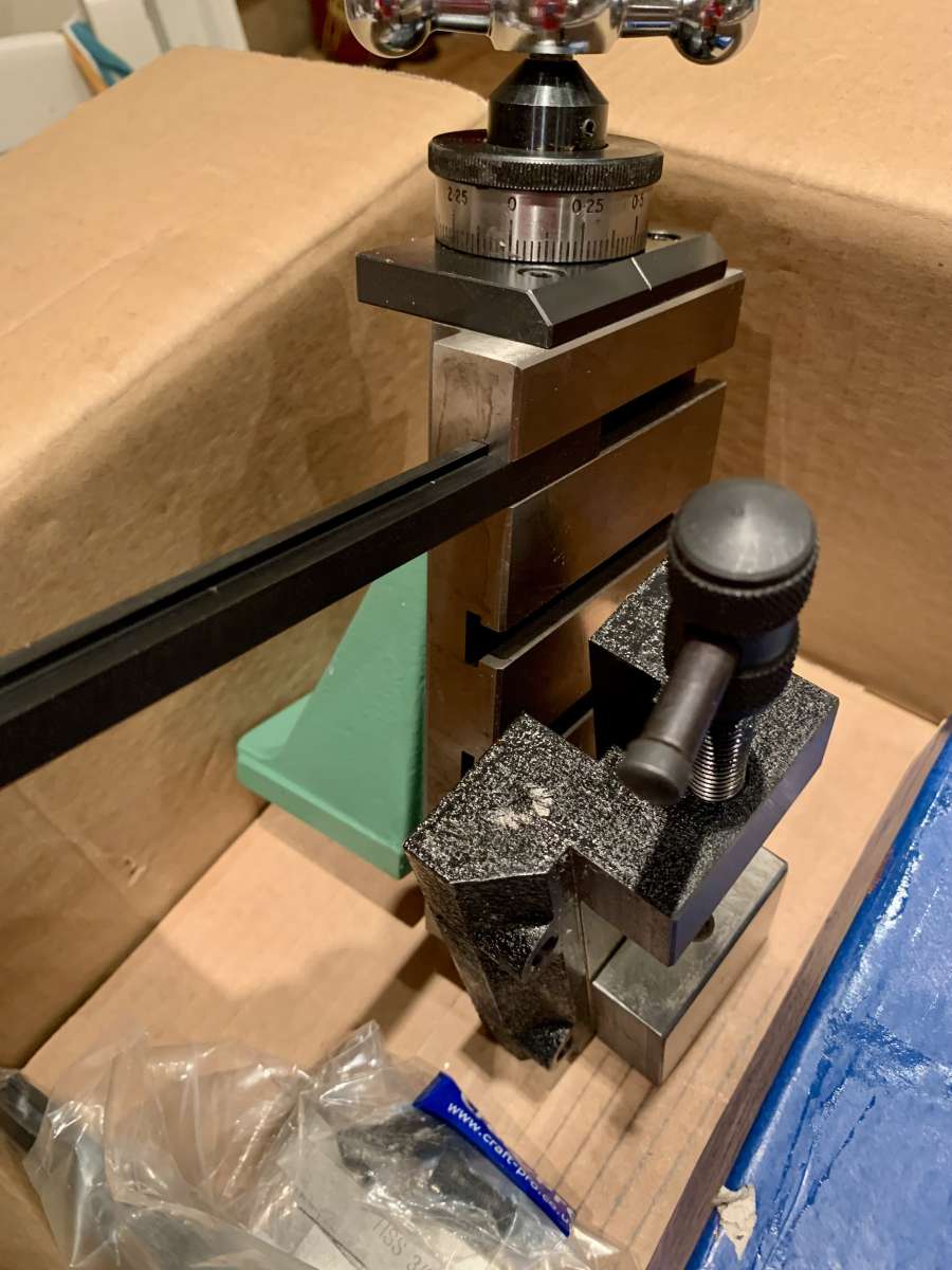

      Firstly my apologies -as a similar question has recently been asked… However, my application is slightly different & I am very much a newbie, so…
      I am running a Myford Super-7, and am upgrading the vertical-slide and vice to some newer more rigid items. I have bought some T-slot blanks, and would like to turn some studs to bolt the vice to the vertical-slide… As has been mentioned elsewhere I also have to hand some EN1A, which I can turn down to 7mm-dia to match the mounting holes in the vice, and then cut threads to attach to the T-slot blank & then use suitable nuts, washers, etc..
      So my question is will EN1A have sufficient tensile-strength in this application?? I accept that it would be fair easier to go out and buy some bolts/studs ‘off-the-shelf’, but the idea of manufacturing my own parts to suit has far more appeal.
      Many thanks in advance for any advice.

        Yes, go for it.  Though not a strong steel a 25mm diameter EN1A rod will support a weight of about 15 tons, plenty enough for studding on a lathe.
        I expect you know of the need to ensure the thread end of a t-nut should be dinged to stop studs jacking them?   If jacking happens the stud can break the lathe slots because cast-iron is weaker than EN1a.
        EN1A is unsuitable when safety matters.  Brakes and such need a higher safety factor, better corrosion resistance, and cut threads are relatively weak too.   As your lathe application isn’t safety critical, EN1a is OK.

          thank you for your reply… I am a newbie, so not sure what you mean by “the thread end of a t-nut should be dinged to stop studs jacking them”…
          Also, I am planning to run the T-slot ‘blank’ the full length of the slot (approx 4”) to spread the load a little… If you think this would help??

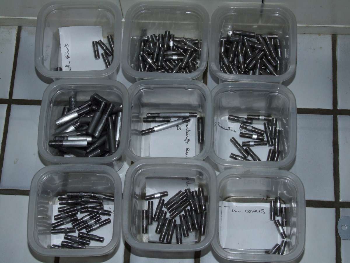

              I am using EN3B for all the studs on my scale traction engine, as it is commonly used on full size engines:
              2015_03250004
              It is much less prone to rust than EN1A.
              Julie

                  Having full length T nuts probably doesn’t spread the load much, but certainly makes for easier assembly.
                  Re. dinging the threads; consider the T nut this way up  ╩ with a threaded through hole, and slid into a T slot on the cross slide.
                  If you can screw a stud or bolt all the way through, such that it presses against the bottom of the T slot, then it’s possible to exert so much force that you break a lump of cast iron from the top of the T slot.
                  Personally, when the hole has bee threaded, I just invert the nut and use a wide punch to damage the end few threads of the threaded hole.
                  That way the stud has enough engagement, but doesn’t push the nut upwards when the vice isn’t present.
                  When tightening the normal hex nut onto the stud to bolt the vice or slide down, tightening hard is less of an issue, as you are pulling the ╩ nut upwards against the body of the vice, which supports the top of the slot.
